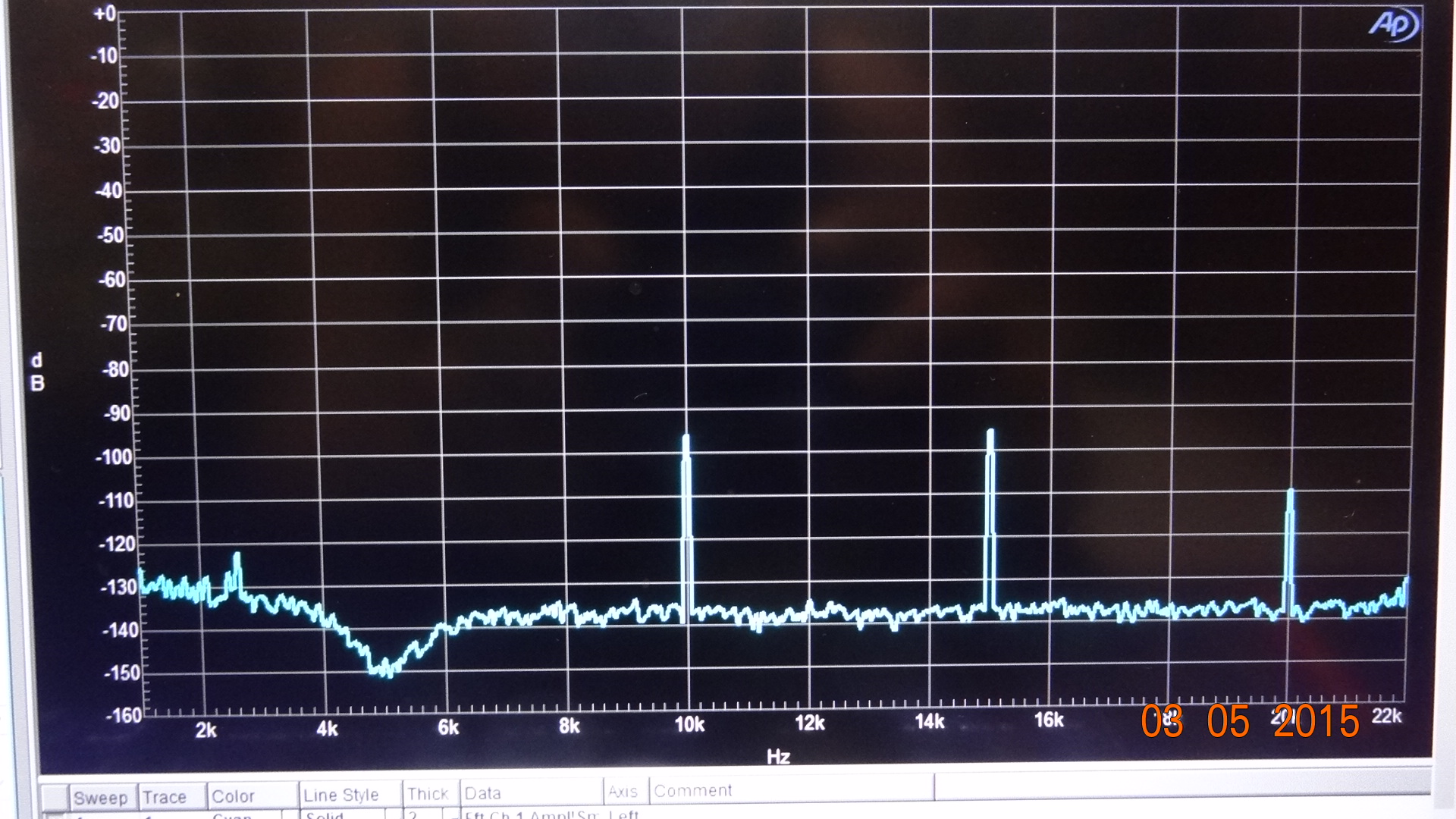

UCD THD+N vs Frequency at 40KHz Bandwidth, plot is valid up to 15KHz.
Now can we stop this Class D can't do more than 6KHz bull or it hides snakes over 6K you need pre analyser AES17 (20K or 40K) filter to stop AP from overscaling not because Class D has killer snakes above 20KHz, besides you can't measure correctly nCore (0.00045 THD+N at 6W) with more than 20KHz Bandwidth, the analyser is 0.0004 THD+N at 80KHz and 0.0002 THD+N at 20KHz.
Except in the datasheets for the ncore you can clearly see the sharp rise in distortion vs frequency that is curtailed rapidly beyond 6.7k due to the measurement bandwidth limitation impacting on its ability to resolve the third harmonic.
Some amplifiers are obviously affected by this far more than others. The ncore is specifically because its midband distortion is so amazingly low. If it wasn't then the rise would be pretty much invisible as it would be swamped out by other forms of non linearity elsewhere within the amplifier.

This is Distortion at 100W/8 at 5KHz = .0024% THD of my 200W CFA mosfet amp. The GNFB is about 80 dB from 0 to 20 kHz and it sounds nice according to Richard Marsh http://www.diyaudio.com/forums/solid-state/243481-200w-mosfet-cfa-amp-80.html#post4355552
Well .. it is because noise starts to dominate when using 80KHz Bandwidth.
