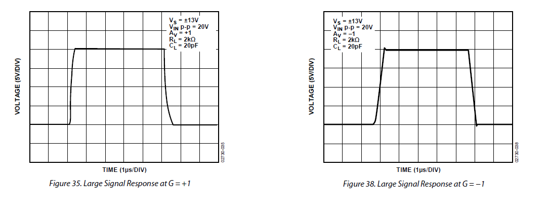

Single gain stage, no multi feedback gain stages....
If we talk voltage feedback it is the inverted configuration with virtuel ground on the noninverted input. For many designs the Jfet input stage is an keeper because of the very low leakage and non existing current noise making it a good choice in high impedance circuits... >5K source impedance.
But the JFET has a highly Vgd depended Crss (Miller capacity). By using it in inverting configuration the voltage across Vgd becomes more or less static.. And you can hear it, regardless of feedback value.
If it is non inverting i will bet on Current feedback as long as we do not talk filters.

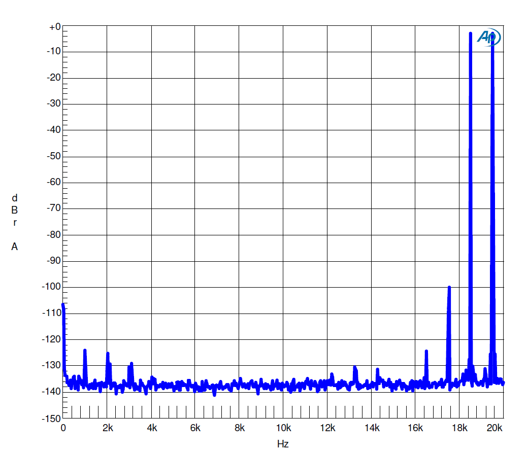

The amount of nonsense in this thread is just WOW!
"Many class D design go for high power... But most likely the S/N ratio is worse than a good designed class A/AB"
--NC1200 module 28 microvolts 20khz bandwidth -103db at 2.8V unweighted that is state of the art performance better almost any Class AB amp on the market (UCD700LZ OEM 35 microvolts 20Khz unweighted)
"Free running class D designs will produce EMI (This is also the case for unshielded SMPS) that will be mixed between the channels and will be seen in the audible range as moving artifacts"
--EMI happens in from bad board design problem that was solved in 2004 you can test any UCD board this is not rocket science all you need is a analog scope if you wanna go fancy you can use RF test gear no problem you not gonna find EMI problems.
"Inductors in the output stage produces a lot EMI, also the inductors are coupling induviduelly"
--This is just plain stupid....
"If they are not shielded they will inter-fer with other circuits producing artifacts that we can hear in the speakers."
--Artifacts are a product of a bad design you can not shield EMI problem it comes out the speaker wire
"Filters for measuring class D is to prevent the switch frequency beating the ADC in the measurement equipment. 300KHz on a 182KSamples DAC is not good for the nyquest theory...."
--Complete nonsense AP 2700 uses Cirrus Logic chip that samples at 6MHz and uses digital filtering, the problem with 2700 is that the input signal triggers the range detector in the analog domain then it goes to the ADC and modern Class D switch at 350khz filtered by second order filter with cutoff at 35khz residual is 40db down on fundamental and 3rd harmonic will be 29db down from the fundamental so the switching residual looks like sine wave with 350 milivolts at 350khz, so if you test THD+N at 300 milivolt sinewave the AP see 300+350milivolts and activate the 600milivolt range on the scale so you always get the wrong numbers on the THD scale that is why you need to activate AES17 pre analyser filter to reduce that 350milivolt residual so you can get real numbers on the scale
5th element "Except in the datasheets for the ncore you can clearly see the sharp rise in distortion vs frequency that is curtailed rapidly beyond 6.7k due to the measurement bandwidth limitation impacting on its ability to resolve the third harmonic."
Ncore design has loop gain of 53db up to 6khz then goes up to 65db (pole) at 15khz then back to 53db at 20Khz when driven hard distortion around 6-10KHz climb a little but then it drops down around 20Khz and it stays low until 40Khz then is climbs up to 70khz but in a lesser manner than any Pass Labs Krell or whatever you clame to be superior and it hovers in a low feedback mode up to 200khz it does not fall apart at ultrasonics and it does not intermods into the audio band you can see from the IMD plot.
..THD+N vs Hz - Blue 2W(Thermal) , 20W Green , 200W red--4Ohm 20Khz band
..IMD 50w and 50w peak 200 W Sine 4Ohm
I did not write all, Hypex is in general very good, but still for monitoring purpose in studios one of my customers changed from hypex UCD400 to my design and ended up with less audible noise from the speakers
All CE test is most likely to be done in a shielded box to get them through the tests. I have measurement equipment here for the purpose
--This is just plain stupid.... No it is not, again use an H-field probe. Also if you do an sweep up to 30MHz, you will clearly see the switch frequency and its harmonics.
No i am not talking speaker wires here my friend, but class D has very high dv/dt values, and to save money many designs is only a 2 layer pcb. I know that IRF reference designs are two layer, but they have massive ground copper layers. But still you have the EMI which could be lowered a lot by using 4 layer and use the layers as shields.
