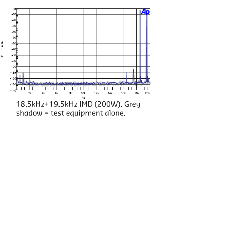

Jan, with respect, I did not expect this kind of post - especially since in the very next one you complain about folklore. I know it's toungue in cheek somewhat but it's really not fair to complain about generalization if you have just done it - especially preceeded by some sort of 'ad hominem' attack on 'people who live in tube/SS land'. ANY??? tube amp, ANY??? SS amp? This is not engineer speak, but exactly what you complain about, folklore.
And, while at the point of folklore, measurements and class D - the class D 19.5/18.5k IMD graph WILL create folklore precisely because it again shows up to 20k bandwidth. I don't doubt that the exemplary results show also over 20k, and it's not as if AP can't do more than 20k, so fercryingoutloud USE IT and prevent folklore being created once and for all.

As to measurement bandwidth - yes the AP can do much better. But if you look at published measurements they are almost exclusively limited to 20k, independent of the class of amp. So why all of a sudden demand that for class D we measure out to, what, 100k?
We don't do that for DACs (they can have LOTS of noise from noise shaping above 20k of course); we don't do it for our streamers.
Well, exactly to shut up the naysayers. In fact, you can reverse their arguments on them, by asking for THEIR 40k or 80k bandwidth plots. Otherwise, when it's not on the plot, people can, and will and indeed, have, put their favorite misconception there and use it against you.

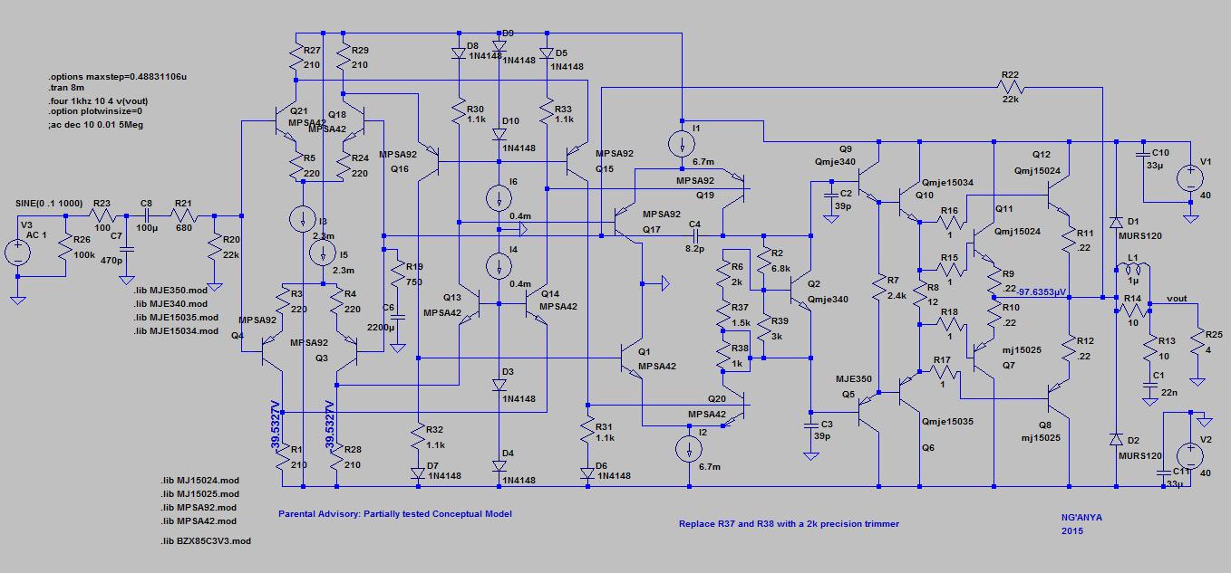

Let me guess.... It's a simulated amplifier.
Its a simulated amplifier based on some theory and now under test based on pirate rules 😉 (some form of audio signature)
