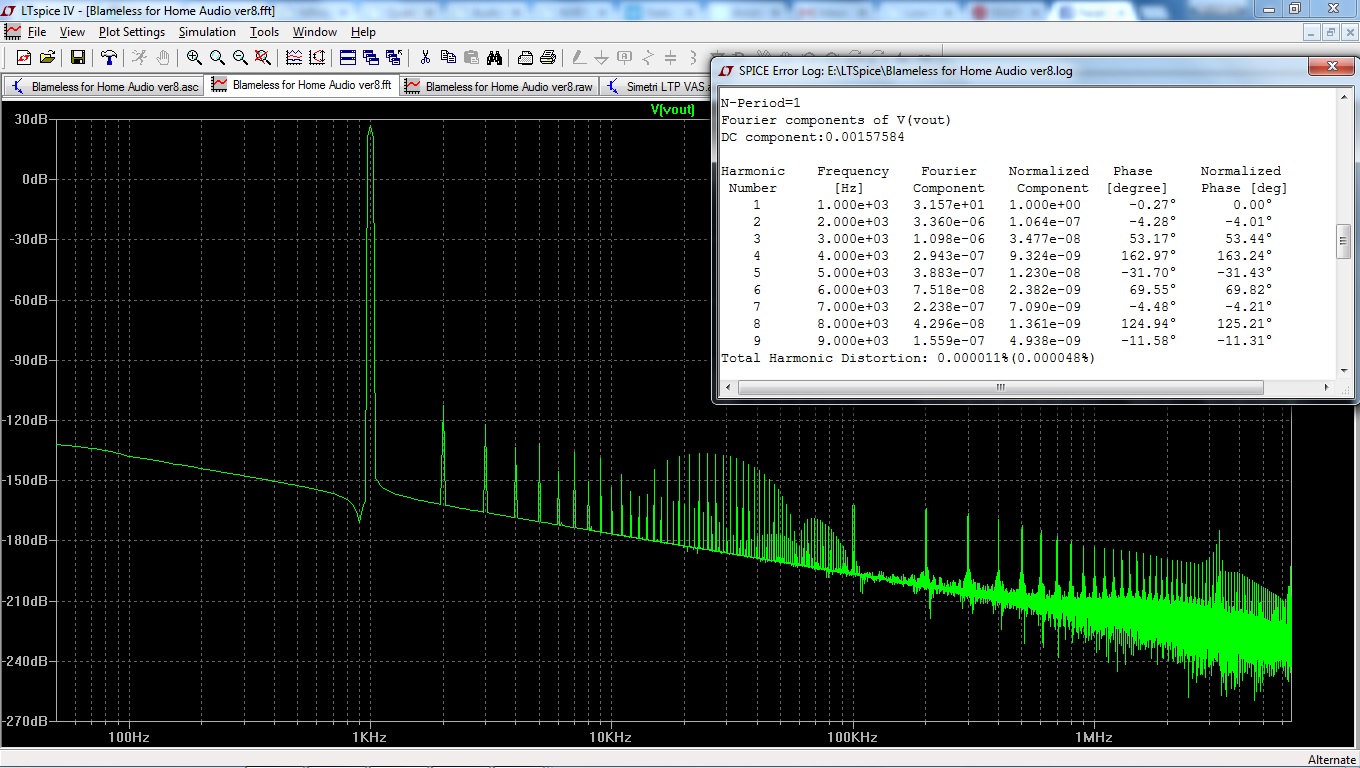

This Bimo chart shows to us unfiltered THD components mesurements of some very good A/B class amp up to ~ 6.5Mhz range ,
I wonder how is possible in the present modern 21 century that some class D amp can not be measured excited at full power to show us Unfiltered both THD components results and RF switching carrier components results up to same ~6,5 Mhz range or even wider ??? ,
but Only filtered results up to 20 Khz ?
but Only filtered results up to 20 Khz ?![]()
This can only be done (IMO) using fixed frequency Class D amplifiers. However these are often nowhere near the THD performance levels of a standard class A/B.
You do have a filter on the "THD measurement", you have a 9kHz BW as far as I can tell.
This is a SIMULATION. You can do ANYTHING in simulation, measure your class D till 10GHz if you want. 😉
