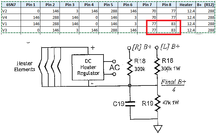

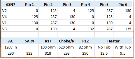

Seem like my measurement is nothing near yours, the table below is where I checked voltage at each pin. How did you get 6.xx?

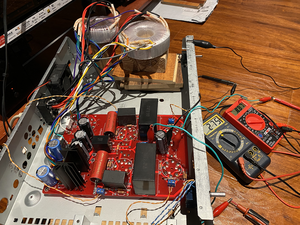

Does your chassis is aluminum? Steel got hum. When I put the toroidal on top the wood, the hum went away.
My outlet currently between 120v and usually drop up to 115v so I have 290vDC at 120vAC so it's right at 280vdc when drops. I will order the choke later since it's working fine. Hope the choke will improve more.
Check the manual again on page 6 and 8, it does say R18 is 300k, not 300r. Why it didn't happen to you, I am not sure but my filament shut down in 5 mins with 300r that got spark and blew off parts on PS. For safety, you may want to replace to 300k on R18.
Another issue is filament, without tubes is 12.5vdc, however; when inserted the tubes, it drops to 9.5vdc constant. Have you checked to see if it's at 12vdc and what values you have for both of them? I am setting 12v where R20: 1.07k and R21: 124r. I tried R20 @ 1.5k or R21 @ 100r but it didn't do anything. Look like his formula is wrong too, it's support to be R20/R21 but he has R21/R20 ...lol...What a crazy manual.
My input/out grounds are separated, only connect the IEC ground to the House GND on PCB.
What kind of input selector you use?
My chassis is Mild Steel and Aluminium top plate. The transformer shield is tied to the mounting bolt and I run a wire from there to the GND on the board. The green wire on the right is the star ground. Hope that helps.

So far I got the hum down to 1 channel and heater filament fixed because of wrong jumpers. It's stable at 12.4v.
I am using R18 and R19 as in the image. Do you have the same value? As he mentioned around 75v at B+ 300v but somehow my V1 and V3 seem high so I think the hum may cause by high cathode voltage. All voltages are almost identical except cathode voltages on pin 7 and 8. I am not sure how to balance these voltage since they're shared the filament which they should be divide equally. Swapped tubes around still have the same problem. Other than that, I really can't think what cause the hum.

I using 300R for R18 and 47K for R19 though. Not sure how I got that value different but think I asked the forum here. I'll check the resistors on the board.
That's the voltage divider section. Most of his designs are using 300k for R18 and 47k or 100k for R19. If you use 300r, the voltage at pin 7 and 8 are around 600v according to the formula.
By the way, I got the hum figure out.
1. Wrong jumpers for 6.3v, that's why DC with load at 9.5v
2. One of the cathode resistor burned out may cause by the problem above.
3. All voltages are the same now except the cathode voltage at V1 and V3 are about 3-5v higher than V2 and V4. Even thought all the component values are the same. B+ is stable at 290v
4. Steel chassis hum with toroidal
