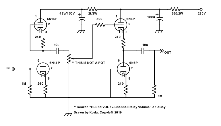

My solution is this:
I use one of these:Hi-End VOL / 2-Channel Relay Volume Control Board /Stereo volume board | eBay
I've tested it, and it's lowest Rin was about 1k or so. '
Here's the circuit:
I should say I've replaced the pot they give you with one of these... 1Pcs WXD3-13-2W 22K 220R Multiturn Trimming Potentiometer Variable Resistor | eBay
Here's the circuit:
It seems it uses a pot plus ADC combination to control the relays. Do you experience the issue sometimes mentioned in connection with that arrangement, where the LSB of the ADC in certain pot positions is not stable and flickers between 0 and 1, so the respective relay keeps clicking even though the pot is not being turned?My solution is this:

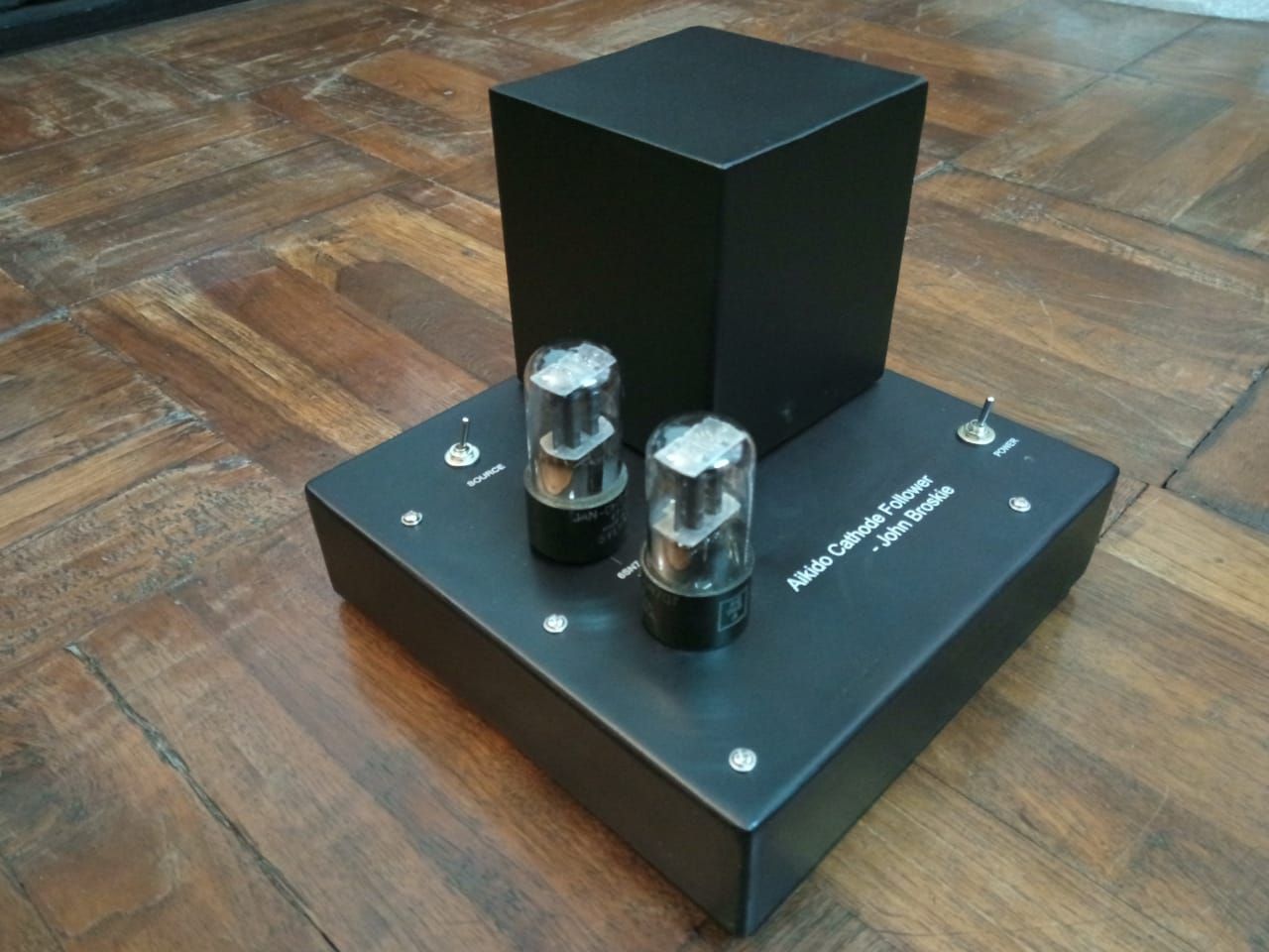

Hi, the ACF-2 is done. Here's a pic of the cabinet that is w.i.p.
Is it fine to print John's name on the top plate ? Any problems with copyright ?
Please help answer.
