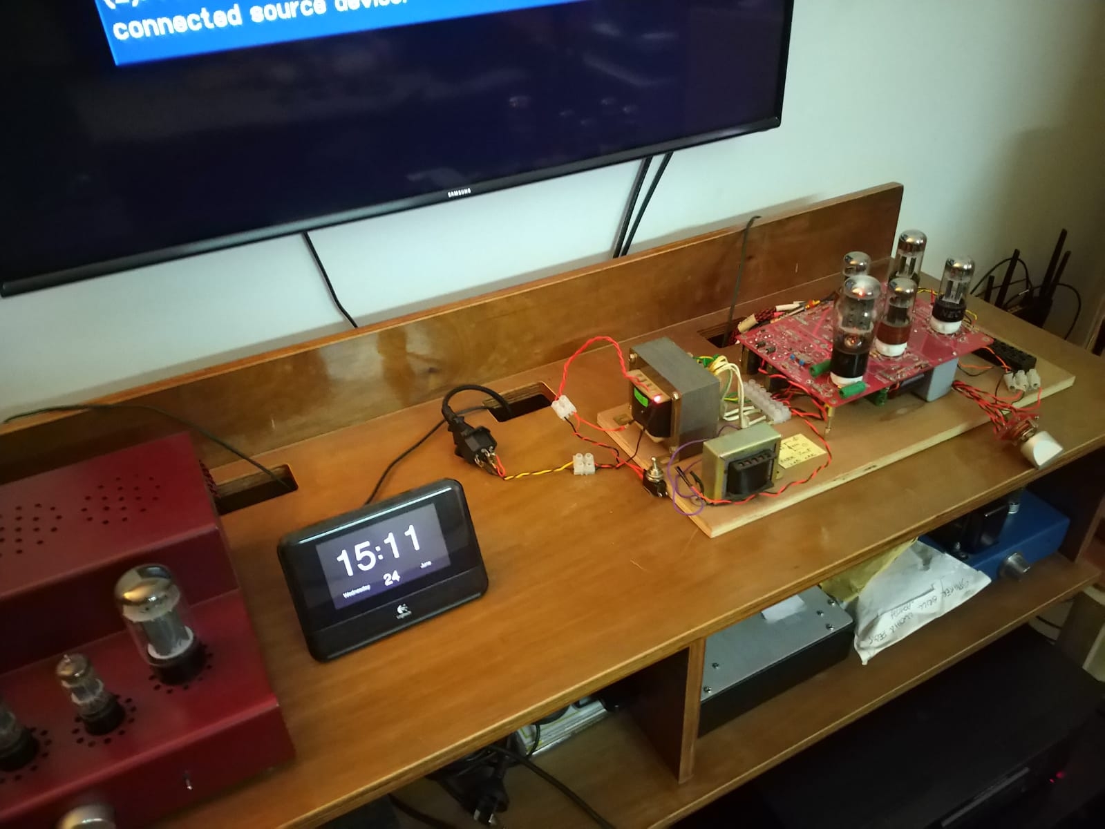

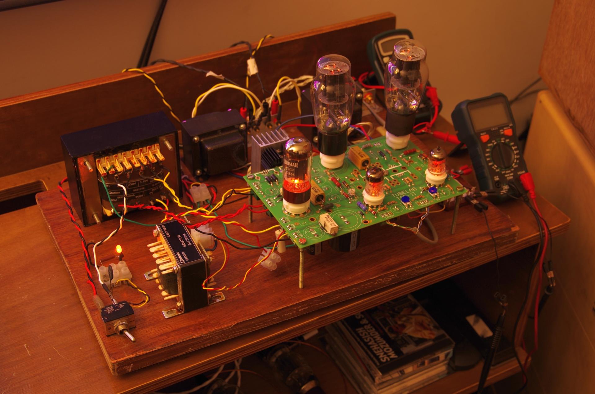

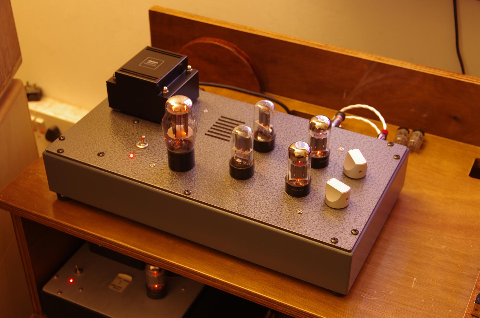

Aikido Octal in a chassis finally !
Fired this up last year on a bare board. Finally got the chassis delivered in July. Up last Sunday.
Sounds just the same, ridiculous. Its been running a 300b (Tubelab) till now whose sound I really like.
I fired up a Tubelab 2A3 today and its got new company :)

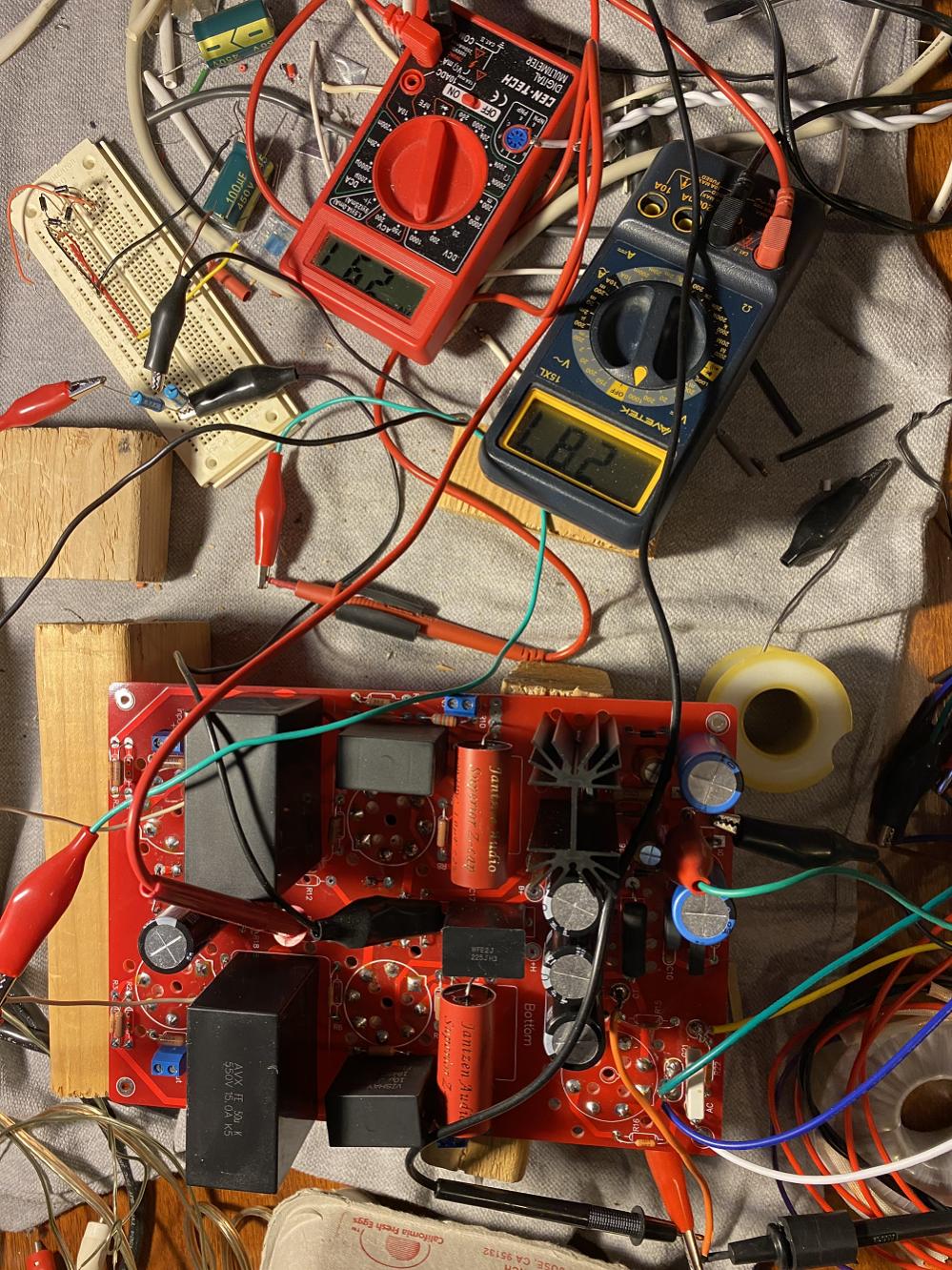

Great. I am working on the old box of satellite chassis so it will be less drilling. Anyway, I couldn't wait so took a few hours last night to to figure out.
It's depend on the PT, mine is 280AC@90mA so before R12 is 390vdc without load. 78vdc drop needs for 4 tubes. R12 at 130r is 285v so I decide to use 100r/3w for around 287v since I have many around. Whatever value in the table is hard to predict until you try couple to find out. I ordered 1k, 2k, 3k, didn't realize it ended up around 100r-130r ...lol... I think between 280v-300v is good. Doe it sound like $5k like someone mention? :) I am gonna hook up later to see what the sound like.
Another stupid issue is tube sockets. It's hard to push down other brands such as OTK 6n8s except Tung-Sol 6SN7. That's the max I can push it down. When I compared the pins between Tung-Sol, it's a little bit bigger than Tung-Sol.
