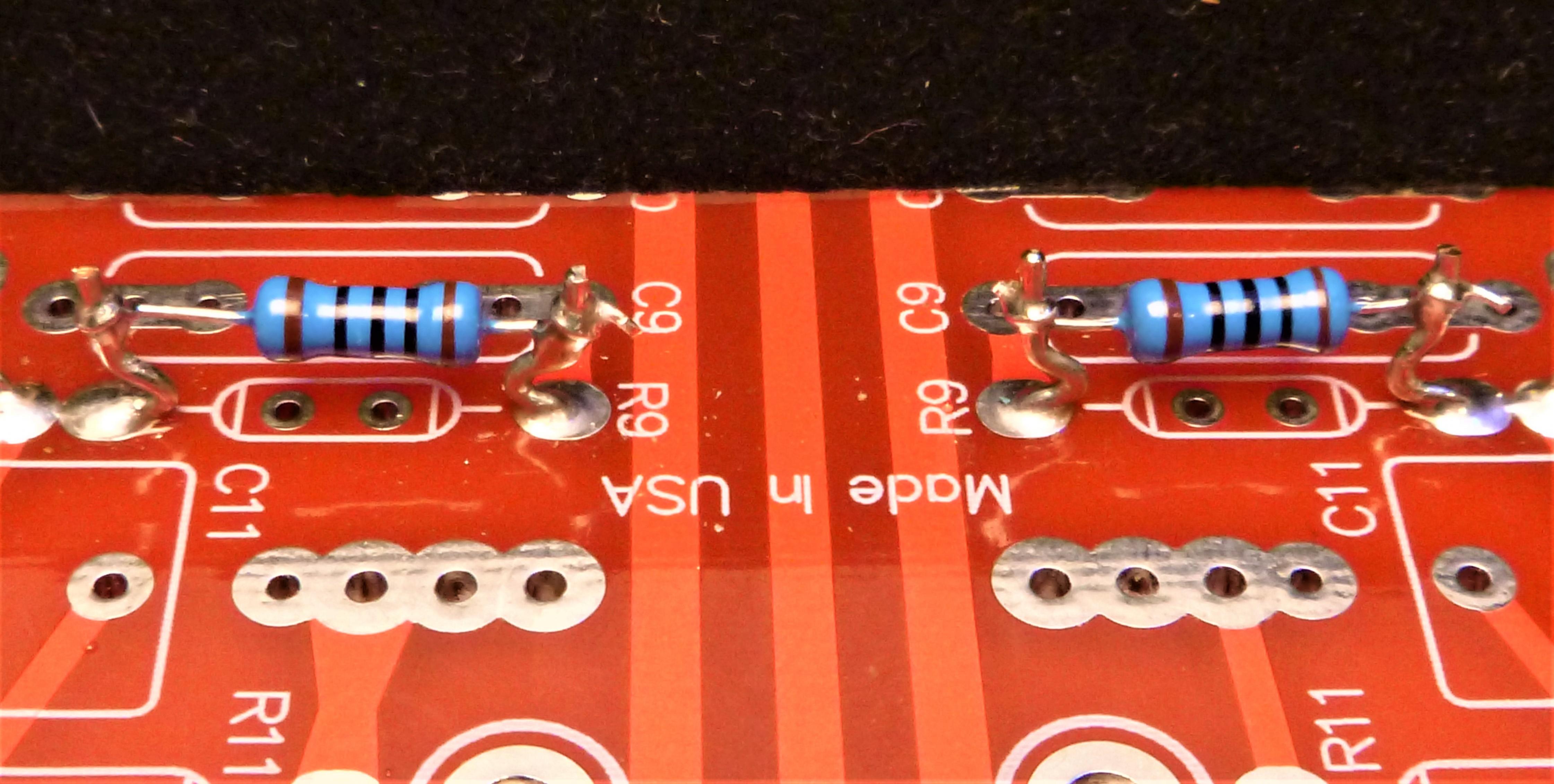

The Broskie boards being very thick, makes it difficult to remove parts once installed. See picture, you might want to try this trick with the O/P caps that I used on Tetra phono board resistors. Just in case you want to change them out for larger ones later.
Steve

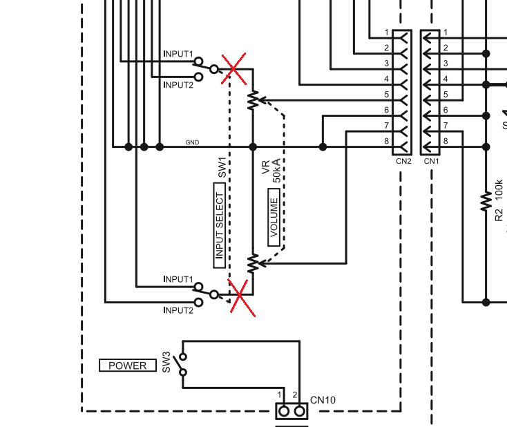

Would 0.22uF be ok here. Not planning on any more SS, maybe a few more tube projects.
The Elekit amps are in essence power amps with a volume control at the input. Their gain is usually quite high so they can be used directly with a high level source. If you have the situation where you are using them at the bottom of the volume pot range then by inserting a resistor shown at the red X on the attachment you can get a more useful range on the volume pot and increase the input impedance.
Ok, got it. The Elekit has worked well so far with various preamps, the vol. at 12 'o clock.
Should I just go with 1uf. Damn, this is hard to decide...
John B has a note on how to decide this. Going with 50k input imp. and a corner frequency of 3.18hz, 1uF will be fine.
