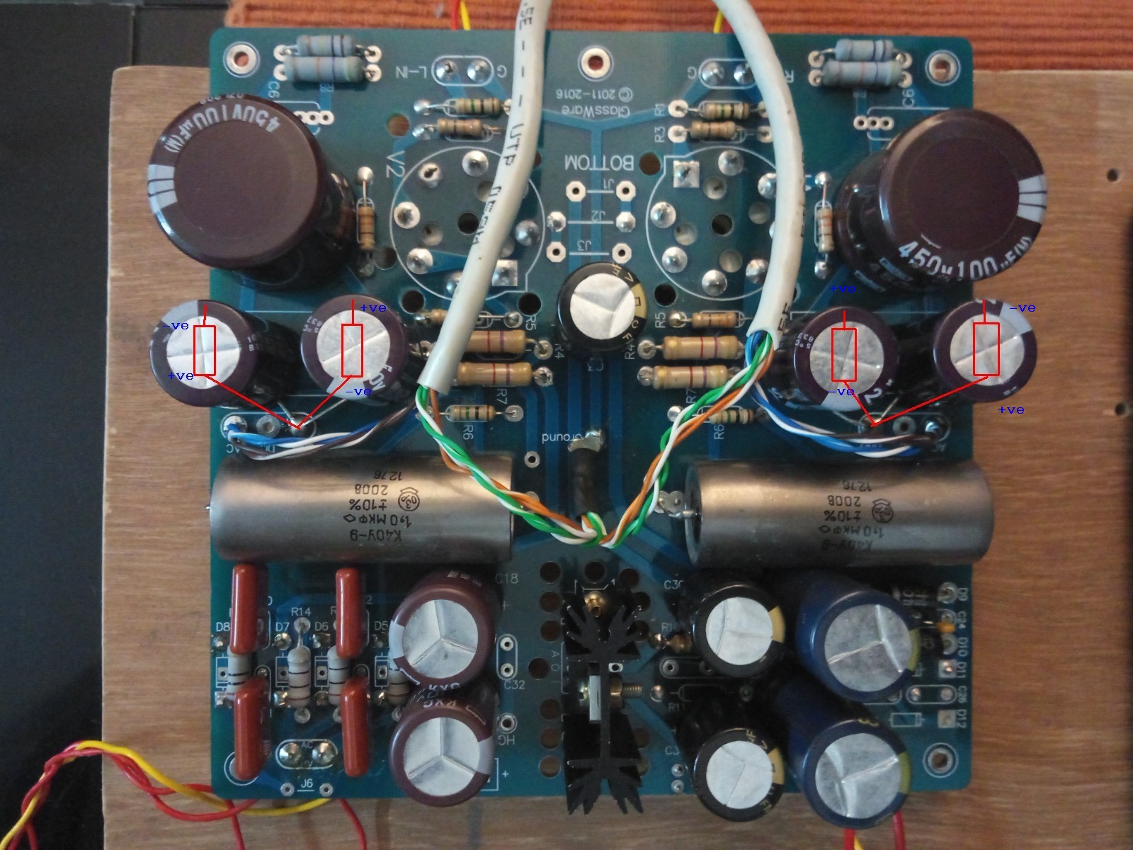

Can somebody please help answer this. The extra cap pair to sort the buzz problem, would 220uF do ?
I've installed the pair of 220uF caps at C4. Have a new problem though - R7 gets really hot. One of them started to turn brown. Thinking it could be a faulty part I replaced with a new R, same problem.

Yes, that is the way to connect the two caps.
Thanks to Sunil, I just realized that the connection shown in post #74 above is wrong - sorry I did not notice it the first time. The cap connected between the ground and R7 - that's the left cap on the photo in post #74 and the one close to the board's edge in sunil's post above, should be reversed, as R7 is the negative rail. Connected as shown, the cap may short the negative rail, burn R7, and possibly explode.
It works. Got a new set of caps and wired them the right way around.
It is quiet. I'm running very efficient Altecs and there is absolutely no HUM, compared to earlier, without the twin-cap mod.

Hi Sunil could please post the closer pics and the capacitors values used.
Me too want to try with my Akido octal buffer.

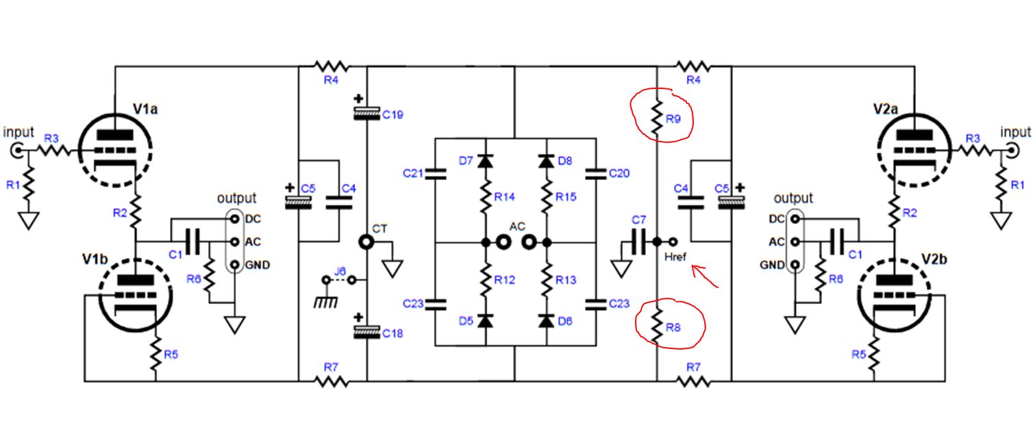

The ACF -2 circuit “Aikido” feature relies on the ground referenced hum from the positive power supply rail cancel that from the negative supply rails - see the attached picture (from JB) and the complete discussion at tubecad.com. I find the idea quite elegant in its simplicity.
However, in practice the hum from one rail does not cancel that from the other rail. This may happen because of, for example, tolerances of C18/19 or the power transformer’s secondary windings.
The suggested remedy is to further filter each rail with an ground referenced RC filter instead of the differential R4/R7/C4/C5. It is convenient on JB’s PCB to split C4 and ground the middle point. Each cap (let’s call them C4A and C4B) forms an RC filter with R4 or R7, respectively, and attenuates hum on its rail. The value of each cap defines the time constant of the filter and thus the attenuation. The more capacitance, the more hum is attenuated. Small caps will work, too. They will not be as effective, but may be effective enough for your purpose. There are also practical limits on how big a cap you can fit on the PCB.

One way to think about an RC filter is to realize it is a voltage divider. As the capacitor has lower impedance at higher frequencies, the attenuation of such a divider depends on frequency.
Let’s say we split C4 in two caps, with C4A connected between the positive rail and the ground, and C4B - between the negative rail and the ground. In the case of the positive rail, the divider is then formed by R4 and C4A. You can look up the relevant math online, but the result is that the attenuation of such a divider equals sqrt(1+(2*pi*freq*R*C)^2) - that is, the higher the frequency, the higher is the attenuation. The attenuation is also proportional to C - the more capacitance you have, the higher is the attenuation at any given frequency.
Say we have R=6.8kOhm and C=220uF. Our frequency of interest is 120Hz. The attenuation then is sqrt(1+(2*pi*120*6800*0.00022)^2) = 1128, if my math is correct. So the RC filter with the above values reduces 120Hz hum by a factor of roughly 1000, or by 60dB, so 1mV of hum becomes 1uV. C=470uF will bring it to 2000, while C=22uF - to 100.
Obviously the rail noise is not the only source of noise in your system, so you don’t want to keep filtering your rails to infinity. At some point other sources will dominate, so the return on extra capacitance will be diminishing. That would probably be your optimal capacitance.
In practice, however, 60dB sounds like an improvement, especially if you have handy those 220uF caps, rated for correct voltage.

Hi everyone
please, what are the values of R8/R9 in the ACF-2 schematic? Tube are 12AU7.
In ACF-2 manual this values are not indicated.
Besides also where it should be connected the Href?
See Image attached.
Sorry, but it's my first tube application😱

Href is the filament supply reference. Connect the filament supply negative (DC) here. R 8 and R9 are not that critical. Try about 200K to 300K, 1 watt. Both should be the same value.

Er, not quite. The idea is to put the heater at the potential within the tube's acceptable heater-to-cathode voltage range. Since the bottom triodes on the schematic operate with their cathodes close to B-, and the top ones - with cathodes close to the ground potential, the usual approach would be to place the heater somewhere around half of B- (the exact value is not critical). To quote JB:
If you make R8 and R9 equal, the heater will be halfway between B+ and B-, that is, at ground potential, and you risk exceeding the maximum heater-to-cathode rating. That said, some manufacturers put the rating at 200V of any polarity, so ground potential for the heater may be ok. In this case, you wouldn't need C7, R8 and R9 - just short C7 and connect the negative side of the heater directly to the ground.
The resistors' values should be large (100s of kOhms) to keep the current through them, and their power dissipation, low. For example, R8 can be 100kOhm and R9 - 300kOhm. Or 300kOhm and 910kOhm.Since one triode stands atop another, the heater-to-cathode voltage experienced differs between triodes. The safest path is to reference the heater power supply to a voltage equal to one half the B- voltage; for example, -50V, when using a +/-100V power supply. This voltage ensures that both top and bottom triodes see the same magnitude of heater-to-cathode voltage. Resistors R8 & R9 establish this voltage relationship.
