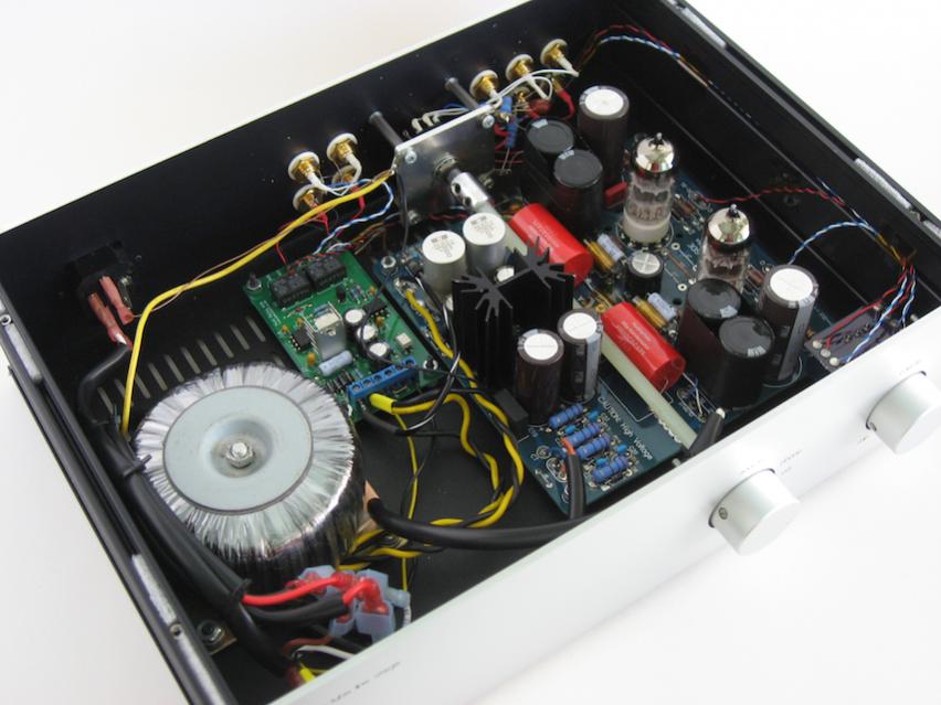

This is how the board with the two extra caps (per channel) looks in real life. Additional photos are in my blog post.

Joined 2009

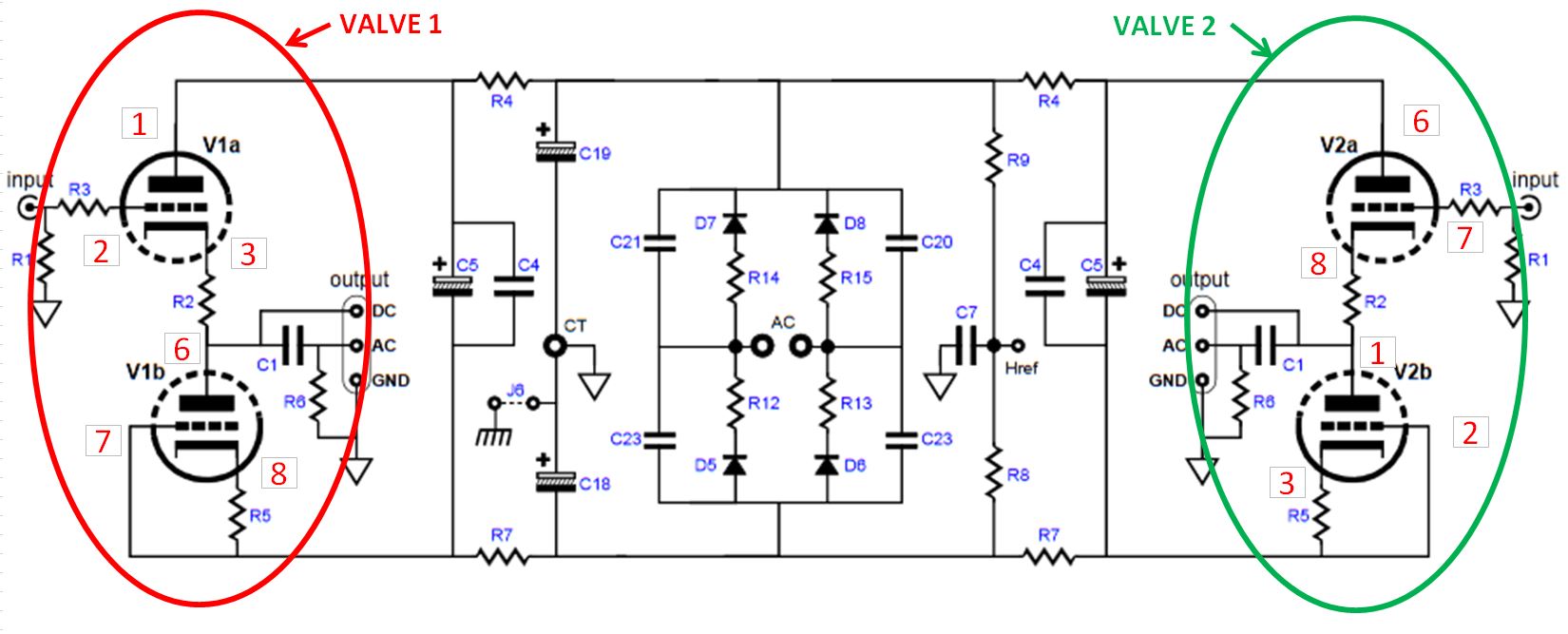

The muting relay shorts the output RCAs when powered off and un-shorts them in a few seconds after power-on, thus protecting the power amp from preamp transients. In the power amp, a muting relay protects speakers from the transients of the power amp. Generally, you need both, but in the specific case of ACF, having the muting relay in the preamp is probably not critical.
My transformer runs at 130-0-130VAC with ~160V or so rails after the rectifier. You can probably use a 115-0-115VAC secondary, adjusting R4, R7, and R12-R15 to get the right voltages for the triodes.

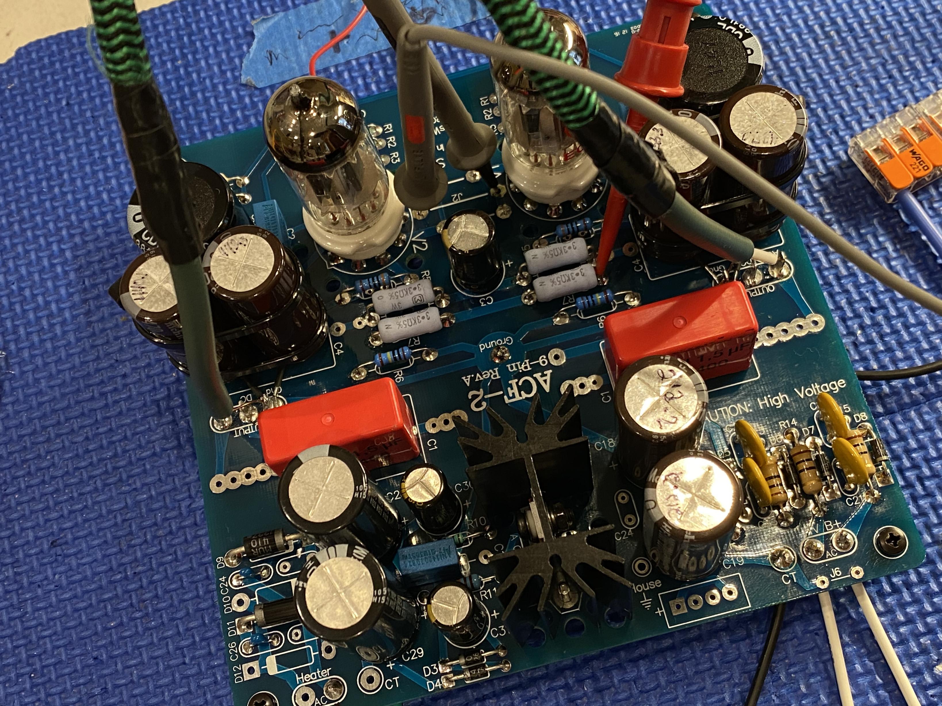

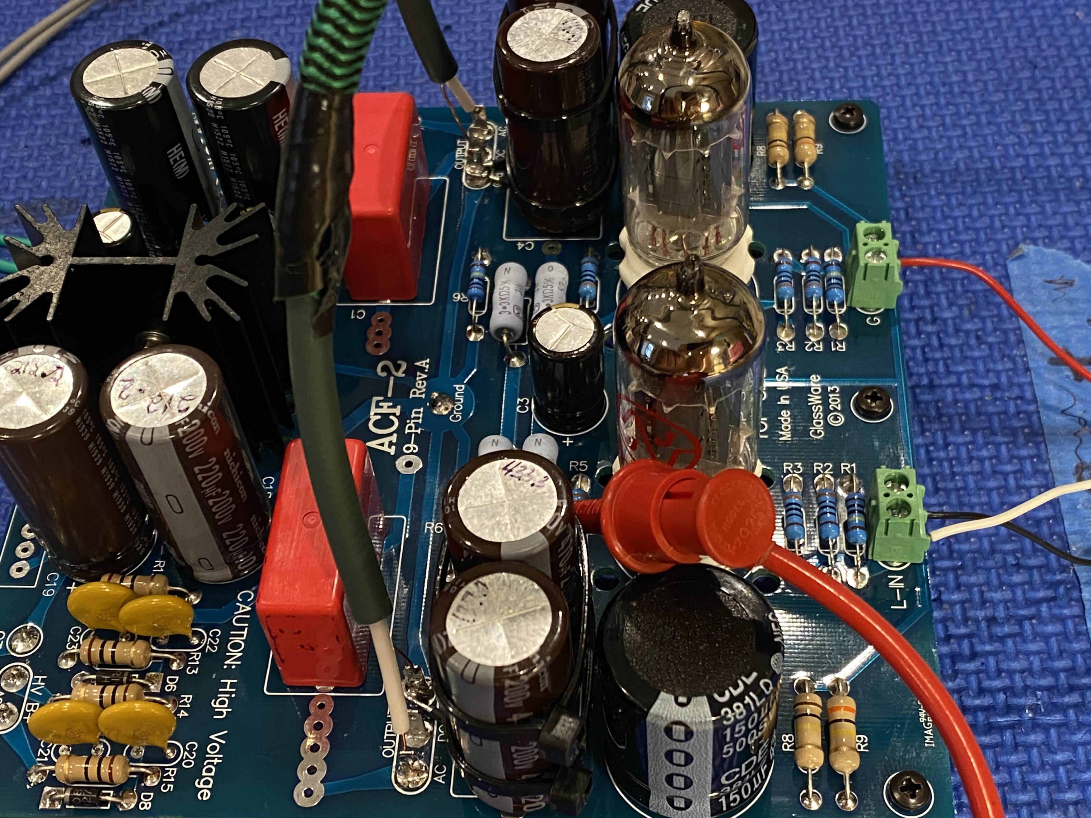

Hello Fellas,
I recently picked up an ACF-2 9-pin board from the swap meet and then came across this thread before I started assembling it. I also noticed there are a few discrepancies between the build guide and the actual pcb, no mention of C2, C6, C7, C24 and 4-leg bridge rectifier???
I want to say Thank You to all of you that contributed to ironing out the details to get this board working hum free. I went ahead and implemented the mods right from the beginning. I’m using a pair of 470uF, 200v electrolytic caps at C4 and matched the capacitors for C18/C19, R4/R7 are 3K3 ohm resistors. Heater and B+ voltages are within specs.
Just applied a signal using an iPhone as a source and I’m happy to say the ACF-2 is extremely quiet, I can’t hear any hum/noise with my ear right up to the front of my 84dB test speakers.
Since this board has turned out better than expected, I will get this into a chassis with selection and volume control.
Thank you All!!
