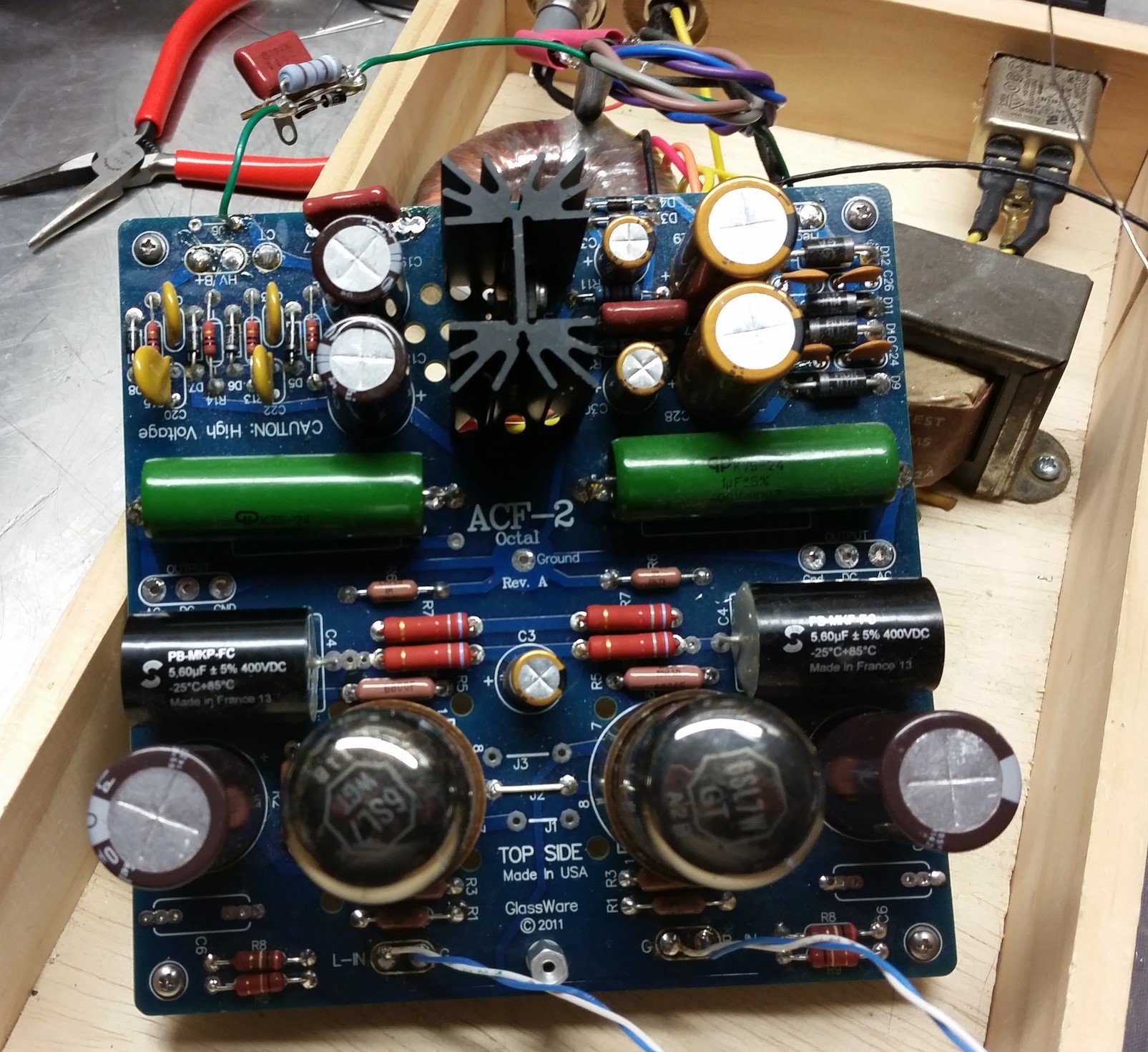

I've attached a picture of the board that I am using for reference.
Any recommendations on testing the PSU circuits for oscillation?
That’s interesting. You have the v1 board, I have the v2 board. I have spotted some differences. Namely, I don’t have a C7 on the board... that’s where the pesky rectifier sits. At the same time, we both have a C17 that’s not present on the schematic. Either way, we have the same problem, which is extremely interesting.

@nautibuoy if you can snap some pics of the PCB with as little parts on it as possible, that would be helpful. I’d try to trace some tracks, as it seems there are slight deviations from the schematic. Thanks!
I’ll have a better look tomorrow, when I’m fresh. I’m thinking about ordering a cheapo oscilloscope from ebay. Found some decent ones for 25 bucks... they may not be professional quality, but I think I can get some value out of it for home use.
Sorry, I've almost finished assembling my ACF-2 PCB. My board is Rev. B, which includes the "pesky rectifier" and associated cap C32. (I don't see the rectifier as pesky, it is just providing you with an on-PCB option for coupling ACF-2 ground to chassis ground.)
I am planning to use NOS 6SN7 tubes, configured as per the 'typical part values' on page 5 of the manual. Filament supply is configured as full-wave bridge and will be running at 12.6V.
Do you have the mains 'ground' (earth) connected as well to the chassis? If so, remove it, might be a ground loop through that..
Ah, damn. Oh well. My problem with the rectifier is that it seems to have a connection to C19+ instead of - (which would be CT/circuit ground). I can’t tell exactly though, as the tracks are covered by parts. If I’m mistaken, it’s all good.

I suspect this is a grounding issue.
Just to clarify, you have J6 linked? If so (assuming you have metal PCB stand-offs connected to your chassis) you have directly connected the ACF-2 ground to your chassis ground.
Rather than making guesses about what might, or might not, be the issue go back to basics. I suggest to start with you;
1. Disconnect ACF-2 ground from chassis ground entirely (remove J6 and and other wires to chassis ground).
2. Reference page 12 of the manual (I think this is the hook-up approach you've followed) and double check all the connections and ensure all of your input/output sockets are isolated from the chassis, etc.. Personally I would also twist the signal wire pairs together more tightly - may make no difference but at least the job will have been done well. You could also consider screening these wires (connecting the screen at one end only).
3. Reference page 14 of the manual and execute the steps set out in the 'Testing' section. Post the results.
