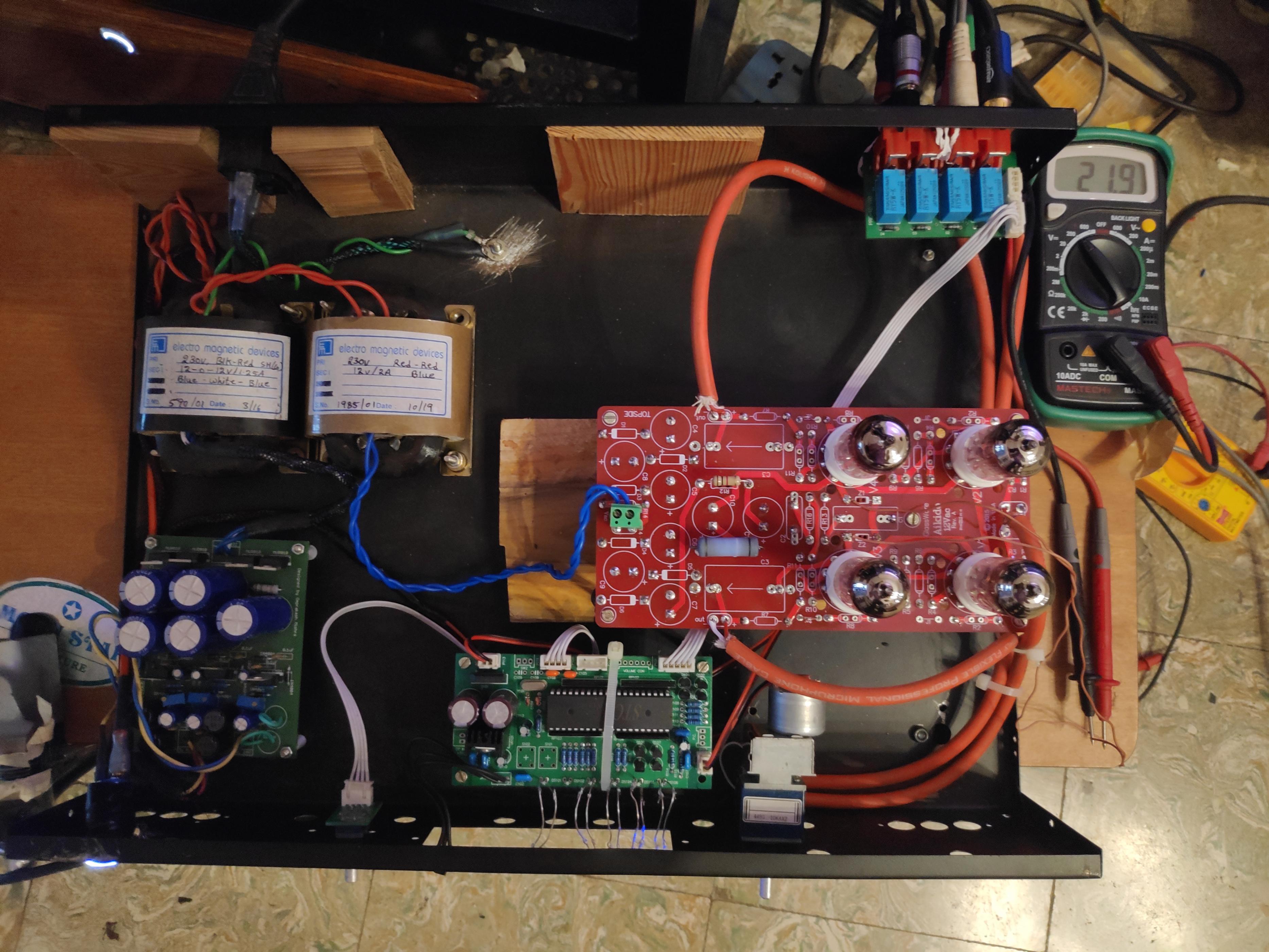

Hi Steve!
I'm not aware of input impedance of my monos. But Aikido seems to be working just fine. To be frank, initially music sounded all muddy.. i thought let it run for sometime before i go back to my passive set up.
But! after about 30 minutes or so, music started to sound clean. I'm not good with reviewing/putting in words about the music response but tube seems to make the music bit rounded - might be a good combination for my bit sibilant DAC. 🙂
I can hear hissing sound in the background. I've not grounded the pre amp board. Pdf suggests 0.01uf cap in parallel with 10ohm resistor. Can i make use of 0.1uf cap instead?
Pic of pre board in the chassis: chassis is still a WIP.
0.1 cap is fine.
If your amp has a fairly low (less than 25K ohm) input impedance the 0.1uF output caps on your 12Vac might be a little low and restrict bass response. You might want to go to say, 1.0uF.
I like to break new components in for AT LEAST 50 hours before even starting to judge sound quality. Then at least another 50 to 100 hours before I'm comfortable passing judgement. Of course if you replace a tube or an output cap say, the break in starts all over again.
S.
