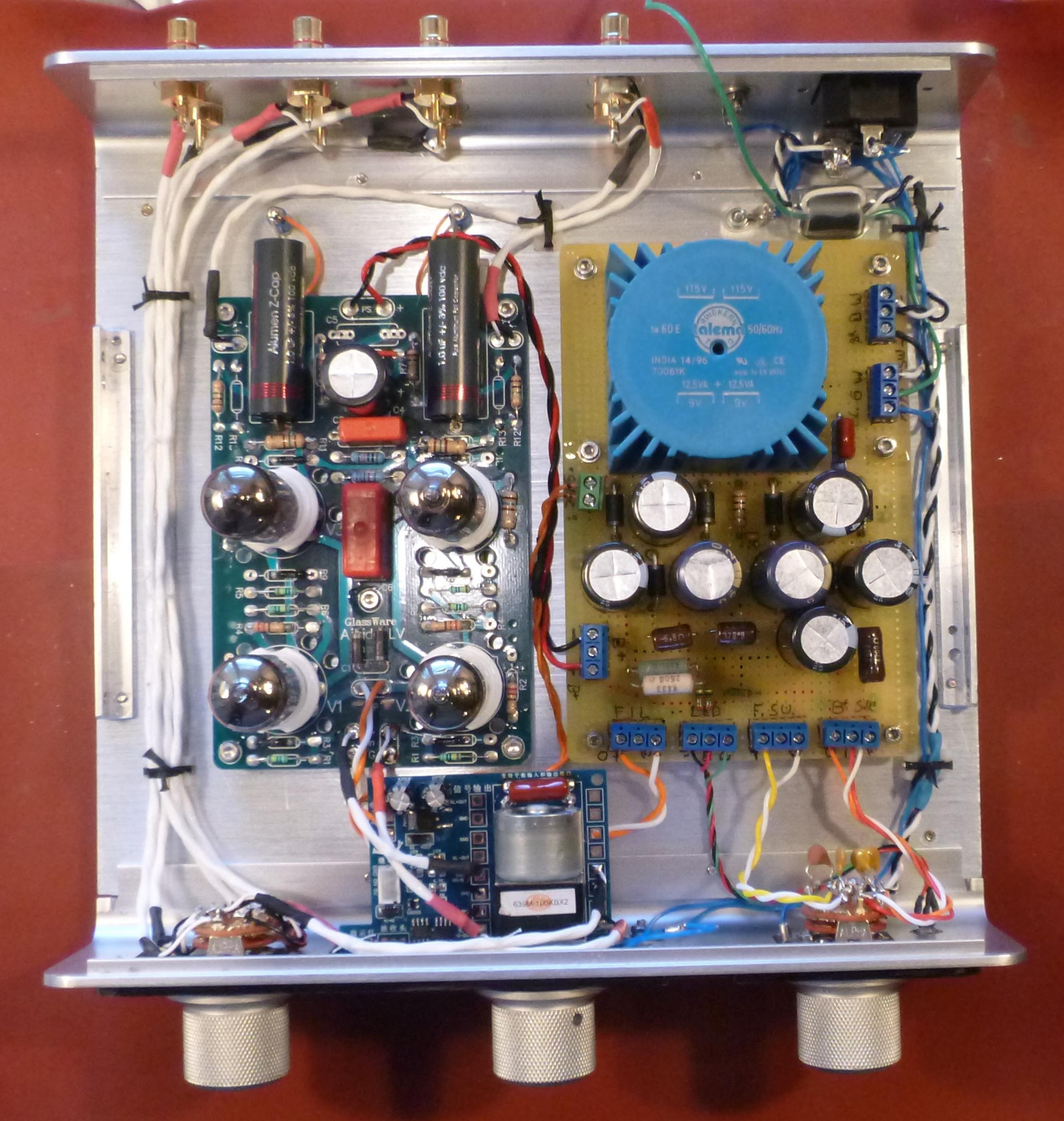

zcastre, was it the Aikido LV you built?
I had a LV board and did a little creative hacking to boost the B+ to about 48 volts. I copied the power supply part of the 12Vac on a separate proto board. See pic. Using a 9 volt trannie lowered the B+ but still gave me a bit more than 24 volts for the filaments. The normal power in on the board got the B+ but the filament supply was connected to the board between V1 and V2. See pic. I also installed the zener mod here too. I had to cut a few board traces to separate the filament from the B+. Each triode of a 6GM8 will handle 30 volts so two "stacked" in an Aikido will handle 60 volts. With 48 volts R2 & 4 were set to 220 ohms, R8 & R11 180 ohms.
I also put in a remote volume kit, a cheapo found on eBay.
It sounds decent but doesn't quite have the drive and pace of a 6DJ8 version of the 12Vac.

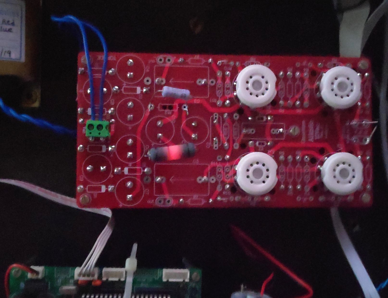

R15 [20ohms, 3W] on my build is getting really hot on powering up and i can smell it's burning. I turned it off within a minute or so - didn't get a chance to test voltages.
I've used all recommended values of resistors from build guide. What would be the next step? I checked all the polarities - everything looks fine 🙁

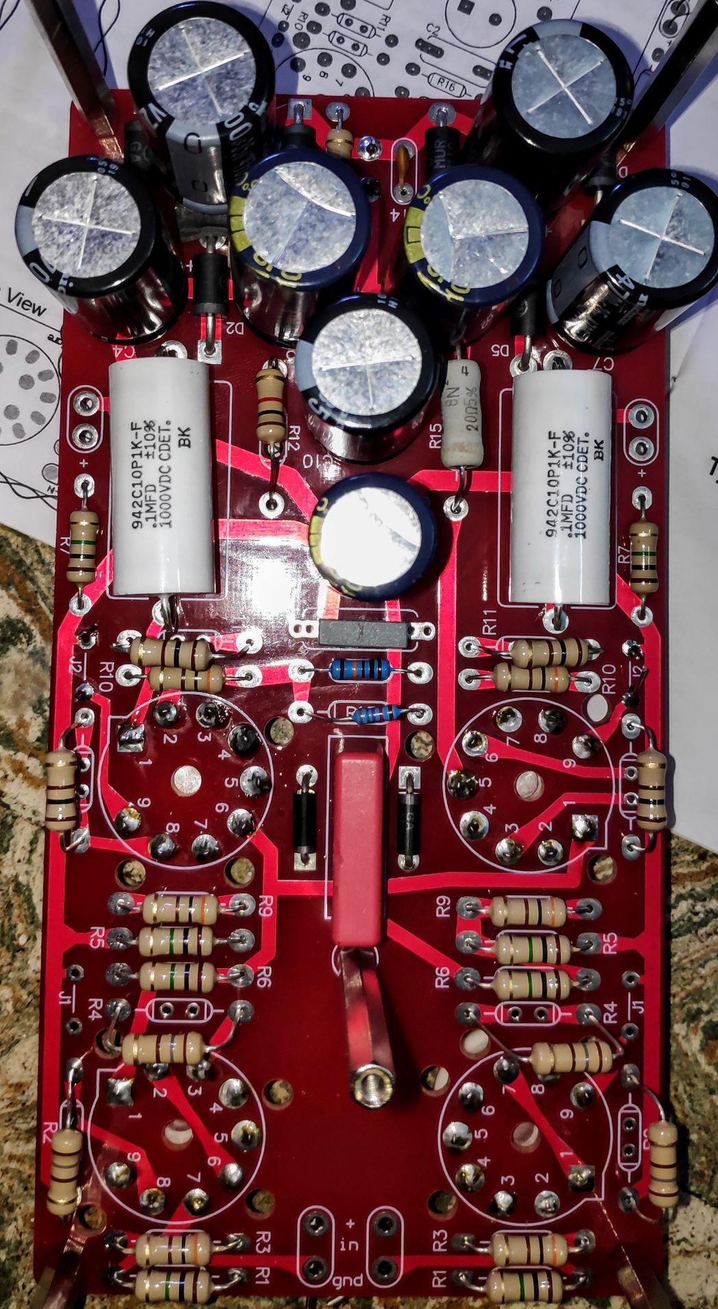

It looks like your plan is to have the tubes on the top side of the board and all of the rest of the components on the bottom. You might want to put R15 on the top, spaced say 2mm above the board for better cooling.

Yep, I saw R15 smoking and turning black.
Input voltage as measured is around 12.4Vac - I use a servo stabilizer.
For R15: I started with 24 ohms resistor rated at 5W, even that started smoking. Later changed it to much stout looking 35 ohms resistor. Even that smoked.
Later, based on qguy2000's posts : changed the R12 from 1K ohms to 2K ohms - this time around R15 didn't smoke - but eventually it started glowing Red.
All these checks are being made without inserting tubes : don't want to destroy them. Hope I'm doing it correct?
I do not have 100 ohms resistors of higher wattage rating with me - will try again with those resistors later.
Yep, I changed the position to top for both R12 and R15.
Including the resistor values used in the build - just to be sure. If I'm not wrong qguy2000 has made use of different resistor values.

R15: 20 3W, 24 5W and 35 [not sure of the watts - this is the guy flowing red in the below pic]

Wow
That resistor glows! Does it do that when the tubes are installed too?
Disconnect one end one of the zeners and remove C10. On C10 put a little heat on one lead then pull it out a mm or so. Do the same with the other lead. Go back and forth applying heat alternately to each one until the cap comes free.
Apply AC to the board and if R15 still glows there is short circuit somewhere in the filament circuit.

Hi Steve,
R15 glows with the tube installed too - though takes bit of time. Strangely, tubes didn't glow at all. On my first power up with the stock resistor values of R15 [20ohms] and R12 [1K] tubes were glowing faintly.
I also measured the DC Voltage across R15, it was around 30+ volts.
After removing tubes, Output caps and disconnecting only one end of the Z1 Zener, R15 didn't get hot. Rather measured DC Voltage across R15 was negligible. Planning to go back to 1K ohms for R12 and current value of R15 [30 ohms] along with the tubes and check. Will do this tomorrow. This time around will measure Voltages even if resistor glows red.Disconnect one end one of the zeners and remove C10. On C10 put a little heat on one lead then pull it out a mm or so. Do the same with the other lead. Go back and forth applying heat alternately to each one until the cap comes free.
Any other ideas for trouble shooting! Else, will hold off on experimenting until I get my hands on 100 ohms 6+Watts resistors for R15.

Maybe just remove R12 and leave it out until you get the filaments sorted out.
Were the tube in with the latest measured voltage across R15? If not it isn't surprising, no filament current draw = no voltage drop across R15.
Maybe you have a bad C10 cap and/or a bad Zener. Leave them out/disconnected for now. Use the 100 ohm resistor for R15 to start. Install the tubes and see what happens.
Can you vary the voltage to the input of the transformer? If you can start low and ramp up the voltage gradually.
Check you circuit board for any solder bridges across places where they're not meant to be.
Once everything is working you might want to solder as many parts as possible on both sides of the board. I like to as it is more mechanically and electrically secure.
Steve
Hi Steve,
I changed the R12 back to 1k and disconnected zener and output caps.
Retained the 25 ohms resistor as i still couldn't get the 100 ohms one.
I measured the villages: B+ voltage was around 85 volts. And every other voltage was same as per the pdf manual! And the R15 didn't glow or smoke even after 5+mins (voltage across R15 was around 12+ volts).
On connecting the zener back , tubes didn't even glow and the R15 was getting hot again( R15 voltage was now 30+volts) . What do you suggest? Should i get a replacement zener or can i leave it out altogether?
PS: thanks for diagnosing the zener issue! 🙂
Leave the Zeners out if you wish. The first version of the 12Vac didn't have them. What filament voltage do you get with the 25 ohm res? Monitor the filament voltage from first switch on to make sure it doesn't get too high before the tubes warm up. If it doesn't forget about the zeners.
If you are concerned about high filament voltage during startup a 3 pole, 3 position switch will help control that. Let me know and I'll share the circuit if you wish.
S.
S.
Hi Steve, i disconnected the zener and measured the voltages again:Leave the Zeners out if you wish. The first version of the 12Vac didn't have them. What filament voltage do you get with the 25 ohm res? Monitor the filament voltage from first switch on to make sure it doesn't get too high before the tubes warm up. If it doesn't forget about the zeners.
S.
Filament voltage : I'm getting 23 volts ( across z1 and z2). It rises slowly to around 23 volts and stays there after power up.
B+ voltage is 84.5 volts
Between jumper and R2 voltage 0.86 (close to V4 tube) and R2 voltage of 0.75 volts on the other side
R11 voltage is 0.48 volts (same on both sides)
Except for R2 voltage near V4 (range specified in pdf is 0.6 to 0.8) , everything else is within the range!
I checked the output voltage for AC with shorted inputs. It almost didn't register any reading.
Now I'm yet to solder the output caps.. waiting for voltages to drain out..
