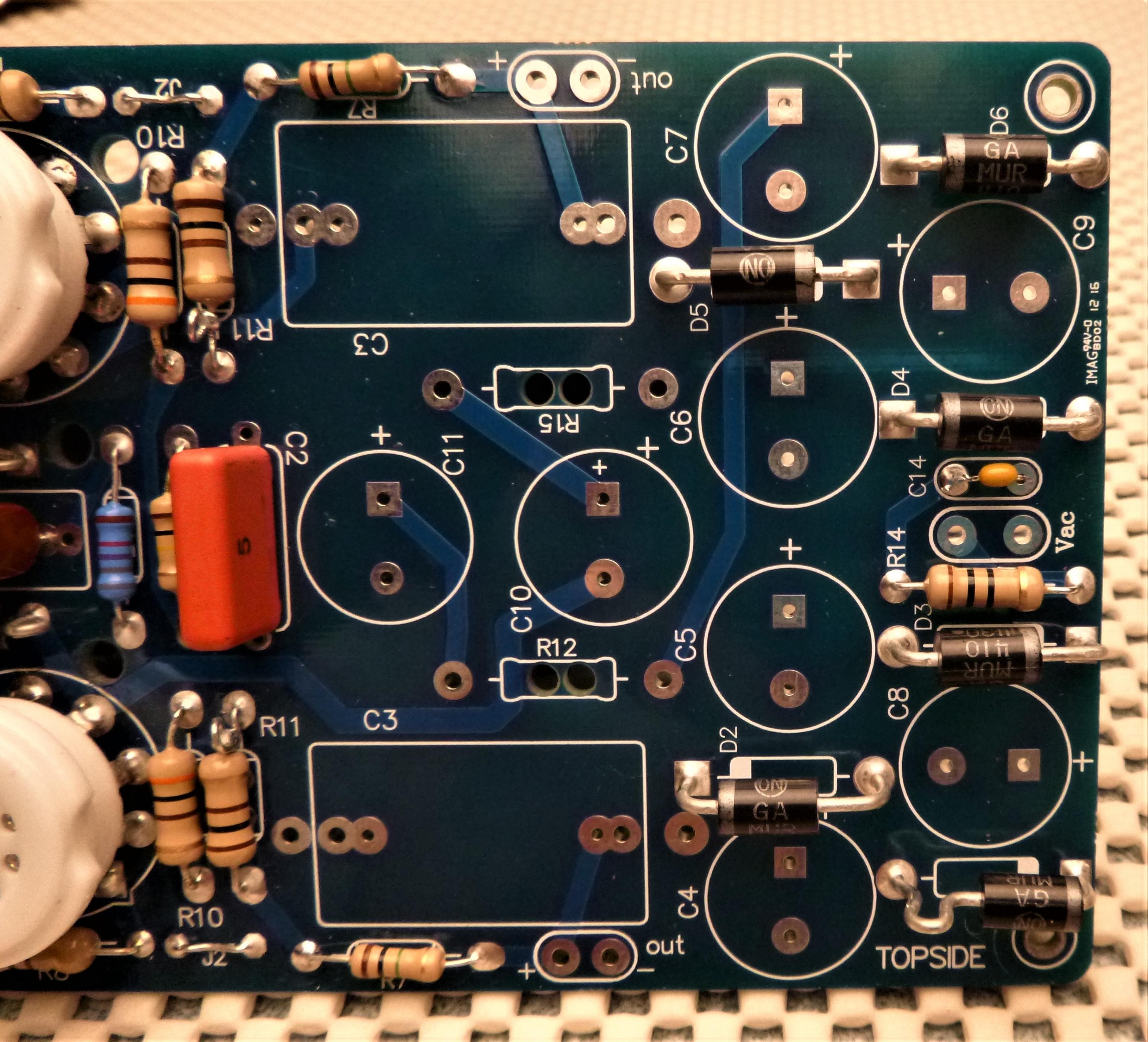

I am almost finished with soldering my Aikido 12Vac board and I am stuck at the J1 and J2 jumpers. I can not seem to find any info about these. Does anyone have recommendations for what to use here?
If you are using E88CC (or equivalent) just a piece of cut off resistor lead will do for J1 and J2. These ground the internal shield (pin 9) in the tubes. Leaving a small loop in one of them will serve as ground connection when making voltage measurements.
If you are building the 12AU7/ECC82 version pin 9 is connected to the filament centre tap. DON'T USE A JUMPER!!!! Just omit J1 and J2 or put a small value film cap in. I'd just leave J1 and J2 empty if building this version.

I am using the E88cc tubes so I will use some left over lead to make the connections. Thank you for the quick response!
When soldering the final parts I noticed that the suggested R13 resistor of 88.7k was missing from my kit. What I do have are: 80.6k, 82.5k, 84.5k, 86.6k and 93.1k. Can I use one of the other resistors instead and what would be the consequences if I do.
