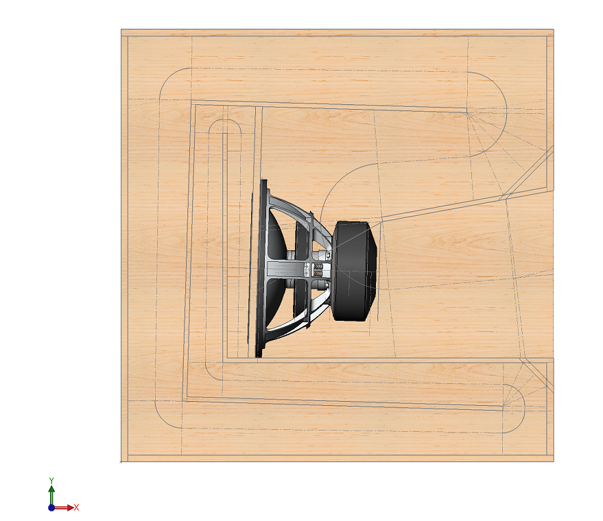

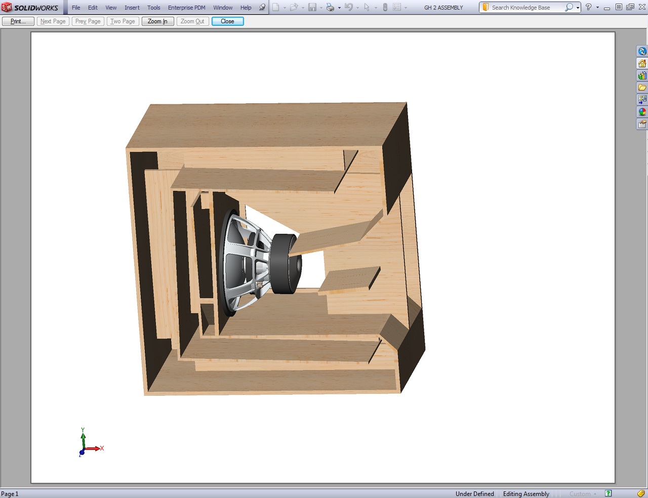

Gjallarhorn v2 is finalized.
Here is the fold of the improved second version of the GH. The goals or main areas of improvement to be addressed with the new version are...
A cleaner fold pattern with less bends overall, less short 180 degree folds and use more 90 degree bends where possible.(The original Gjallarhorn fold had 9 bends and 5 180 degree bends. The 2nd generation has 7 bends and 4 of them are 180 degree)
Reduce the air friction and "drag" in the enclosure by reducing the amount and sharpness of bends. This should aid in reducing compression and air turbulence at higher output levels.
Increase the throat volume slightly in order to also reduce throat compression and add excursion clearance.
Match closely the response shape and corner of the original.
Reduce mechanical/motor noise and the outer panel vibration especially at the mouth by moving the driver deeper into the enclosure and allow for more bracing around the driver baffle and mounting area. Less cabinet vibration at heavy output.
Switch the driver to a mounting position that places it in a horizontal position in all typical cabinet orientations both lying flat and standing. The old GH places the driver in a vertical position when operating in the standing position which could lead to cone sag over time.
Performance should be virtually identical but if there is any performance difference it would be a slight nod to the new version simply due to a better braced cab around the driver and less bends so a little better air flow through the horn. If anything it would show up at war volume with compression sweeps but I'm just guessing here.The cabinet now has a pair of side hatches for driver access.
Attached is screen capture of the first generation fold (First pic) and the second generation fold...
Below is the Akabak script for simulating the GH 2 which includes the cone volume and the driver frame and motor in the horn path.

I like the fold a lot.
however, won't motor noise actually increase, as the port is directly pointing at the horn mouth, instead of at a panel?
I've actually resorted to motor diapers on some designs, spandex and a bit of acoustical cotton spaced a short distance away from the port.
Ok...You got me. When I started the redesign process I had a completely different fold from this that I thought would work and the motor was a little further back in the path and with a much different orientation around a corner. As usual something had to be compromised and that was far down on the list of priorities. 🙂 Actually motor noise has never been a problem at all but some other drivers are not as quiet in operation.

The new version looks a lot more simple to build, assuming the inside "C" panels can be built square and then just mounted to achieve the angles.

If anyone wants a build print for this cab in pdf form either to build or for curiosity sake alone send me your email in a pm. The print is intended for a wood shop to use with a cnc, but all of the information is there to make any modifications necessary.

Is there a difference in outside dimensions for the old vs new versions?
