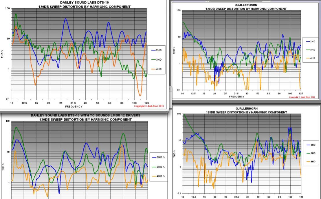

Josh,
Interesting to compare your results of the Gjallerhorn’s output and distortion to the DSL DTS-10.
At 20 Hz, where a 5 dB increase in SPL “sounds” twice as loud, the Gjallerhorn can play 8 dB louder than the DTS-10 with less distortion. What is the volume (cubic feet or liters) of the DTS-10 compared to the Gjallerhorn?
The DTS-10 uses push pull loading, yet for the most part, 2nd harmonic distortion (which PP is purported to reduce ) is generally higher than 3rd, and also higher than the single driver Gjallerhorn.
My high power tests on Eminence Lab 12 in ported and sealed cabinets run PP compared to normal had mixed results, PP reducing 2nd harmonic at some frequencies, while increasing it and 3rd harmonic distortion at others.
http://www.diyaudio.com/forums/subwoofers/191833-push-pull-vs-normal-distortion-compared.html
Any educated guess on how much, if any, the PP loading reduces distortion in the DTS-10?
Art Welter

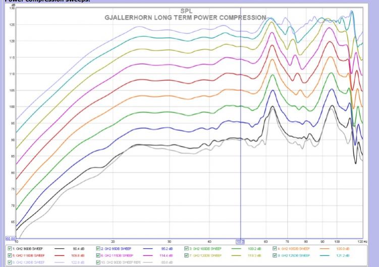

Well...To be honest I don't have a gut feel on how the push pull mounting of the drivers is affecting the distortion in the DTS10 cab. I haven't looked at it enough. I may do a test of this if I don't sell my last DTS10 first. The distortion in the DTS-10 cab is rather high in some places. It is predominantly H2 which is good. The much bigger lesson I have taken from things so far is that any large acoustic gain in a design will also boost the distortion harmonics that fall into that range. In TH's when you have the first large spike followed by the next 2 large boosts and rather jagged response the harmonics that fall into that range are going to get amplified mightily. Look at what happens at 27hz with regards to distortion as the second harmonic gets acted on by the massive 54hz spike in response. The DTS10 is a fairly rough response shape. I would expect the other DSL cabs which usually exhibit a much smoother response to be better in this regard.
The Gjallerhorn is 24x45x45 or 28.125 cubic ft external.
The DTS10 is 16x44x59.5 or 24.24 cubic ft external.
The Gjallerhorn is a 17hz cab where the DTS10 is about a 14hz one. The driver in the Gjallerhorn is a very low distortion unit which is of much higher quality and heavier duty than the stock DTS-10 drivers. Also it has a substantially smoother response than the DTS-10, though it is still jagged.
The much higher clean output of the Gjallerhorn over the DTS-10, even with the 3 Hz higher corner, and slightly larger size, is impressive.Well...To be honest I don't have a gut feel on how the push pull mounting of the drivers is affecting the distortion in the DTS10 cab. I haven't looked at it enough. I may do a test of this if I don't sell my last DTS10 first. The distortion in the DTS-10 cab is rather high in some places. It is predominantly H2 which is good. The much bigger lesson I have taken from things so far is that any large acoustic gain in a design will also boost the distortion harmonics that fall into that range. In TH's when you have the first large spike followed by the next 2 large boosts and rather jagged response the harmonics that fall into that range are going to get amplified mightily. Look at what happens at 27hz with regards to distortion as the second harmonic gets acted on by the massive 54hz spike in response. The DTS10 is a fairly rough response shape. I would expect the other DSL cabs which usually exhibit a much smoother response to be better in this regard.

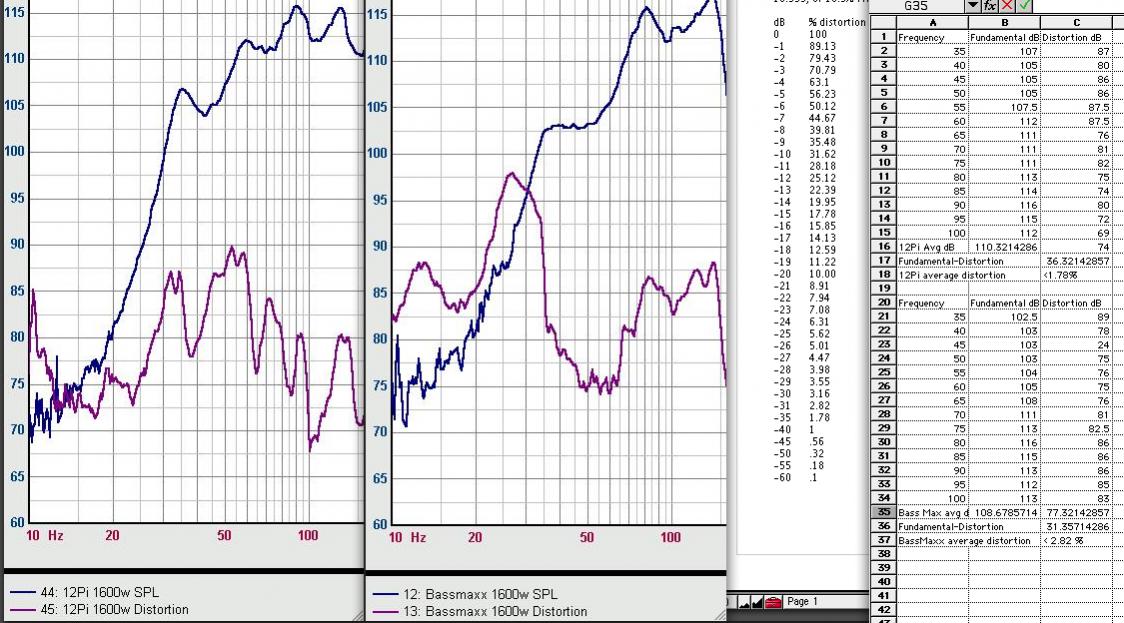

Oh I don't know...I would expect the 12pi to be an absolute beast above 35hz. It is a very large sub and it is concentrated on the 40-100hz area primarily. On a 1/1 basis I don't expect many other cabs to compare well in that range. Now if we are talking about multiples of other cabs then that changes things quite a bit.
Btw I talked with Chris and it looks like the V/I box fried due to user error on my part. I must have somehow reversed the polarity from the amplifier into the box before the high power tests. An easy mistake to make if switching the V/I box in and out of the signal chain and not paying attention closely. D'oh! 😱
The 12 Pi appears to average 120.3 dB at one meter from 35-100 Hz, 1600 watt measurement, (20 dB added to compensate for the 10 meter vs 1 meter) as high power as Wayne seems comfortable testing it.
You are feeding the slightly smaller Gjallerhorn more than double the power, but from what I see on your chart, looks like it averages over 123 dB from 25-100 Hz.
From a SPL standpoint in singles, I’d bet on your box .
The FLH would gain some LF in multiples though, while the TH gains in forward directivity, making multiples more of a crap shoot as far as SPL advantage.
A pair of BC18SW115-4 loaded Keystone TH with extenders are about the same (stored) size, sensitivity, and frequency response as the 12Pi, and about double the power handling.
I’d expect them to also better the 12Pi by about 3 dB given double the power, and be neck and neck at the same power.
