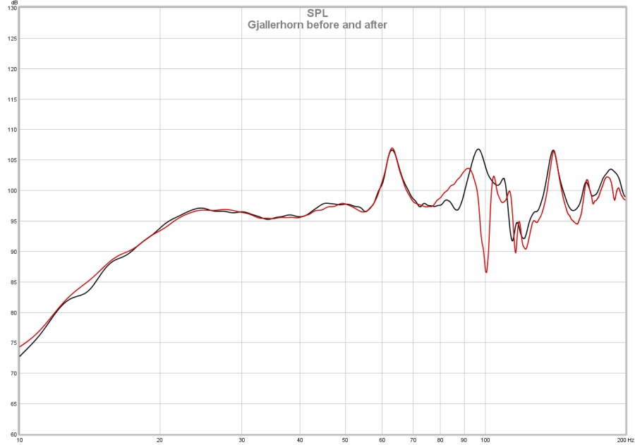

You seem to be beating yourself up over a 5 Hz wide 100 Hz (out of the intended pass band) dip.
The DTS-10 has a deeper and wider response dip from around 105 to 125 Hz, and the Gjallerhorn seems to have a smoother response compared to your DTS-10 measurements.
A ramp in the last turn as suggested is worth a try, but probably is not going to cure the null. As far as the access panel vibrations, you might use strategically placed rubber feet in that area, the weight of the cabinet will be concentrated more on the center area if you sand a couple millimeters off the outside four feet. Sand them down until the outside feet are just carrying a few pounds of the weight.

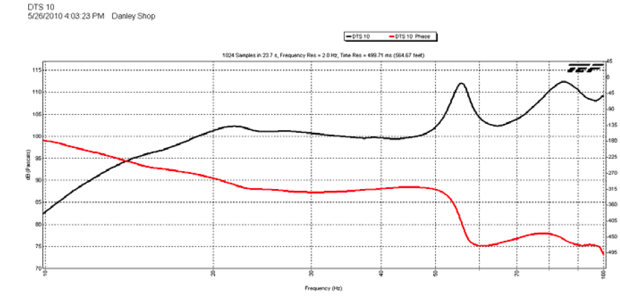

Speaking of your measurements, I notice DSL’s DTS-10 chart averages about 101.5 dB SPL from 20-50 Hz, while your chart averages only 87.5 dB. Taking the 6 dB drive level difference into account still leaves around an 8 dB sensitivity difference between your and Danley’s measurements.
The usual DSL tests are done using 28.3 volts at 10 meters outdoors, but the DTS-10 chart says “Danley Shop”.
I asked Tom Danley about that level disparity in some E-mail correspondence, but he did not reply.
Do you have any idea what would be responsible for the large disparity?

I tried out a few things to see if I could get some worthwhile improvement yesterday.
I tried adding a reflector panel at 45 degrees in the last corner before the driver to see if it would affect the upper end response and perhaps help out at 100hz...No dice. Negligible impact. Scratch that from the list.
While I was at it I tried some damping in the throat behind the driver and a generous amount in the last 2 corners before the driver. The throat damping did nothing of note really other than sapping about a db of efficiency. With all of the damping in both corners and in the horn throat it did clean up the response some and knock down the horn resonances at 63hz and 90hz quite a bit. However it also caused an efficiency loss of nearly 3db across much of the bandwidth! 😱 No thanks. I don't think the slight improvement is worth the hefty loss of output which is what these big guys are all about. I'd rather just use EQ to knock the edges off. It would be needed with or without the damping anyway. You can see the efficiency losses in this graph.
Here is the effect that all of the damping had on the decay of the horn. It did improve it somewhat but once you bring the level back up to match what it was prior to loseing the efficiency it isn't as much as hoped. Again not worth the efficiency sac IMHO.

My observations regarding DSL's sub charts is the TH-115 and TH-118 are 3-6 dB high compared to other industry standards. Your DTS-10 measurements are even further off.
A side by side comparison of a DSL sub to any industry standard with published charts would confirm or refute my observation. A few months ago Ivan Beaver said he would do a test with some EAW cabinets in shop, but has been very busy and has not.

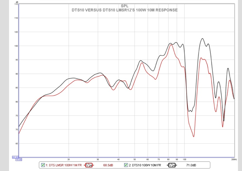

Well. Unless I have made some huge mistake the dts10 efficiency is right where I have it. Using my bastardized 1w method. I have measured this probably 4 times now. I have the dts10's set for one more round this weekend to answer a few other things. I double checked yesterday and I did indeed have the drivers in parallel as thought. Also of note is that the simulation of the dts10 comes in right about where the measurements I have done do. I can't get the HR sim to show this extra efficiency either. Everything that I have on them matches up pretty well as I see it. If we can't even get a perfect scenario on the computer to come close to matching the quoted sensitivity then something is not right. I have heard mention that there is an extra 3 or 4 db that no one can seem to come up with. If you add the roughly 6 db for moving to a 2.83 v signal this is about how far from the mark it would be. The Data-Bass info showing about 10db down in general with about 6 accounted for.

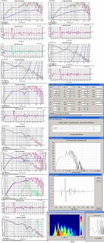

That is a lot of data in your screen attachment! Is difficult to follow exactly what the progression is/was. At the end I see that you are attempting to address the uber TH ringing at 63hz in this guy and the impulse or time domain response, notably the bump prior to the peak. I recognize the basic data and the addition of some EQ but what is the difference applied in the green and blue traces? One thing is for sure...Any time there is a radiator in one spot and another 10-20ft further away there will be some wonky time domain issues!🙂
Bjorno,
Finally, another person who uses the word Wonky! Most of that data was overwhelming for me! There is just so much going on with these horns! I am working hard to understand. I am watching this very closely as I might build one of these for my LMS once I see some final results and someone else has done all the work for me 🙂

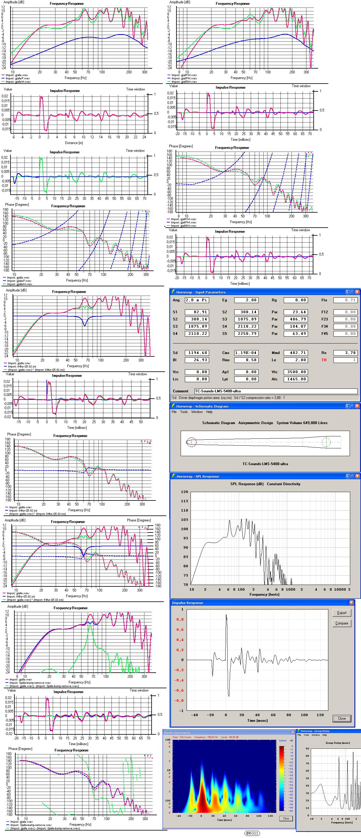

Gjallerhorn: If using a 5 band min-phase parametric EQ
Sorry for being late with this answer:

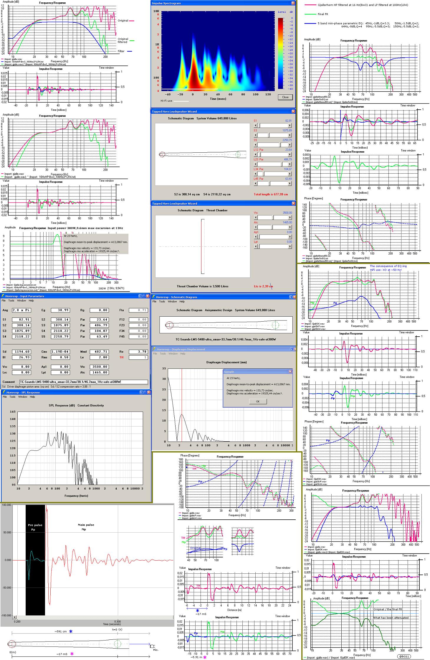

The cerise color(~red),the first upper left plot is the total simulated FR for the TH.
Green is the resulting FR after splicing the IR into two parts:Blue is the Pre-pulse FR i.e. the starting negative amplitude that precedes the positive green Main-pulse FR.
Time t=0 is set to when the Main-pulse has propagated from the driver front to the rear side.
Here's more to chew on:
b 🙂
b 🙂

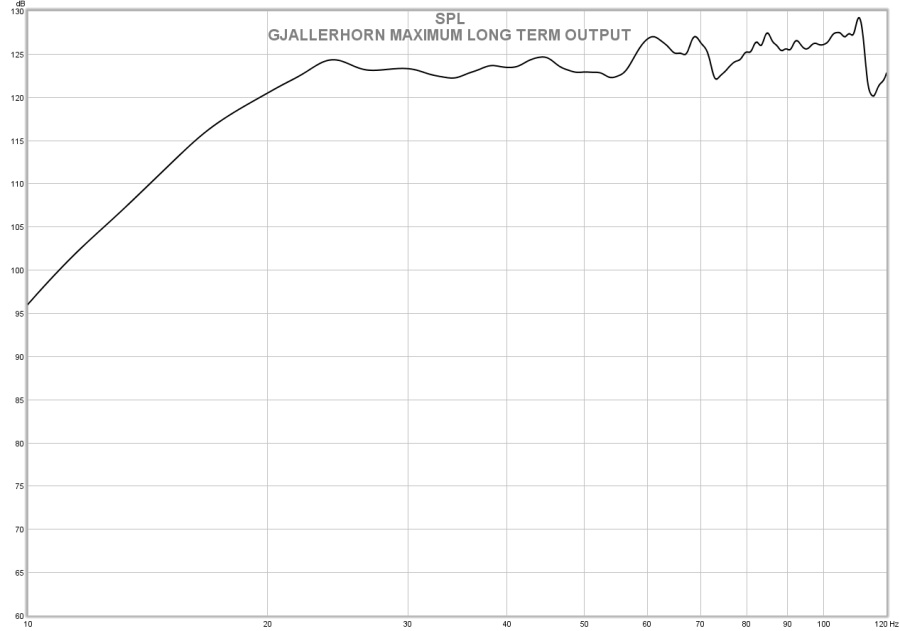

I have done some outdoor testing on one of the cabs. I have attached the maximum long term output available using a 10-120hz, 24 second long, ascending sine wave sweep recorded outdoors at 2 meters ground plane. Amplifier is a Powersoft K10 on 240v. There is a good deal of thermal compression in evidence so CEA2010 burst testing should show peak output numbers somewhat higher still. There is no lack of output here. The driver did not grenade, or shred the cone or develop coil rock or any of that. If anything the driver has a much harder time dealing with the power themally. The power compression sweeps are 9 24 second long ascending sweeps back to back with each having the level increased by 5db over the last. This is ended when the sub exhibits clear distress signals. This was immediately followed by 1/48 octave sine burst distortion testing using the STEPS program which takes about 5 min to complete the full measurement. There were 9 of these run back to back at the same input levels as used during the power compression sweep tests. By the end of this the motor was extremely hot and there was the smell of hot voice coil adhesive (Mmmmm.) and some darkening. This was on a visciously hot 95degree day in direct sunlight as well. I ended up running a greatly reduced power 20hz sine wave for a few minutes, which is at the in passband excursion maximum to help cool the motor down afterwards. This is far far more punishment than even the worst real world, long term duty it might ever be asked for.
After testing a DTS10 a couple of times and switching to totally different much beefier drivers and testing that and now testing this tapped horn I have noted that the usual peaks that are seen at low volumes and in simulation get heavily compressed and squashed at the highest playback levels. I am ruling out amplifier clipping due to having plenty of power on hand to either fry or launch the cones at will. It appears that there is either severe compression occuring in the drivers or that there is some sort of acoustic limiting or compression occuring inside the horn itself. i am leaning towards some of the later. Thoughts?
Also after taking this thing a little bit past the limit truthfully I wish that I had beefed the cabinet up a little more and used more bracing. At the very highest sweep levels the cab sounded as if it may blow a seam and developed a buzz in a few narrow frequency ranges near 63hz and about 85-90hz. This isn't evident if you knock the output back to sane levels. I doubt they would be notable with real broadband content either. Outdoor sine waves are pretty unforgiving on exposing rattle and buzz issues. There must be an enormous amount of power being developed inside of this cab. I think I may have underestimated how much.

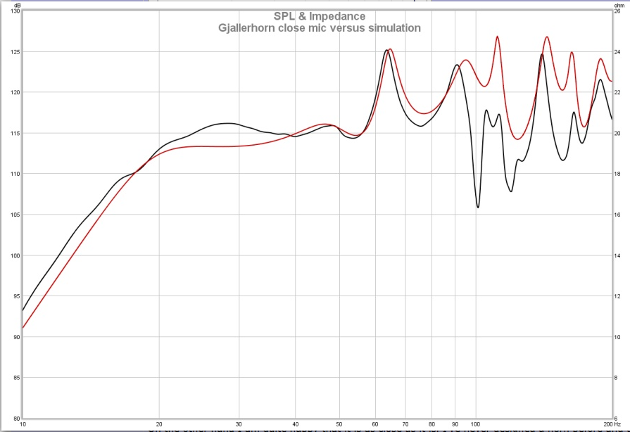

Now this is a real curiosity. When I first put the cabs together and applied power I took some close mic graphs. These all show a 100hz dip that was not apparent in the simulation. I then ran the pair lightly in a pa set-up for a few days. Fast forward...I get one of them outside to test it and lo and behold the 100hz dip is gone and between 90-110hz the response has changed. The 100hz dip is no longer there. I freak out thinking perhaps I had damaged something in this cab, or the driver, or both, which wouldn't have been out of the realm of possibility considering the beating bestowed on it, so i run inside and take a measure on the other cab and it is now missing the 100hz dip too. 😕 That one hasn't been used very hard at all. I thought that perhaps I somehow had EQ engaged during the original measurements but there is no way. The drivers were brand new and had never been above about 2v so perhaps they had a major break in and this is responsible but I find that a hard pill to swallow. The cabs are 13ply BB with pocket screws and are PL'd together and built by a professional cabinet shop who's owner owns DTS-10's and is familiar with speakers so I have a hard time believing that a panel came loose and shifted enough to cause the response change either. I am at a loss to explain it really. 😕 I have attached a couple of measurements illustrating this as well. The 100hz notch is easily seen in the original measurement. The other one is the current response where there is no longer a 100hz dip. Very odd. 😕 Atleast it is a response improvement. 😱
Josh,After testing a DTS10 a couple of times and switching to totally different much beefier drivers and testing that and now testing this tapped horn I have noted that the usual peaks that are seen at low volumes and in simulation get heavily compressed and squashed at the highest playback levels. I am ruling out amplifier clipping due to having plenty of power on hand to either fry or launch the cones at will. It appears that there is either severe compression occuring in the drivers or that there is some sort of acoustic limiting or compression occuring inside the horn itself. i am leaning towards some of the later. Thoughts?
Now this is a real curiosity. When I first put the cabs together and applied power I took some close mic graphs. These all show a 100hz dip that was not apparent in the simulation. I then ran the pair lightly in a pa set-up for a few days. Fast forward...I get one of them outside to test it and lo and behold the 100hz dip is gone and between 90-110hz the response has changed. The 100hz dip is no longer there....

That is some serious LF level, even for a cabinet that size !
No wonder the driver was hot, and with that much thermal mass and a high ambient temperature, it probably stayed hot for a long time.
You seemed to be beating yourself up over a 5 Hz wide 100 Hz (out of the intended pass band) dip two weeks ago, now that it is gone you complain ;^) ?
I have found indoor measurements to be very difficult to reproduce, unless every detail has been meticulously recorded.
Did you exactly repeat the measurement microphone location, speaker orientation and room position as when you measured the dip?
