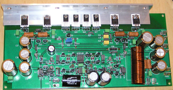

Hi Smithy,
Thanks for the info. 1n6638 looks really good on paper. I've checked my ordinary sources (Mouser, Farnell, DigyKey) and none of them has it. Where did you get it from?
As an input cap I use 10uF/100V polypropylene. It's big but just fits in. I'm not using R39, R9 will be 470 or 1k low noise Vishay (I haven't decided yet), C24 is 680pF silvered mica and R12=R20. These will be either 10k or 8.2k low noise Vishays. I have not decided yet but most likely I'll go for 10k.
D25 and D26 are doubled to reduce distortions and as I said before C22-C23 are replaced with a non-polar Black Gate 220uF/50V and it will be most likely bypassed by 2.2uF Solen or Bennic or ME polypropylene. I have a few of these. These are standard speaker crossover caps.
All the other polypropylenes are WIMA. Filtering electros are bypassed by XION "non-inductive" caps and each the PS rail will be additionally filtered by 680nF "non-inductive" cap in series with 1ohm/15W to the ground. That is supposed to minimize the effect of internal inductance of the big filtering electros. Never tried it before. Main electros will also be parallelled by some larger polypropylene caps: 22uF or 47uF. Small pF caps are 500V silvered mica but in some cases (47pF) I might use polypropylenes.
If the NP (or polarised electos) cap in the NFB is kept and connection with the preamp clean, it may be possible to remove the input cap.
I have also reduced R36 to 3.9 ohms as I have a few of these. Theoretically one should go down to 1ohm to minimize the ringing but I don't think my ears will hear the difference. The coil's inductance will also be reduced to about 2.2uH - certainly I will not go above 3uH. If the amps are to drive safe loads then the coil and R36 can be removed. Apparently the removal of both input and output filters makes audiable difference but I know for sure that removing the NFB cap makes a difference. The problem is to set the offset below 10mV but without a servo circuit it may be impossible.

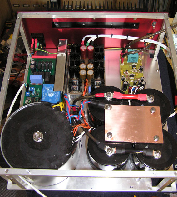

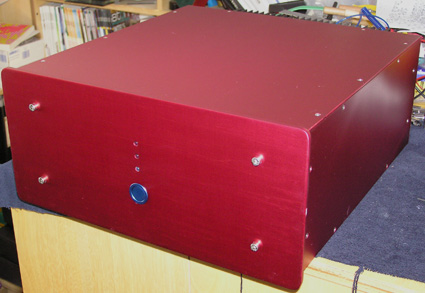

Finally nearing completion on my refit. One amp is finished & assembled. I replaced the output transistors as I needed to change the way they mounted to fit the new heatsink. Interestingly, IR have upped the spec on the IRF640 devices - increased current and higher max Tj (now 175 deg, up from 150) - since I used them about 8 years ago. Anyway, matched the output devices, fired it up and set the bias current to 150mA. Seems to be pretty stable (+/-3mA). Also DC offset seems to be pretty low.
Pic of finished case below - I hand built these with the exception of anodising (the colour is actually cherry red)

Hi Smithy,
Congratulations on the first module. Very crowded inside.
The middle board looks like a regulated PS, the right one could be a speaker protection board but that is guessing. None looks to me like the original PA board. The main board I presume should be close to the radiator but I do not see anything there.
So what is in the box? What are these boards starting from the left?
cheers,

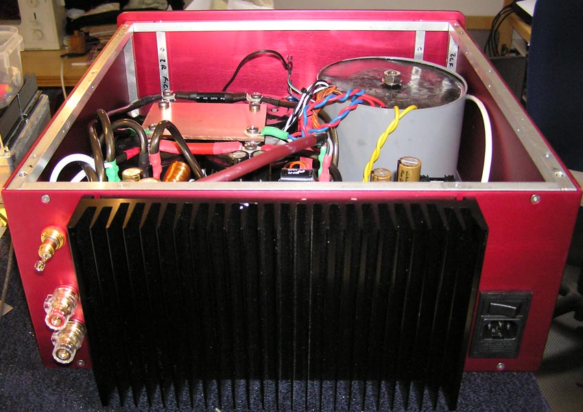

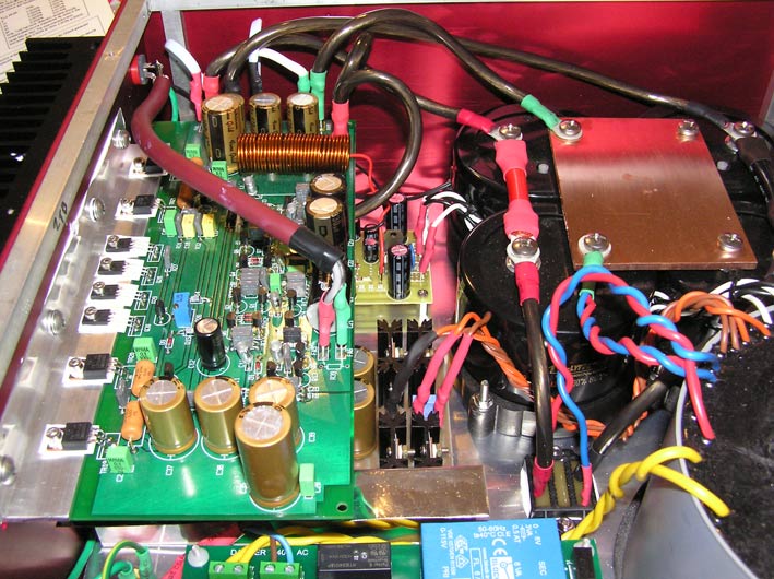

Hi Janusz
Not quite as crowded as my last one....I can actually work on this one without pulling everything apart.
I took the photo before putting the amp module in, then last night screwed on the top of the case without taking another photo - I will for the second amp, which will be finished in a couple of days.
The board at the back left is a soft start/remote switch power on (so I can use the push button on the fron panel). This is my own PCB. In front of that is the custom transformer I had wound - potted toroid 2x40V 400VA, 2x50V 100VA and 2x12V 20VA from TorTech. Just in front of the toriod is an IXYS bridge. Front right is 4 x Mundorf 33000uF/80V electros. In the middle rear is a regulator board for the +/-57V regulated rails. Again, one of my PCBs from several years ago - uses LT1085/1033 and HEXFRED rectifiers. To the right of this is a Borbely DC protection, turn on delay. The amp module bolts to the heatsink (cutout in back panel), with the heatsink being a 0.4 deg C/W Fischer unit.
The amp board still uses Caddocks throughout (standard and power), met polprop caps and blackgate caps. As mentioned, I replaced the IRF640/9640s and BD139s as the heatsink mounting method changed for this case.
I made the case from 3mm aluminium panels, 6mm aluminium front panel, with a frame of 10mm square rod and a sub floor of 1.6mm aluminium, which everything mounts on. I drilled and tapped all the holes and countersunk all the screws for a flush finish (except the four cap heads on the front panel). Then I sent all the external panels off to the anodisers....
Two years passed and hundreds of hours later I'm nearly there. Looks heaps better than my previous one.
I should add that the case colour does look really good (even though many will not like it), particularly in its final resting place.

smithy666 said:the colour is actually cherry red
Lovely case, i've added the image to my collection, Smithy.
Very pretty on the inside too.
Who dare say Aussies lack fancy taste, mate ?

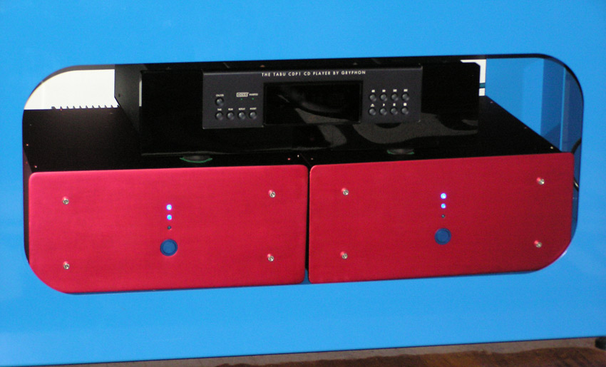

Finally finished the second amp refit. Bias again set to 150mA. DC offset was a bit higher than the other channel, around 23mV (the other channel was 6mV). Anyway, all installed and sounding great. A few pictures follow.
The first photo shows both amps installed in their final resting place. Gryphon Tabu CD player sitting on top.
