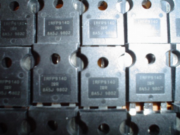

I had excellent results with IRFP9140/IRFP240 on Greggy Ball's SKA GB50D amp and JAM's mosfet A-40 version of the Pass classic.
Thanks to Ilimzn, and the web wonder.
Watch out not to buy IRFP9140N, flush 'm if you have.
A lot of vendors offer the 9140s but they'll send you the N version of the IRFP9140. (even wholesalers, as i've found out the hard way)
I made the mistake before i read Ilimzn's warning on the 9140N, but it did save me from wasting plenty time on trouble shooting.
Initially, i also used the 240/9240 combo on the SKA. On electrostats, the 9140 is clearly the better sparring partner for the 240. Read the posts of the Croatian expert.
(IRFP9140 prices vary a great deal, it pays off to shop around)

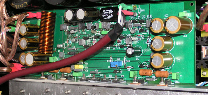

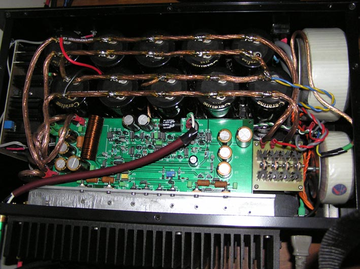

Hi Janusz
I've been using Hexfreds for the unreg and reg supply. I haven't tried the IXYS bridges yet, but they are much faster - will it be audible? Not sure, but I'll let you know when I get them finished. Mundorf make great caps. German made, very high quality but about 3-4x the cost of Elnas and from the specs are capable of delivering huge current. The physical size also works better for my new case (short and fat rather than tall and skinny!!), so I can mount the regulated ps board on top
I thought while I was going to the trouble of rebuilding the cases I would go the whole hogg and change the PS. I've got Tortech in Sydney winding a couple of custom encapsulated toroidal transformers - each one containg three separate dual secondaries to power the reg and unreg amp + protection circuit -to cut down on space used.
I agree on a tight fit - attached is a photo of my current config, all in one case. Don't remember how I managed to pull this off, but the new cases are much bigger, so should be less of a problem.
I also used Caddock resistors throughout and polystyrene/polyprop caps where possible and rather than testing for HV diodes, used higher voltage version instead. I think the electros on board are elna cerafine as well.

Hi Smithy,
That is congestion!!!
Looks that Mundorf caps are even more expensive than Sikorel and your Stochino is a no compromise solution. I use Vishay low noise resistors in audio paths, Milne non-inducive resistors in Zoebel and sources and all caps other than electros are so called non-inductive polypropylenes.
One question about that higher voltage low reverse leakage diode. I could not find any high voltage diode of not much higher recovery time than those specified. So what diodes do you use there? Where one could get them?
And one final question about transformers. I got my two 625VA toroids from Harbuch. Unfortunatelly one is humming too much and should be replaced. It does not have to be encapsulated as it will be in another box - only quiet. Does Tortech do small jobs? It has to be 2x40V under load about 625VA. How much do your trafos cost? Who is the best person to contact there?
