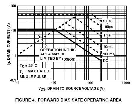

This my reasoning and logic behind why the Amp should be able to run at full power.
The maximum total power that can be dissipated by the mosfets is 480 Watts.
Assuming a Mosfet case temp Tc = 80 degrees then they are derated to 60 watts
Per device. (25 = ideal mosfet temp) Total power that can be dissipated is (125-55) x 4 = 240 watts.
Using ohms law the mosfets dissipate maximum power into 8ohms when the output
into the load is about 17.5 volts rms about half the supply voltage. So the maximum power
they have to dissipate is into 8 ohm with a constant sine wave is about 38 watts.
At full power of 100 watts into 8 ohm and output voltage of 28.3 volts RMS the output stage is only dissipating 23.6 watts.
So given my 0.7 degree/watts heatsink dissipating 40 watts the temp rise is 28 degrees.
28 + 25 = 53 deg and a temp difference between the heatsink and Mosfet case of
20 degrees is a worst case I think gives a Tcase = 73 degrees.
So the amplifier should be able drive full power all day long in my view.
The Mosfet will operate up to a maximum of 125 degrees realistically.
Even into 4 ohms the output is required to dissipate 76 watts at 17.6 volts rms.
derating each mosfet to 50 watts per device this gives a total of 200 watts
for the output stage. The mosfet case temp would be 100 degrees in this case.

you're logic is flawed.
I just ran a 120W pair @ Tc<=73degC for 80W into 8ohms and it sits right on the SOAR limit for 60degree phase angle load.
The 4ohm load has to be reduced to 24degrees to fit the 73degC SOAR.
If I reduce the Tc to 50degC (the worst out of the set of 4) then 4ohm can go to 38degree phase angle (still not enough to drive a speaker.
But your 116W into 4r7 load @ 10degree phase angle is well inside the 50degC SOAR by a factor of 2.
I need to increase Tc (worst case) to 100degC to bring the SOAR down to the device peak dissipation.
And that I suspect is the problem. The devices are exceeding a catastrophic temperature limit during your high frequency testing, due to a combination of dissipation into the load and cross conduction that is independant of load.
Have you measured the operating rail voltages just before destruction? I could run the model at that PSU voltage and see just how hard you are stressing the devices.

using your +-45Vdc for loaded rails, the model shows 165W into 4r7 at SOAR limit for 80degC. Peak dissipation is shown as about 130Wpk/pr
The power input would be 189W and output is 165W, therefore only 24W is sent to the heatsink (I don't believe this, it's more usually about 60% of output power). This would indicate a sink temperature of just 45degC and a Tc of about 55degC.
There seems to be a small margin (80-55=25Cdeg) at normal frequencies. But the high frequencies probably took the devices over their peak capability, or the sink was hotter than the model predicts.
However, if one substitutes 60% of 165W for sink dissipation, the Tc temperature jumps to about 110degC. That more likely explains the blow up, particularly if there was cross conduction to increase device dissipation a little/lot further.

Can anyone help,
I have been looking at the SOA graph and info for the irf9640 and irf960 and not quite sure how to inertpret the SOA data for the amplifier output stage. Using a worst case supply voltage of 100 volts as recomened by R. Slone ie (2*50volts) for inductvie loads, 100/8ohms = 12.5 amps peak for ech half cycle. divide by 2 for each transistor ouput stage half gives 12.5/2=6.25 so ech transistor has to handle 6.25 amps peak. Drawing a line acros horizontaly so that it intersect the 100 volt line show that it enters a region were the transistor can only withstand this current and voltage for 1ms. Have I interpreted it right. According to the graph VGS has to reduced to less than 20 volts for the transistor tro operate continously without damaging it. Is this correct.
you should do a series of calculations to determine the load line for your loading.
Then de-rate the appropriate SOA for the temperature of the device cases.
Then compare for your operational conditions.
Look up Bensen's spreadsheet and find the reference in there that shows in detail the manual method of what I have quickly described.
If you can't find it, Email me.

steevo said:Using a worst case supply voltage of 100 volts. 100/8ohms = 12.5 amps peak for ech half cycle.
Using both criteria at the same time is wrong.
First step would be to derate for the temperature rise.

I think your 2pair amplifier is only suited to 8ohm reactive loads (on +-48Vdc supply rails) so the 4r7 test to full power must be a resistive load. Do not add any capacitors nor use long speaker cables. For the 8ohm testing you can use parallel cap for checking for instability, many would advise this as normal amplfier be-bugging.
