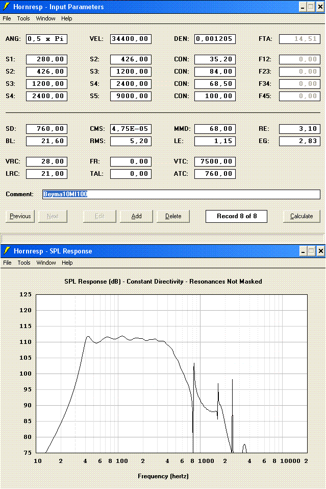

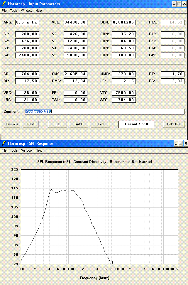

Hi Patrick Bateman,
I am posting two sims with a known box. William Cowan's Horn sub Jr, dual 10" driver 40Hz horn from here. I am simulating with two different drivers with extreme differense in fs. One Beyma 10" pro mid driver 10MI100, fs 89Hz. And one with Peerless XLS 10, fs 18Hz. The Beyma driver fs is well one octave obove cutoff.
I cannot see why this should not apply to a horn in a bigger scale.
Here is Peerless results:

4fun said:And here Beyma results:
Kudos for doing the modeling. I'm a little mystified by the results. I model horns using Martin King's FLH worksheet & mathcad. I generally see very large swings in response from different woofers.
IIRC, Martin's model doesn't take into account corner loading. I have a feeling that explains why two radically different woofers have similar response in hornresp.

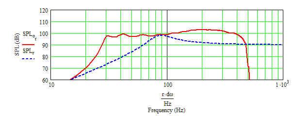

You're welcome! The point I was trying to make though is that the horn is an acoustic lever, so if it expands at the ~correct rate and terminates into a large enough mouth for the desired BW the driver's size/Fs/efficiency is ~irrelevant WRT its LF gain BW. Both my designs will be efficient below the driver's Fs if correctly built.
Maybe a more extreme example will convince you assuming you trust MJK's programming......
RadioShack's discontinued 40-1271 8" ~fullrange driver:
Fs = 83 Hz
Re = 7.9 ohms
Le = 2.1 mH
Sd = 214.084 cm^2
BL = 3.032 N/A
Vas = 32.85 L
Qes = 3.3
Qms = 9.45
Qts = 2.446
With its high Fs and incredibly high Qes/Qts, hardly a candidate for a decent OB, much less a ~30 - 300 Hz bass-horn, or is it?
Vr = 6541.385"^3
Vf = 48.594"^3
L = 212.446"
St = 21.817"^2
Sm = 8014.947"^2
M = 1
For a variety of reasons it's not worth the time/$$ to build one, but my experience with smaller horns with even higher Fs drivers than this horn's Fc-Fs BW spread tells me it will work pretty much as predicted up to at least 300 Hz.
