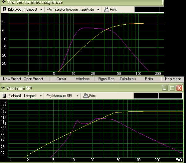

I've modelled my tempests a fair few times (I have 4) in all types of enclosure and I keep going back to sealed. The ported and 6th order BP have a 24dB roll off which also needs a high pass to protect the driver. That pretty much rules them out for the ultra low bass. The 4th order tends to have a 'bump' and then resembles the sealed subs at the lowest frequencies (below the ports output) This was all with an equal box size, which was 600L for 4 drivers.
What would you do ?
I'm space limited as I use 2 labhorns from 20Hz up.
Rob.

Hi Patrick,
I was talking about the BP's low end roll off, not it's top one. Thats where a highpass needs to be added to the 6th order version to protect the driver below the lower ports cutoff. (and to typical ported box speakers)
I understand what you are saying about the high roll off, and it's distortion reducing properties.
What I was saying is that the sealed box tends to 'win' once you have added the highpass to the BP box. ie it's rolling off at ~12dB/octave in room already (allowing for room gain) and you have to add an electrical high pass to it's already falling slope. ending up with a 24dB / 36dB roll off right at the bottom where you want it to be producing the 'ultra low' stuff.
With sealed you can end up with an almost flat response at the lowest frequencies as the 12dB roll off is compensated by room gain pretty well. With my tempests in 220L enclosures they measured flat from 30Hz down to ~12Hz. (with no EQ)
I'd imagine a BP tuned to ~8Hz with a high pass in place at the same point, and a bit of EQ could work to give a flat response down to 8Hz then drop like a stone below that. I'd imagine it would also be huge 😀

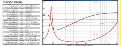

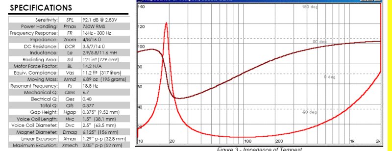

For a good example of a 6th order BP take a look at Dan Wiggins' suggestion for a pair of tempest drivers
here
When modelled against a pair of tempests in a sealed box of same size, the sealed box wins in max spl below 9Hz.
This is why I always end up back at sealed for the ultra low bass.
Rob.

Have you measured the T/S on those Tempests? Series tuned bandpass is very sensitive to parameter drift, so i wouldn't build one without measuring the driver's T/S and also running a impedance plot on the finished box to tune the two ports properly.
