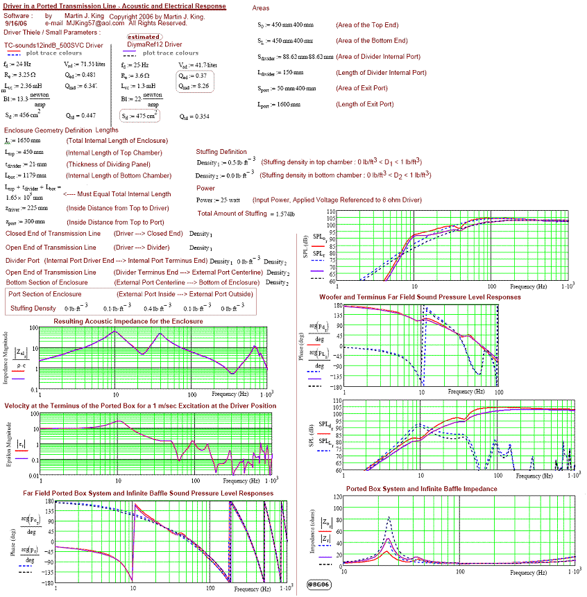

Rob,
How wild would it be to build a LabSub with a modern low-distortion driver? Even Danley has discussed having Eminence add copper to the motor.
Did you know that there's a 12" out there with parameters similar to the lab sub, but it has a shorting ring? On top of that, it seems to have something like XBL in the motor. On top of THAT, it's *cheaper* than the Lab12.
It goes without saying that it would be an attractive alternative to the LAB12.
Here are the params, if you're curious.

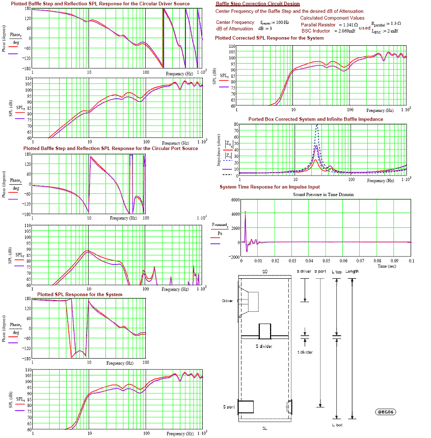

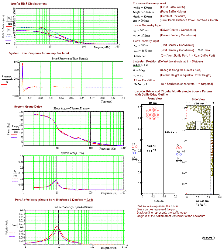

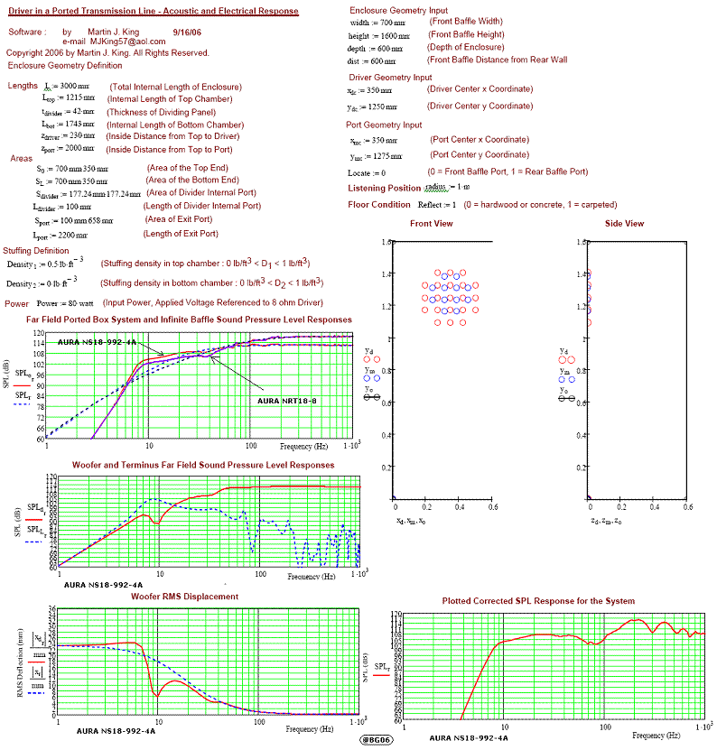

RobWells,
Post#373:
I think I may have the same goal as you, to extend the sub range to below 10 Hz and for that purpose use a dedicated single infra speaker.
This extension does not eliminate the need for preferably several subs placed for maximum room performance and also to maintain the important lateral cues covering from about 80 Hz down to the lowest room modal frequency at almost tactical levels for HT use.
Loudspeaker and listener positions for optimal low-frequency spatial reproduction in listening rooms. http://world.std.com/~griesngr/asa05.pdf, a must read and to take into consideration when seriously placing conventional subs for optimal result.
I have found that all other trials of explanations/approaches or instructions found at the Internet how to place subs or speakers covering the modal region are less useful in comparison with what Griesinger’s is stating, his insights in this matter is unsurpassed and I recommend all DIY’rs to read the paper more than once and contemplate and to discuss the content, maybe at this forum.
I made some experiments just before Christmas after finishing building a net 328 L closed sub with AURA NS18-992-4A for a friend of mine.
I measured with this speaker a useful –3 dB point for infra extension of my room close to 8 Hz at my listening position after equalizing the speaker and levelling out the room modals to about 80 Hz to as flat FR as possible.
With room gain included/+18 dB at 8 Hz I found that below 10 Hz my room is only capable to accommodate a maximum 90 dB SPL from an infra speaker before noise and rattling sounds from the ceiling and walls appeared very annoying.
The useful infra region for my listening room is thus the frequency bandwidth from the lowest room modal frequency (in my case; about 26 Hz) and lower and when including my room gain, there is no need for me to reach lower than f – 3 dB 8 Hz/ 90 dB SPL.
I started looking for low distortion drivers and less expensive than the $ 882 Aura driver and found two possible candidates that I simulated in a DBR enclosure to be used only in the infra region.
Placed standing straight up or laying down hidden anywhere in the HT listening room, I think this infra speaker will perform well and for most bass enthusiasts as expected. See the plots.
I’ve also modelled a ‘Giant’ box with the Aura driver for larger rooms.
See the plot.
Happy New Year!
