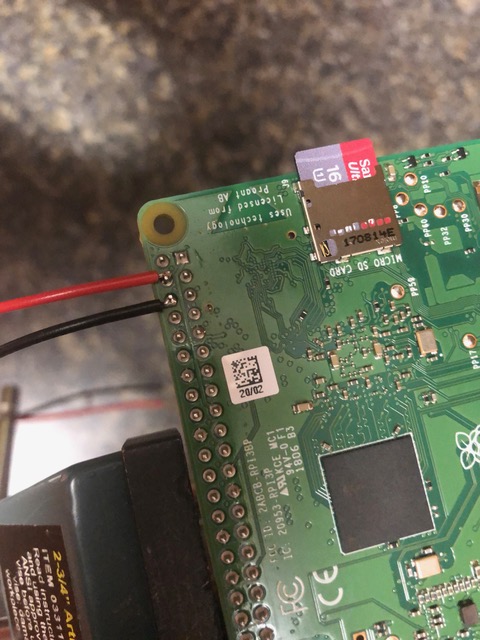

The second thing he did was try 2 different options to feed power into the RPi... either via the Micro USB or via the GPIO header pins (I've attached a picture of how he soldered the power wires onto the RPi header pins). His comments:
"In the past, with the Boss DAC and others, feeding the RPi through the GPIO header from the top sounded much, much better than feeding in through the microUSB connector on the RPi, and I suspected much the same with the Katana. But, as you know, there’s no access to the header from the top with the Katana.
So, I soldered a couple wires on the power and ground pins on the bottom of the 40-pin GPIO header on the RPi 3B+.
Upon listening, I have to say, the difference in feeding power wasn’t anywhere near what I had experienced in the past with other DACs. In fact, at this point, I could have gone either way on feeding power to the RPi, although there was a bit of a preference for the soldered connection.
Please note, many previous comparisons were with the 3B and not the 3B+. Still, I think the protection circuitry on the other side of the microUSB
connector is pure evil from an audio perspective. So, I ran through the SMPS and the iFi again, finding the same."

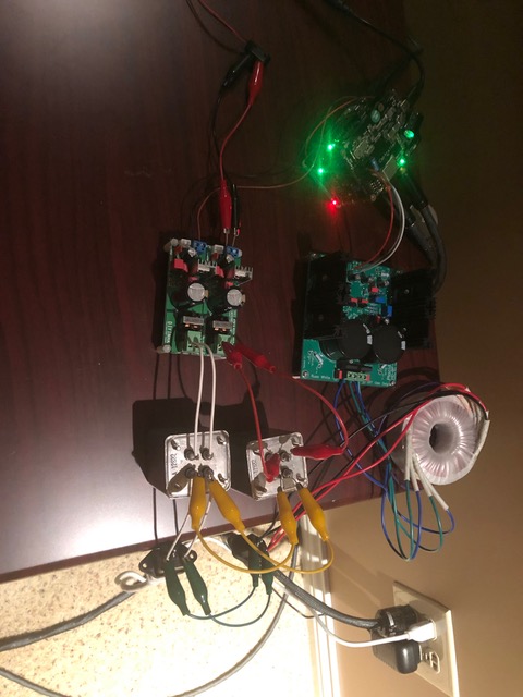

The third thing he tried was a another power supply to the RPi:
"Having satisfied myself on how best to feed power to the the RPi, I then tried a linear bench/lab supply now having a couple of wires to easily connect to. All I can say is WOW! This is a game changer. I’ve tried all sorts of supplies on the RPi in the past and this is the first time where I thought the difference with a linear supply was warranted and …. Well, you just HAVE to do it. With the current set up, it is as big a difference as anything to me. I’m committed to building a dedicated supply here."
Finally, he put in the Isolator 1.2 and had this to say:
"...I then introduced the isolator. Unlike my experience with the Boss DAC, I detected no initial detriment to the sound. Just, lower noise and blacker,
much as you describe. Again, I ran through the various supplies on the RPi just to be sure, finding the same. I also ran through a couple different regulators on the micro controller and the DAC, likewise confirming my preferences there without the isolator."
I've also added a photo of his setup as it is now.
I was just reading about powering the RPi 2B using an external supply a few days ago, and it was suggested (not in an audio application) that one uses the microUSB to include all the protection circuitry because – “The Pi2B has a polyfuse that limits input current to 2A, or a bit less. The recommend PSU for a Pi2B is 2A.” Surely a headless RPi will not be drawing a huge current driving a HAT DAC. If the protection circuitry on the other side of the microUSB connector is pure evil from an audio perspective – would you recommend that I feed my RPi 2B through the GPIO header (like shown above)? Can there be any risks in doing this?

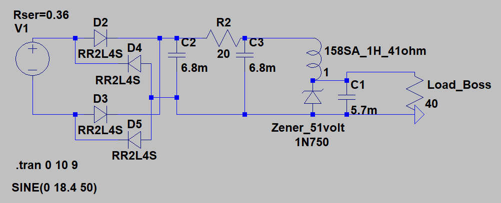

My 5volt Boss supply:
The toroid is a 80VA 12V. Because of the regulation, it generates a bit above 13 volts AC. Times sqrt 2, equals the 18.4 volt used for the simulation.
C2 and C3 are cheap caps. Only C1 is an audio grade (Panasonic). I think I bought a 10 mf (not 5.6).
After the rectifier it is 16 volt DC. R2 is used to finetune the current. After this R2 the DC value is close to 12 volt. And of course on the zener it is the zener value (this 1N750 is 4.9 volt I think, but I used a 5.1 volt zener). The current through the Hammond is 180 mA. The Boss draws about 120 mA (that is where the 40 ohm is coming from). The final PSU worked exactly as simulated. 🙂

Think some student trying to learn programming might get this power connection polarity backwards? Yep. And, I bet that's why it was included.
So, the other risk of connecting to the header is that you MUST get the polarity right. Otherwise, you'll likely damage your RPi2 - this circuit isn't there to save you.
The header connection is on the right of what we've been discussing in the schematic.
Now, you know the risks and the potential for sonic reward. Let us know what you decide and if you do move forward with connecting to the header, let us what you heard.

@Ralph G, thanks for the info on your choke/Zener supply. I’ll have to check the chokes I have around and if I don’t have any suitable, get some to give it a try.
