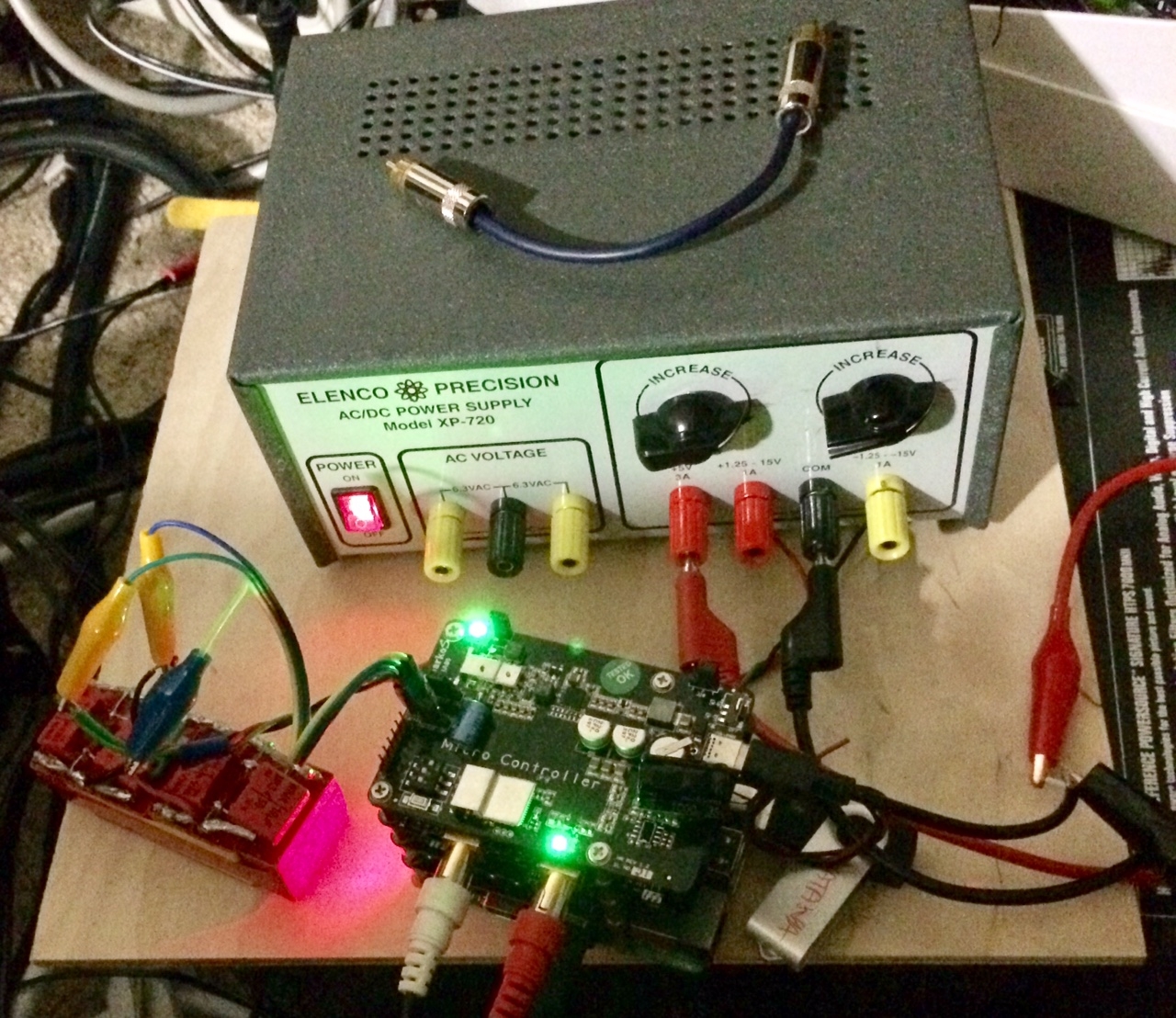

I have a picture of the test setup which I will attach below. I have an old, low cost test power supply I use sometimes. It has been slightly modified from stock. All the rectifiers were replaced with hexfreds, but any ultra-soft recovery types should work as well. The positive adjustable regulator used to be an LM317, but it was replaced at some point with an LT1086. The negative regulator is still an LM337. The fixed +5v regulator is a 7805.
I was trying to test the latest Katana 1.2 with 'thd' output board and isolator board installed. Hooked up the power supply and it still sounded kind of grainy, so I tried a trick that I found worked before for dac output stages which was to connect about 110uf of Wima stacked film caps to each of the +-15v rails. The caps are 10uf, 22uf, and 33uf all soldered and taped together, which is the rectangular red thing in left front side of the picture. That did the trick and the grainynes went away. Katana then sounded really good, best I have ever hear from it and pretty much as good as any ES9038Q2M I have heard. In case you don't know, I have been working on modding another ES9038Q2M dac for the past several months over in another thread, so I have been getting pretty good at knowing how to make them sound their best.
The adjustable supply is available as a kit online for as low as about $70, but the mods I did to it would increase the cost. Don't know how much they actually help either, but they are probably sensible types of things to do.
Lastly, the lower part of the isolator and the RPi were powered with an IFI +5v supply. The three linear supply outputs were used only for Katana.

I don't have a Katana (yet), but I have a Boss. I'm powering this one with a very simple Choke + zener + cap shunt (so instead of a shunting resistor I use a Hammond 158SA). This is very cheap and works perfectly. It is most likely noisy as hell (zeners are noisy), but it sounds nice.

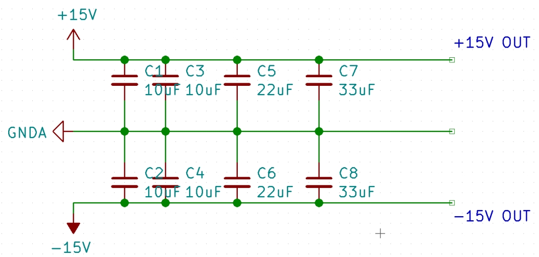

I said there are three linear power supplies, not three caps. The +-15v linear supplies have film caps. The +5v linear supply does not.
The four caps you see on top of the other caps are 10uf each. Underneath the 10uf caps are some 33uf and 22uf caps sitting upside down with pins pointing up. The caps are soldered together in two parallel banks with an equal number of caps in each bank. IIRC, there is a total of 109uf in each bank. The caps are connected between each rail and ground. Bottom line: each of the +-15v rails has 109uf of film caps to ground.

Would the attached image be a reasonable schematic of your circuit?
This will form a low pass filter with each cap being most efficient at a given frequency. It will take someone with more knowledge than me to figure out what frequencies are actually being filtered.
Here is the manual that contains the schematic for the Elenco XP-720 that is pictured
https://www.elenco.com/wp-content/uploads/2017/10/XP-720K_REV-J-2.pdf
My (meager) understanding is that R2 (150 Ohm) is the part of the PS to use, and this would give us filtering between 32Hz and 106Hz. I often get this sort of thing wrong though.
Either way, my point is that Markw4 was able to get his best results from his set up, and we should try to understand why. The XP-720 uses an LM317T with a simple voltage divider as a regulator circuit, and the humble 1N4001 for rectifiers.
This regulator makes no claims at all to being low noise, but it has a far higher amp rating than everything else discussed.
Marks $10.00 in parts (before his modifications) seems to outperform all the other (and likely expensive) options he has tried.
Poll any group of audiophiles and you will be told that this PS is a waste time, and only suitable for a Tandy 8 track player.
So, are we trying to get the best out of our Katana, or are we trying to spend the most money on it?
So, with all that said, I am very very interested in marks PS, and what has been done to it.

there is no way to achieve 109uF total capacitance based on a combination of 10uF, 22uF, and 33uf if all three sizes must be used.
Good catch. Correct total is 108uf: 33+33+22+10+10. Not that it matters with physical capacitors in this application. Chances are good they measure something other than 108uf, so 109uf might turn out to be more correct in reality. Nonetheless, they are soldered in parallel and the exact value is unlikely to be critical.
Your schematic is the correct basic idea. Just some caps in parallel on each rail to ground.
However, if you read what I wrote originally, there is no LM317 in that supply anymore. Rectifier diodes are different from stock too (and hexfreds are not so cheap). I also said that I don't know how much difference the modifications might make in this application with Katana.
joshua43214,
"each of the +-15v rails has 109uF of film caps to ground"
This means 109uF from +15v to ground "and" 109uF from ground to -15v, for example, your schematic has 75uF total (10+10+22+33) from +15v to ground and another 75uF total (10+10+22+33) from ground to -15v. With film caps your ok because they're generally not polarized, but with electrolytics, watch the polarity as they typically are.
Your sense or understanding of a "low pass" filter is pretty whacked. Sorry, just trying to help you understand...
Here's part of what is likely confusing you. Basically, from an "ideal" capacitor perspective, the capacitors in parallel simply add together. In other words, there's theoretically no difference between an ideal 75uF capacitor and a combination of ideal capacitors comprised of a first 10uF capacitor, a second 10uF capacitor, a 22uF capacitor, and a 33uF capacitor connected in parallel, for example.
However, pragmatically speaking, capacitor "packaging," e.g., the leads, the terminals, the container, etc., makes them less than ideal. In other words, a some frequency a capacitor begins to becomes inductive as well. The bigger the cap, physically and/or electrically, generally the lower the frequency at which this occurs. This goes to the ESR/ESL spec you see in cap data sheets. The "ratio" of the capacitance and the parasitic inductance, along with the ESR is described as the Q - a quantity without dimension. A cap that is hi Q will transition from capacitive to inductive very quickly or over a narrow frequency bandwidth, whereas a low Q cap will do so more gradually over a wider bandwidth. Obviously, the type of material used to make the cap matters too.
Such is a day in the life of a cap designer in making choices and design compromises.
So, in light of the forgoing understanding, what is often done is to parallel a number of capacitors of different values, taking advantage of the relative Qs and ESR/ESL. This is typically done in a decade format, e.g., 0.01, 0.1, 1.0, 10, 100, etc. in uF. This goes to pragmatically providing an "ideal" capacitor...
Some think this sounds good, others, not so much...
I think that is where your understanding comes from....?
The values the Markw4 chose doesn't go to that - the caps generally have the same order of magnitude... However, he chose "film" caps....
Looking at the schematic of the power supply....oh brother,....just no.
That resistor and the pot that it is connected to form a voltage divider that presents a selected voltage to the Vref pin of the regulator that in turn determines the output voltage.
With a regulator, you need to look at the data sheet and see what the output impedance is relative to frequency for the regulator. This is much, much less that that voltage divider.
Yea, that's just wrong...:>)
The thing that is really "bad" about the LM317, the T is a somewhat improved version, is that it doesn't really present a low impedance above about 1 kHz and you need to rely on caps for that function...which then goes to regulation and stability, etc. and pretty soon, you find yourself looking for a better reg, particularly with digital circuitry....
So, that's more where Markw$ is coming from.....
That help with your understanding???

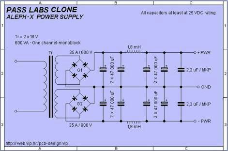

Note the 2.2uF cap in the attached image. Note there is no resistor on the rail to "complete" the RC circuit. This cap filters high frequency noise - it is a low pass filter. What remains is low frequency (Hz ~= 0) DC current.
Packaging and all that is pretty important, but it is meaningless unless put in the context of the fundamental characteristics of a capacitor. In other words it is a cap before it is a film/ceramic/electrolite/etc cap.
Hopefully this will clear up some confusion.
However, there is an inductor to make an LC circuit. :)
