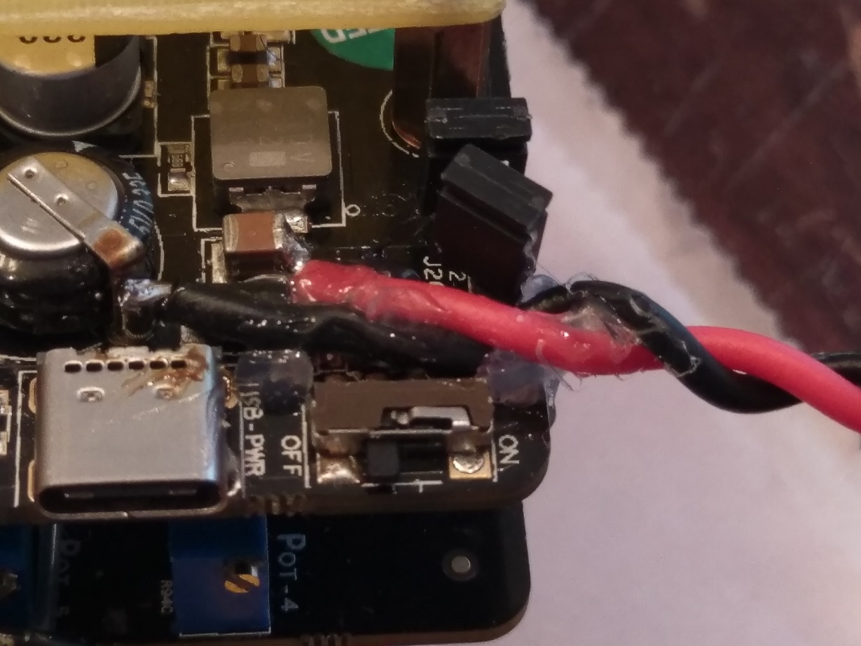

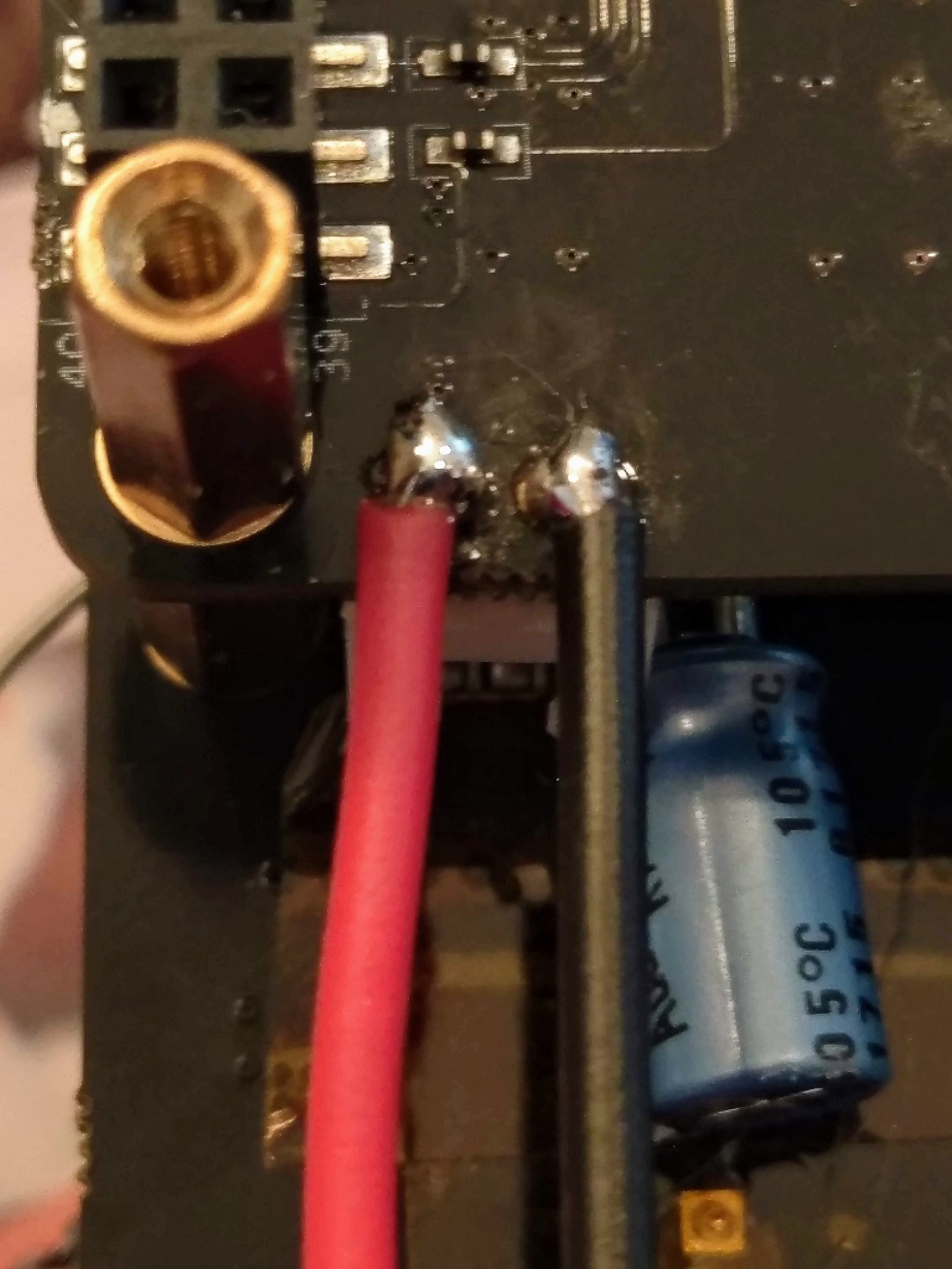

AND when connecting the 5v to the Microprocessor board directly to the supercap pins on that baord: "More of the same above, and particularly the soundstage width."
QUOTE]
I confirm that bypassing the USB3 connector and going straight to the supercap pins is definitely worhthwhile. You just have to be very careful, as Greg previously mentioned, when disassembling and reassembling the boards.

@jonners, thanks for the 2nd report on more-direct power connections to the Katana. When I first did a +-15V supply, because of my previous experiences that using the most direct connection will produce better results, I input the supply into the center pins of J28 & J29 instead of using J27 and then havine the rails go through jumper contacts. Just made sense. I'll be adding direct connect pigtails to the Katana I've been running in the next day or so... will post some pix.
Good point about using the centre pins, I'm now doing that.
Since that USB3 connector can be inserted either way it must be doing some switching of the supply which can't be ideal?
Anyway, since bypassing it I can now use 1000uF caps on both rails of my 15V PSU (instead of only one) and get it to connect.
First, I updated the 1st post in this thread with additional info on the power supply @jonners & @Fabio1068 are using. BTW, that supply got some good press over in CA here: A novel way to massively improve the SQ of computer audio streaming - Page 512 - Music Servers - Audiophile Style
Those posts had me soften my comments on it in the 1st post, but I still suspect use of it is for the experienced DIY'er only.
I also mentioned where I described how I separate the boards in the Katana to prevent damaging the inter-board connections.
@jrocker, I forgot to acknowledge your very informative response to @Jonathan P on transformer selection. Thanks for that!
AND thanks to both my 'audio friend' and to @jonners for reports on bypassing the Allo connectors on the Microprocessor and DAC boards. I did that today and listened a bit. What I heard was an increased sense of inner details, such as instrument and vocal textures. The buzzy-ness of the vibration of various strings, the vocal intonations that result from how we shape our mouths and hold our tongues and similar inner details were more evident and easier to hear. Also, as @jonners said, I also heard '... a slightly deeper sound stage and more ambient information.'
Not a huge improvement, but much more than a subtle one and well worthwhile!
What is interesting is that I did not perceive a reduction of background noise or blacker blacknesses. The Katana in my setup with my supplies and to my ears very good in that realm already AND MUCH improved over the inital version AND somewhat improved in its current incarnation over my earlier power supply setups. I'm guessing that the reduction of plug-in junctions AND increase in wire gauge provided a slight increase in the ability to pass dynamic current changes in response to the digital circuitry. Sonically, this sounded similar to other situations where I removed a power-supply plug-connection and replaced it with a hard-wired one and/or better wire.
ALSO, wiring this way bypasses a protection diode on the Microprocessor board... dangerous if you don't know what you are doing, but worthwhile. See @jrocker's write-up a bit back on the similar setup at the MicroUSB on many RPis.
Well worthwhile, though I rate this an 'experienced-to-expert' level modification to the Katana. It takes some care to ensure you don't short or dislodge any of the parts used for the connection points AND you have to know how to confirm you did it right before you power up!
I used my standard Deans high-current plugs for the connectors (these are from my model aviation hobby) AND Audience 18g hookup wire for the wire. On the Microprocessor board, I soldered the - to the - lead of the supercap and the + to the + side of the nearby ceramic cap. An alternative for the - lead is to solder to the metal outer case of the USB-C connector... that is what I did on the Boss 1.2.
On the DAC board, I soldered to the lead stubs from the Allo-provided power connector jack on the bottom side of the board, keeping the power connector intact.
I strain-relieved both with some hot-melt glue... you see that in the attached picture of the Microprocessor board connection, but not in the DAC board picture (I did that right after that picture). Ugly, but effective.
ALSO note that this is a board that I modified based on direction from Allo during the Katana-development listening tests I did. SO the added caps are not the same or even in the same places as what everyone else has. Better or worse? Don't know, I have tried going back and forth. BUT this is the Katana I've used for most of my listening.
AND of course, as with anything like this, your ability to hear the effect of this modification AND appreciate it will be system, person, and personal preference-dependent.
