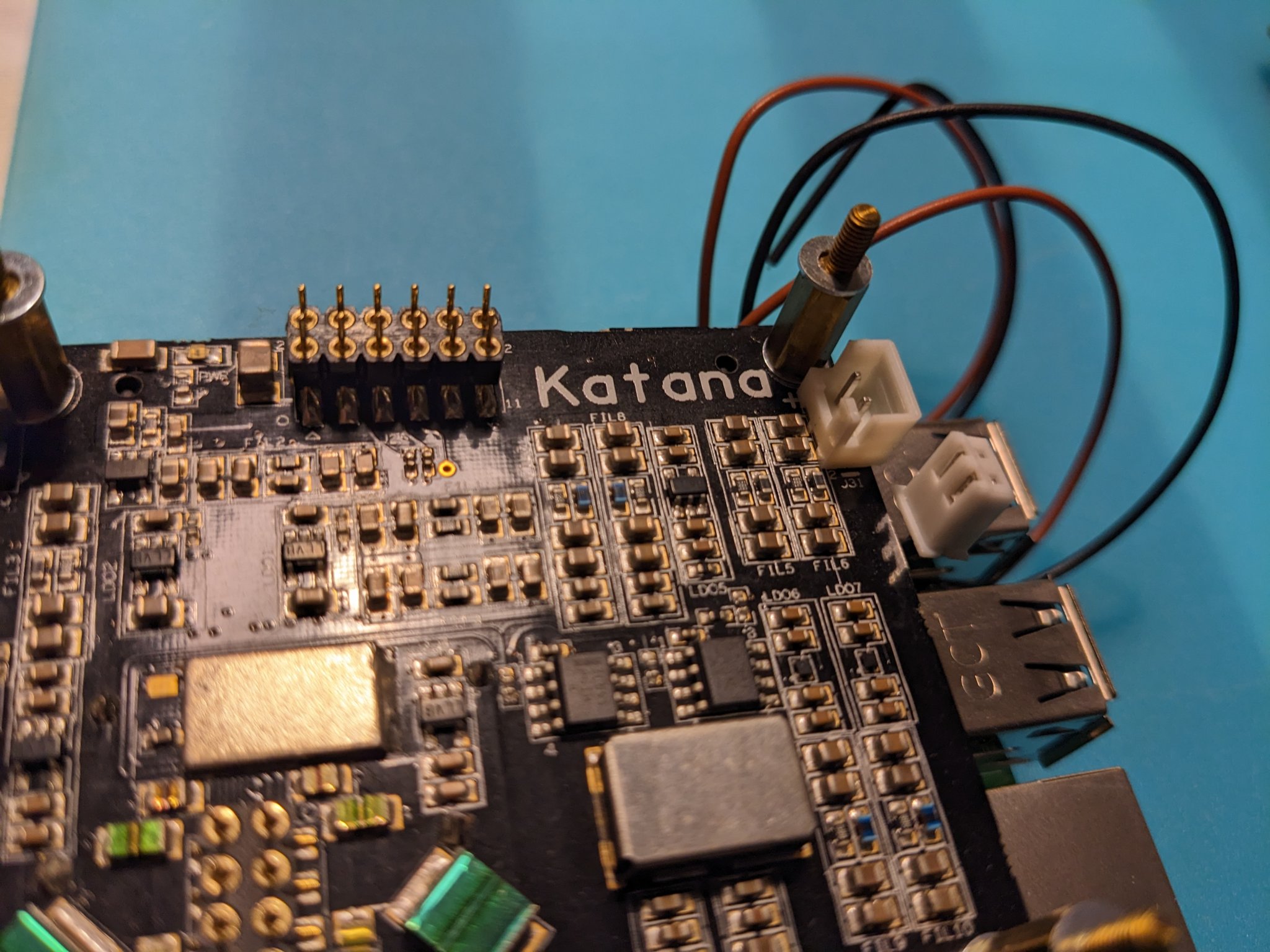

Sorry if the question is too trivial, but what is the name / brand of the white plastic power connector on the Katana circuit board ?
There is a corner broken at my connector, I would like to replace it and need to know the name of it.
For me it looks different from a Molex connector, or am I wrong?
Christoph
There are things like this: https://www.amazon.com/gp/product/B0731MZCGF/ref=ppx_yo_dt_b_search_asin_title?ie=UTF8&th=1
However, they are a type of JST connector. There are a number of different sizes of the pictured series of connectors, depending in pin spacing.
That said, looks like Allo connector may be a little different. If so, don't know if they are compatible with the JST parts.
Some of the different pin spacing sizes look yet a little different from other pin spacings:
https://www.amazon.com/gp/product/B0B2R966ZY/ref=ppx_yo_dt_b_search_asin_title?ie=UTF8&th=1
