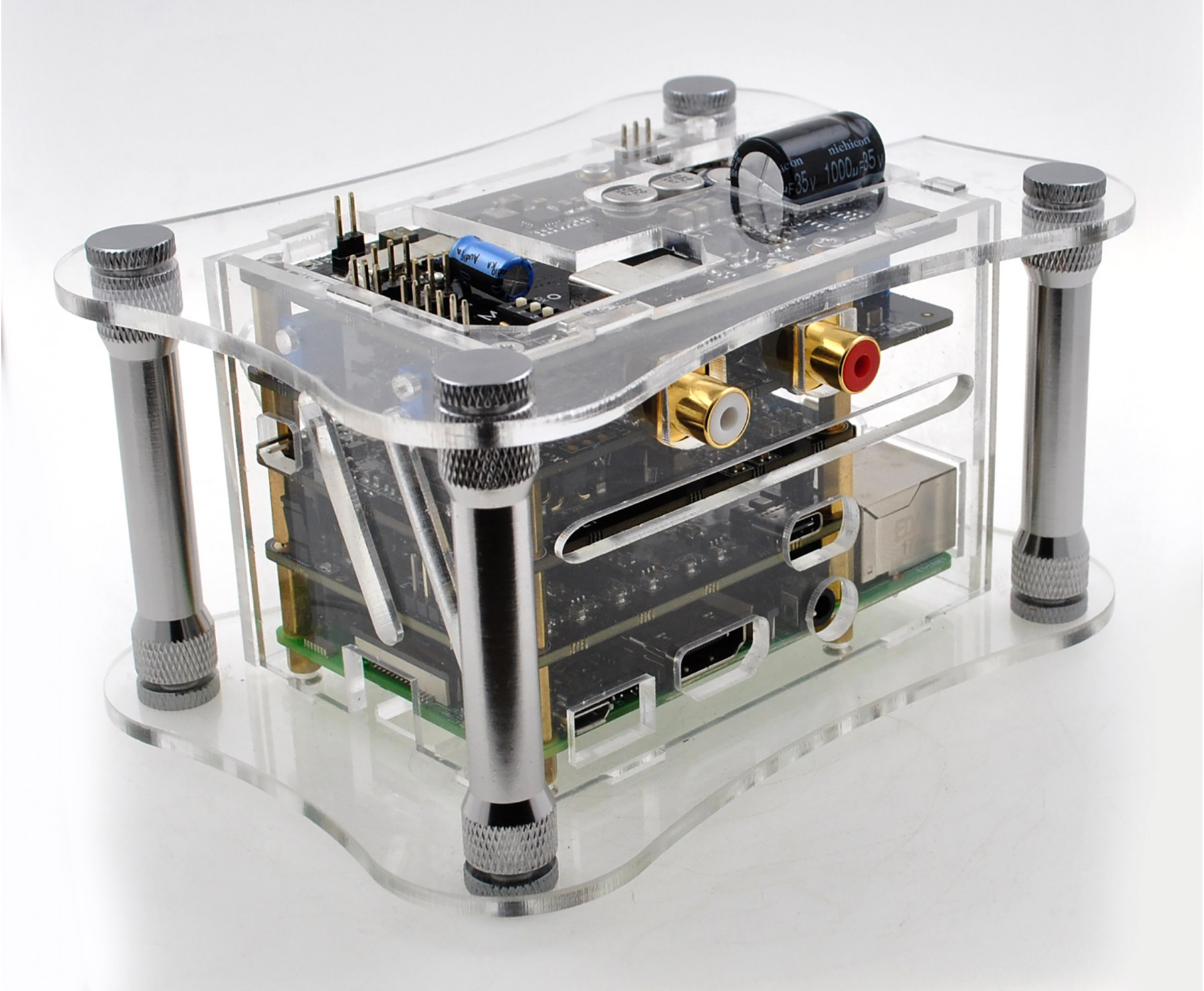

My Allo katana has stopped working since yesterday.
I use a 5V and +/- 15V power supply.
I can't hear any sounds even though I can control everything from piCorePlayer as before.
After changing the +/- 15V power supply to the internal one on the controller board, there is a low sound but very distorted.
The controller board is then very hot.
Can someone tell me what could be damaged and how to fix it ?

Replaced RPI with new one and still same issue via wired connection. All ended up when I got replaced my router. Called SparkLight (local internet provider) and complained about some disconnections. Tech guy came
and swapped my old ( one year old) router with new model. Done. Issue is solved.
