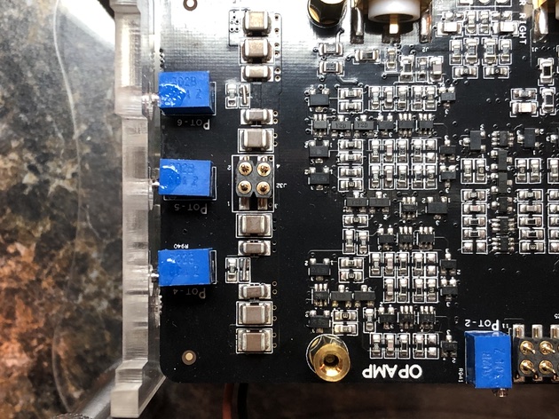

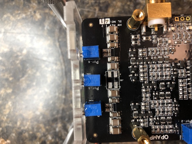

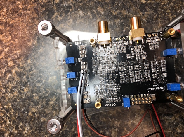

Not much Katana news out there, apparently. I've been working on different projects around Ian Canada's latest GB, so not a lot of time for Katana play in the last couple of weeks and likely not for the next 2-4.
BUT my 'audio friend' asked some questions about where to feed +-15V to bypass the on-board LDOs. I told him what others had done AND when he looked at it, he came up with what I think is a very good and clean way to do that... it's what I'll copy when I do it on mine.
He removed J32 (and the added 1000uF/35V cap) from the Opamp board and wired his +-15V feed (and ground) right there. At first, he dialed that back to +-14V... I reminded him that the Sparkos opamps are good with +-22V, so he'll take it back up to +-15V at some point.
By doing this, he not only uses the most easily-accessable direct path to feed the +-15V (and ground, of course), but he also bypasses the traces on the Microprocessor board AND does not have the outputs of the +-14V regulators being driven by his +-15V feed. Nice idea!
Here's his comments...
"Just got home. Took a quick listen to refresh. Power the Katana down. Pulled the micro controller off the stack.
Looks like 4-pin connector between the micro controller and the op amp board carries the output of the +/-15 VDC to regulated +/-14 VDC…
It is labeled J32 with Pin 1 as +14VDC, Pin 2 as -14VDC and Pins 3 and 4 as Ground.
Oh yea, that 1,000uF/35V cap that is “glued” to the top of the micro controller also connects to Pins 1 (+14VDC) and 2 (-14VDC).
So, not wanting any of what was on the bottom of the micro controller board - regs, caps, added glued down cap, etc. I pulled the J32 connector off the opamp board.
And, I added wires that I could then attach to my +/- Twisted Pear Placid HD power supply. I then adjusted the supply for +/- 14VDC and gave it a listen….
Ah…this is something that needs to move to the top of you list. Cleaner, clearer, quicker, more bass authority, blacker, quite a bit so, - just do it…."
When I do it, I'll attach my wires to the nearby +-14V local bypass caps as that helps prevent pulling off the pads (as those caps are attached at 2 ends, they are a LOT harder to pull off). AND locally strain-relief my wires.
I also suggested he do a quick try with/with-out the 1000uF/35V cap. He did so and had these comments:
"I hear ya on the 1,000uF/35V cap - nope. Tried it. Yuck. Just like always. When you have a CCS/shunt regged supply, you really just don’t want “anything” after it, or between it and the load in my experience."
I attached his pix below.
So there. What sounds to be another great Katana mod. And DO realize it is a mod... this is DEFINITELY taking your Katana into the 'user-modified' space and out of warranty! Not that I have any issues with this personally, but you might.
How about removing the socket on the controller board instead, and wiring to the Opamps at the pins on J32? Or would that be a bad idea?
Edit: I'm asking this after looking at a picture of the controller board rather than the real thing, so maybe it's not even possible?
Joined 2003
@jonners,
This is a good place to use 2 soldering irons, one on either side to heat up both pairs of leads at a time. When doing the original SQ mod according to Allo's instructions, I DID do this by heating up one side and using a pair of pliers to bend that side away from the pads. Careful, the plastic spacer is not very heat resistant. I'll see if I can get the PN for these from Allo.
Also doing what you suggested by removing the microcontroller board socket and wiring to the J32 connector pin bases would work well too.
Greg in Mississippi
Thanks Greg.
I have now wired my +-15V supplies this way, and without the !000uF/35V cap. First impressions are certainly 'cleaner, clearer, quicker', as noted by your 'audio friend'.
I measure the DC offsets with the +-15V supplies, and they are 0.3mV and 2.2mV.
Edit: Yes, better bass too. This is definitely the way to go! :)

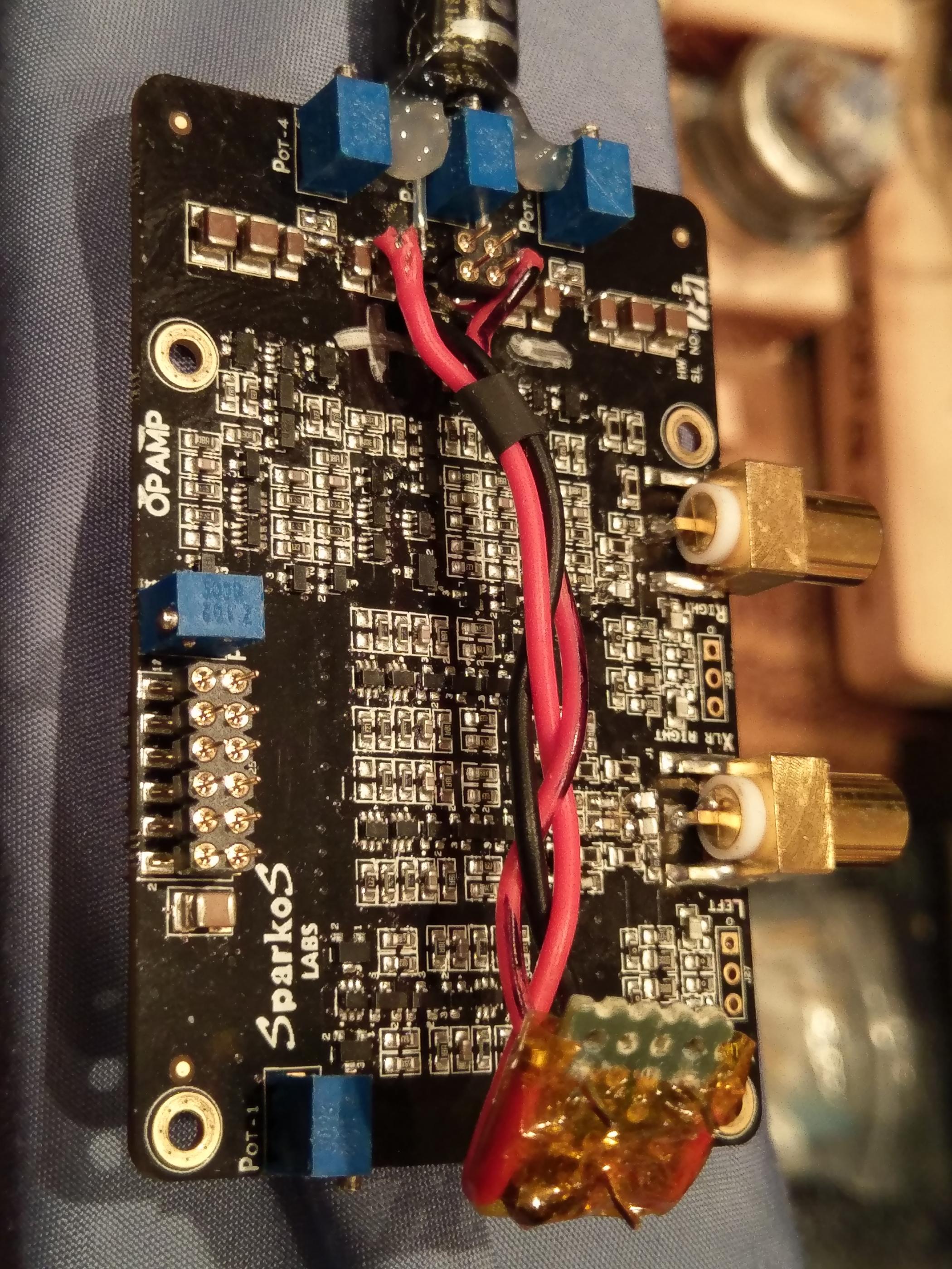

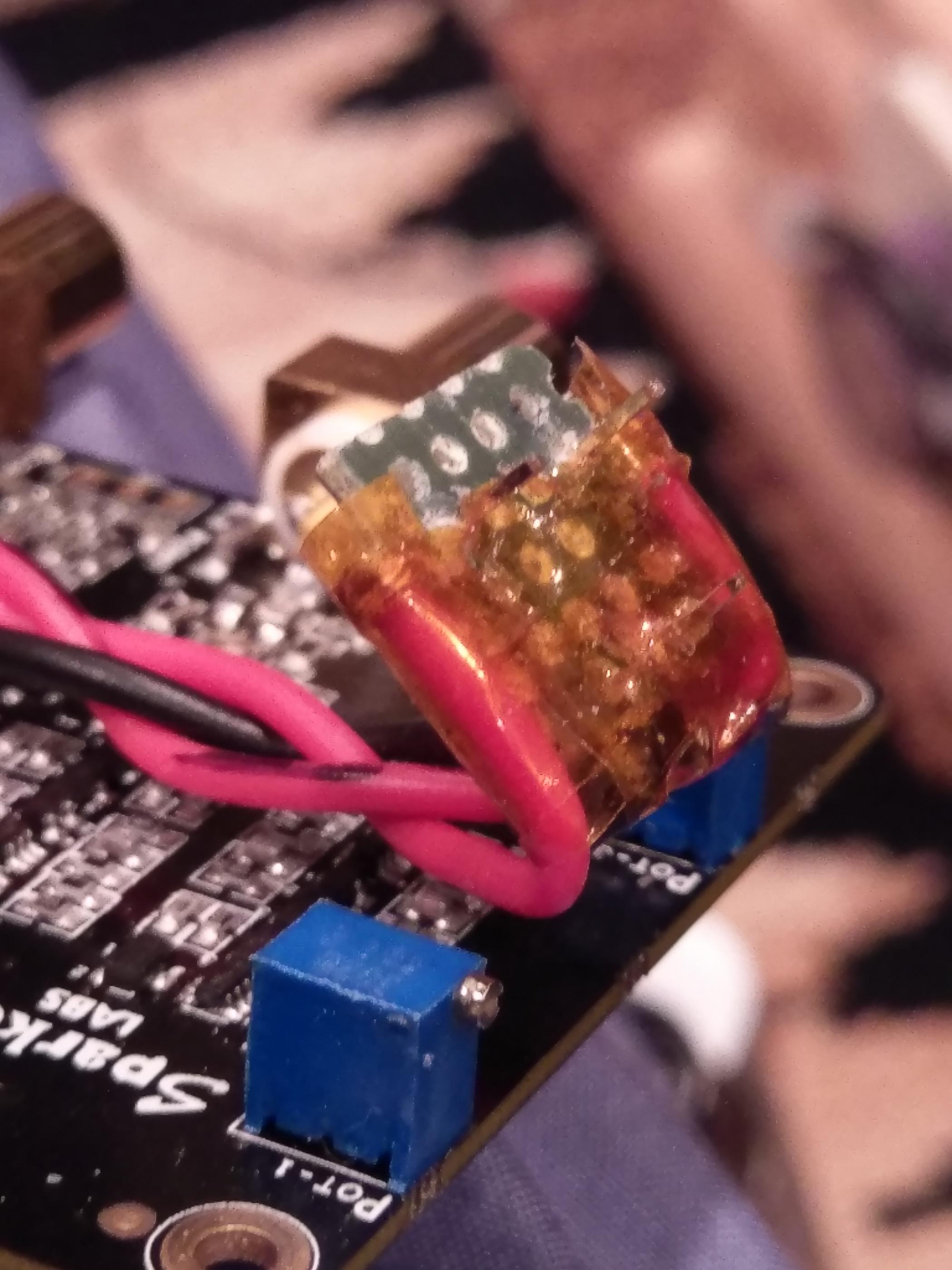

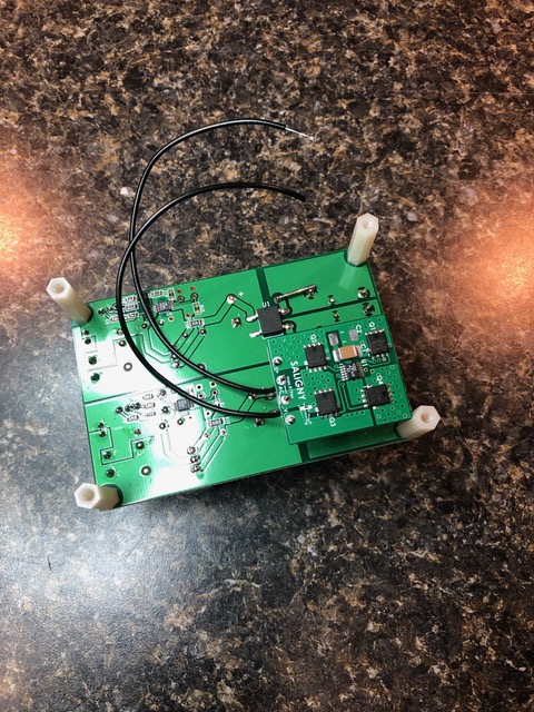

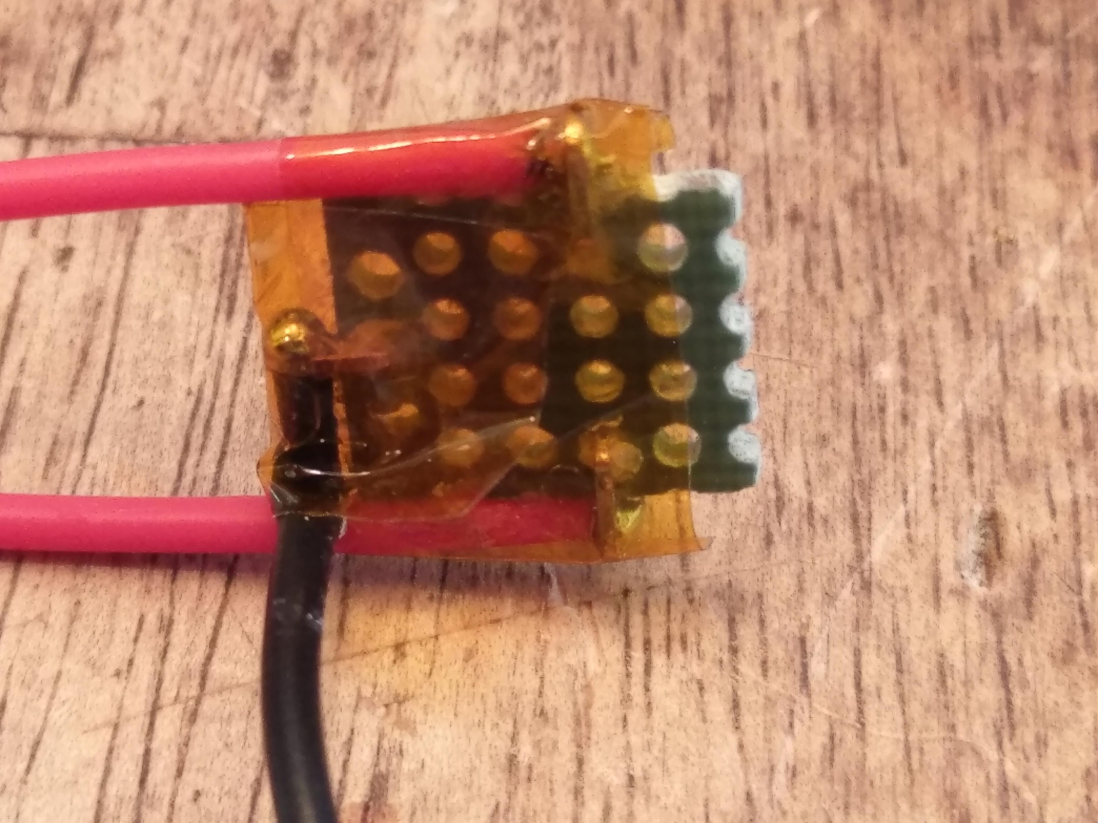

I've had an interesting experience over the last couple of weeks. I configured a Katana Microprocessor board and 2 Opamp boards for direct +-15V, bypassing the Microprocessor board's +-14V LDOs, which BTW are confirmed as TPS7A19 positive and TPS7A3001 negative.
To retain use of my +-15V Sparkos regulator add-on board, I crafted a couple of adapters. First, I removed the +, -, & ground pins on the Microprocessor board. Then I used a piece of perf-board to craft an adapter that fit over the remaining pins AND carried those 3 pins. I soldered hookup wire to those pins on the adapater and routed the wires around the edge of the board on that side and down over to the connection points on the Opamp board. Of course, everything was appropriately insulated as needed.
To swap between the 2 different Opamp boards, I remove my +-15V Sparkos reg board, lift off the Microprocessor and the adapter off the remaining pins, remove the Opamp board, and reverse the process.
This allowed me to keep the same +-15V regulators and attachment points for this configuration, my stock 'developmental' Katana, and the beta version of a representative production Katana. This meant I can compare these setups in a somewhat controlled manner.
When I first did this, I also removed the 4-pin connector on the bottom of the Microprocessor board that formerly fed the +-14V / ground into the Opamp board. AND I removed the 1000uF/35V C, but not the 2 smaller 100uF C's. Note that because I had modified these Opamp boards back during the development of adding that additional filtering, mine were all connected on the Opamp board with minimum length leads. BUT that configuration would not fit in the existing case, so Allo repositioned the caps into the current production configuration.
I tried it. I could hear some improvment in the naturalness of the highs, but otherwise it was anemic and recessed sounding. HUH, not was my 'Audio Friend' and @jonners reported, AND not what I expected. I put it aside for awhile to start running in the Ian GB items I had just received, but listened to it again last weekend and if anything, the deficiences were more audible. I swapped in the stock-ish 'developmental' Katana I have and the sonics I was used to were back.
Hmmm... why? Grasping at straws, I considered:
- Maybe those Sparkos regs weren't so hot?
- Maybe my close-coupled very direct routing had some weakness?
- Maybe my use of 18G wire was inferior to the circuit board traces, though I was sure the wire had more copper cross-section?
AND then I hit on what I thought were the likely culprits... EITHER NOT having retained the ground connections on that 4-pin connector OR removing the 1000uF cap.
So I replaced the 4-pin connector on the Microprocessor board, but with Kapton tape under the +-14V pins to prevent them from connecting. AND put the 1000uF Cs back.
Note that I used different types of C's on those 2 different boards... One had the originally-recommended by Allo 1000uF/50V KW series Nichicon as the larger value and 100uF/35V KA Nichions as the smaller values. The other was an experiment I'd mentioned recently, using same-value United Chemicon KYB caps in each of those positions. I don't remember which caps Allo used for the production version... I know the 100uF ones were a different line than the KA series and I believe the 1000uF was different than the KW they originally recommended too.
With both of these changes the sonic deficiencies were fixed. NOW I had more finely deliniated (and slightly less promenent) highs along with better
definition and lower background noise across the spectrum, making it easier to listen too. AND sonic textures were more evident. NOW it was a definite improvement and another lift in the SQ of my modified Katana setup.
Why was mine different? Honestly, I can't say for sure. I suspect using a higher-spec 1000uF cap than Allo used in the final mod version was a factor.
AND I also suspect based on my read of the Sparkos datasheet that those 3 relatively large electrolytic caps are tolerated by the Sparkos regulators well, which may not be the case for the other regulators. At some point I'll try removing either the connector or the cap, try it, then replace it and remove the other. Also, going back and forth between these 2 Opamp boards, I suspect IF one can leave that cap in without causing problems for your regulator, the quality of the cap will be very important. I'm preferring the UCC KYB more now, it was a trade-off between these 2 cap sets before. IF your regulator tolerates significant output C well, that may be a good choice for trying Markw4's recommended film cap bank.
Pix attached include close-ups of the adapter board and how the adapter is fitted to the Opamp board.
BTW, the way I did this mod took a lot of 'craftsmanship'. I don't think I could have crafted the board without the years of experience I have in designing and building model airplanes. I don't recommend trying to duplicate this configuration unless you are good at this type of small, restricted access work.

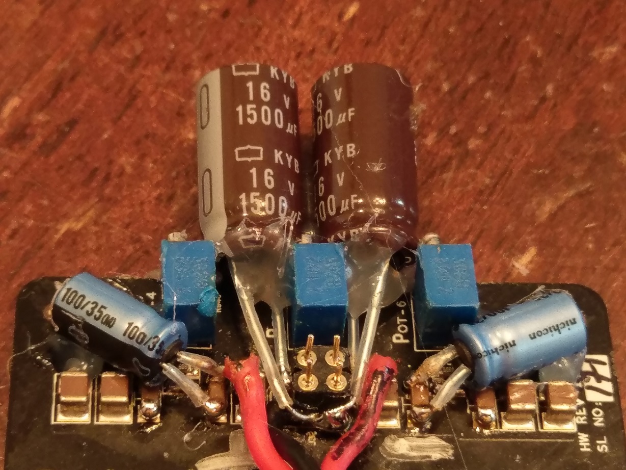

I hard-wired across the jumpers (DAC board and Isolator, I'd forgotten about the latter) today along with replacing the 3 stock-ish rail-to-rail Cs with 4 rail-to-ground Cs.
For the Cs, I used a pair of 1500uF/16V United ChemiCon KYB series (yes, I know 16V on a 15v rail is cutting it close!) and re-purposed the pair of 100uF/35V Nichicon UKA from the original trial of this mod. See attached pix.
Initial impressions are positive. I detect an increase in definition top to bottom due to deeper inter-transient silences and blacker-backgrounds. I want to give the modified board some time to run-in and then go back and forth... I did this on a 2nd opamp board, so I can swap and compare pretty easily. I honestly was not expecting what I heard.

Just a few recent upgrades to my Katana setup and I'm quite happy with them...
First, I added a 3rd iFi iPurifier to the setup where I have the Katana playing. I already have a fairly extensive and effective AC filtering and regeneration regime in place, not only at my systems' AC inputs, but also at various noise producing AC-powered items in the house. BUT I could hear the iPurifier doing its magic reducing the almost-always-present high-frequency hash on today's SMPS-dominated AC power lines. I now have 3 in each system and they are both better for them.
Second, a few months back a mentioned trying a pair of 6||LT3045 boards from MPAudio replacing the 3||LT3045 ones on my 5V DAC and Microprocessor board supplies. While I liked what I heard, it was a tiny bit of a mixed bag, mostly because I had optimized those 6||LT3045 boards for use as 15V supplies to try on the Opamp boards. A few weeks back I finished up a couple 5V versions and have had them running since. No longer a mixed bag, these are definite upgrades to the 3||LT3045 boards. At almost 150 Euro each, these are not low-cost upgrades, but the benefits in dynamics, overall definition and especially treble purity and clarity are very worthwhile. Still, I'm very curious how they will fair against the soon-to-be-released Allo Shanti dual 5V supply. Will report back once I have one here and broken-in.
Third, although I haven't tried them yet, my 'audio friend' and I got some 'ideal diode' boards from one of the GBs here on DIYAudio. While I haven't had a chance to try them yet, he put one in the supply feeding his Katana's DAC board. No full report yet, but his comment was 'sonically gobsmacked'. See attached picture of the board in his supply.
So another upgrade path worth looking at.
