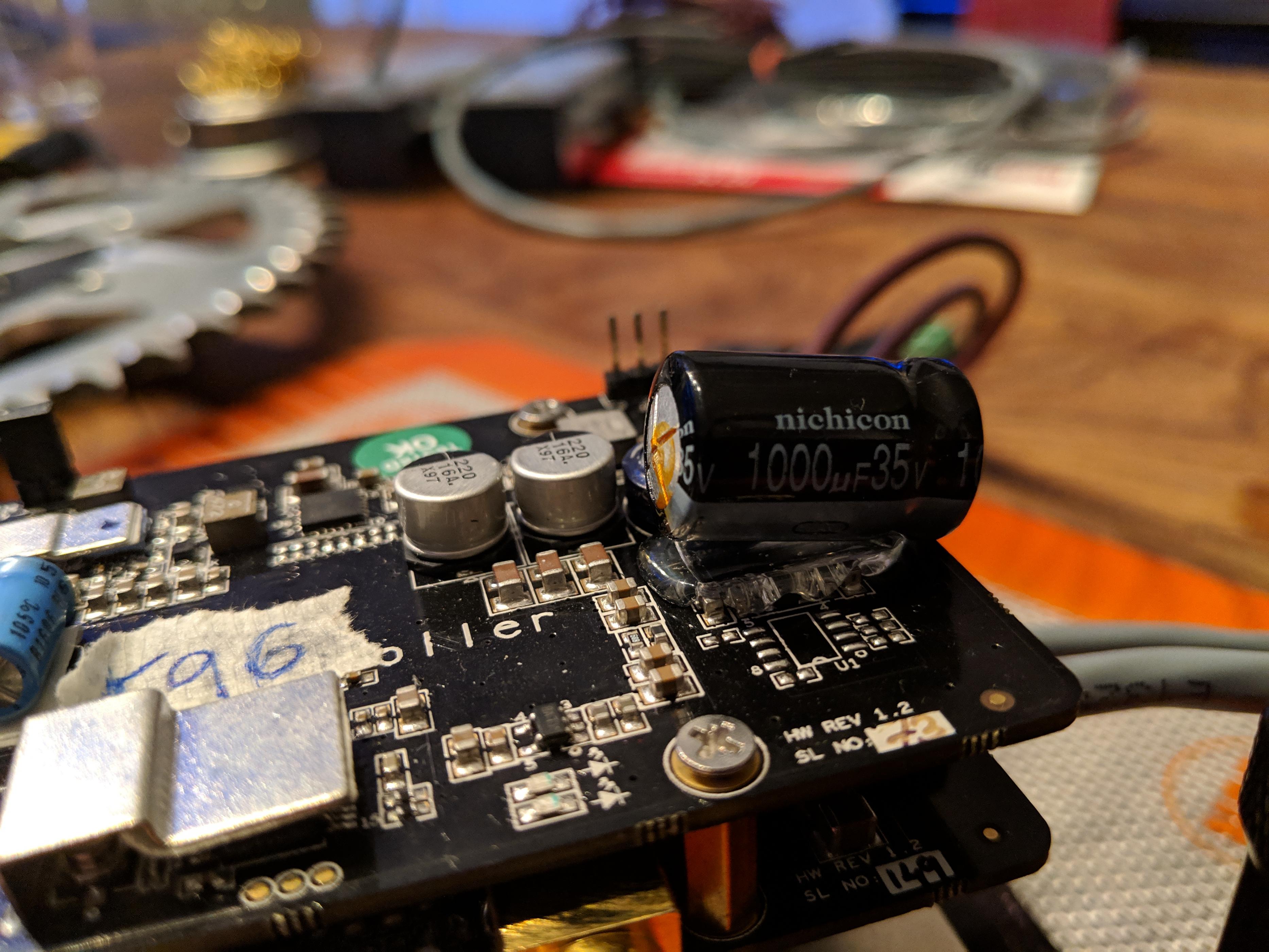

As for bypassing the USB-C connector AND the protection Diode, I connect the positive lead where the single ceramic cap next to the Supercap is soldered to the board. The positive side is the one on that cap closer to the edge of the board, BUT always use your meter to confirm both the positive and negative sides before you solder and power. I've attached pictures that should better show where and how I soldered the flying leads. BTW, the wire I tend to use nowadays for purposes like this is the Audience Auric 18g hookup wire from PartsConnexion, which is also the wire used in the leads of the Auricaps.
On where to go next on getting the best out of your Katana, I'd suggest looking at replacing the iFi's. See what other's have used and liked as possible alternatives. Also look at grounding... I commented on what I do in post #126. What you are observing on the ground of the Placid is a little concerning... also may be good to take to the TP support forums if it persists after you better attend to grounding.

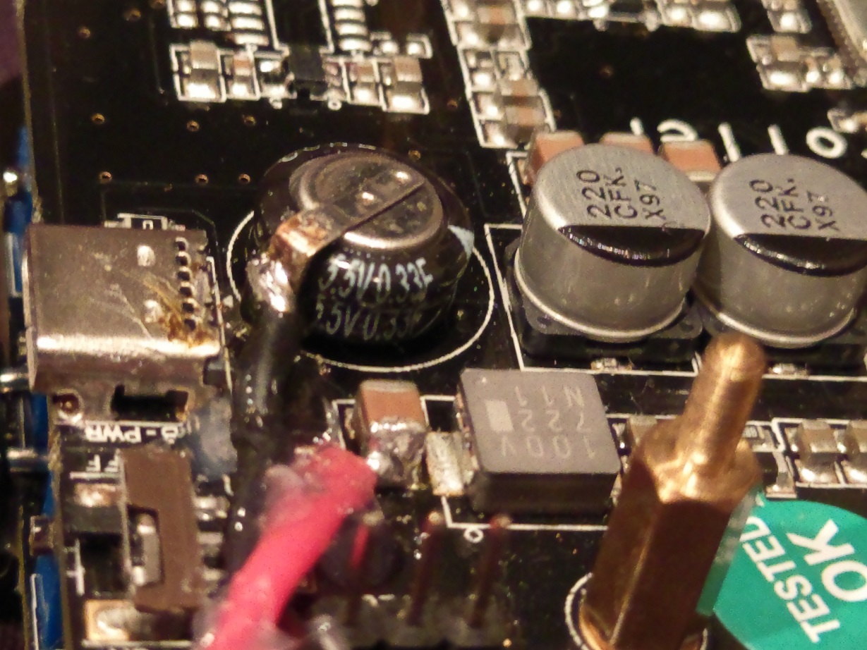

Just wondering the difference between these connection points (under the MC board) vs the the ones on top of the board. Do they both bypass the Common Mode Choke?
Also, about bypassing the usb connector on the Isolator, did someone post details on how to do it or did I dream? Can’t find it anymore 🙁
Thanks man, will definitely look into that! BUT maybe I’ll wait until you come back to us with your recent findings before I replace my 3 5V supplies (2 iPower + 1 allo)!On where to go next on getting the best out of your Katana, I'd suggest looking at replacing the iFi's. See what other's have used and liked as possible alternatives. Also look at grounding... I commented on what I do in post #126. What you are observing on the ground of the Placid is a little concerning... also may be good to take to the TP support forums if it persists after you better attend to grounding.
Finally, 2 more questions bothering me…
1- I noticed the top of the big cap on MC board is a bit swollen with some yellowish liquid on it. I cleaned it a few days ago and it doesn’t seem to leak anymore (maybe this came from somewhere else?). Do you guys think I should still replace it?
2- Did you guys experiment with [url="https://www.mouser.ca/ProductDetail/3m/ab5100shf/qs=gMfM3zrbS4r0qTugzC4tdw==&countrycode=CA¤cycode=CAD”]EMI absorbers[/url]?
It seems obvious this can make a difference but it also seems prone to make things worst by causing other problems if not used/positioned properly….
I was thinking to wrap some around to protect the Katana from external EMF but also internally, like say on the DAC and NDK oscillator chips and between the RPI board and the rest of the stack.

You should contact Allo warranty service about the cap. It is bad if leaking or changing its shape.
@Markw4, Thanks, will do.You should contact Allo warranty service about the cap. It is bad if leaking or changing its shape.

Contact us we will replace the board or provide you with a cap if you can install yourself.

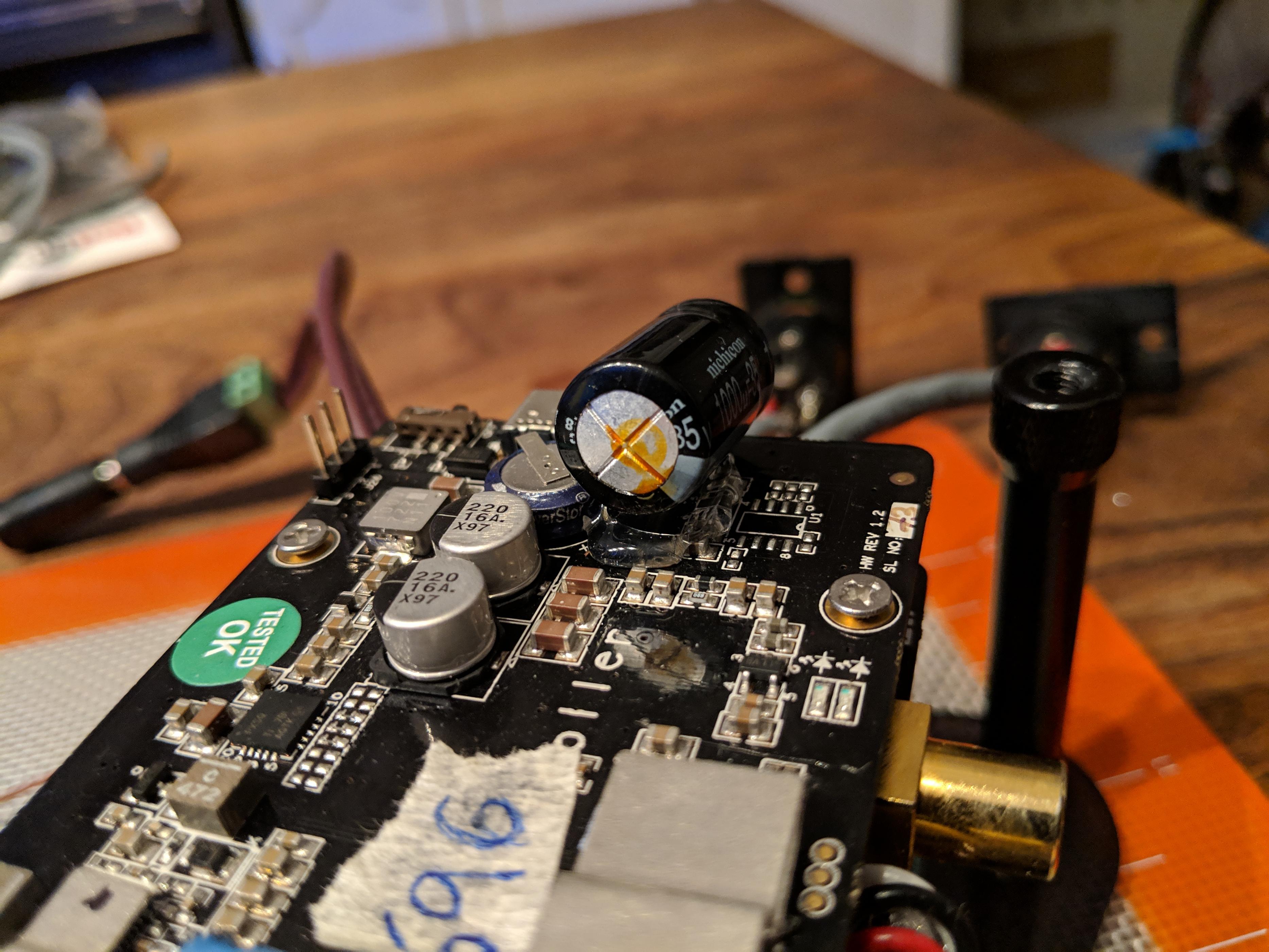

On connecting in the rebalancer, you should check the spots you mentioned where the Katana Opamp board RCA connectors with your meter to confirm which of them are ground and which are hot. Then you'll know where to connect your rebalancer. I'm not trying to harp on this, but it is an easy thing to check and one of those things you ALWAYS want to be sure of before you start modifying or making external connections to a board. So just a friendly reminder. Let us know what you find.
In a similar vein, you wrote the following about where you connected your 5V external power feed into the Katana Microprocessor board:

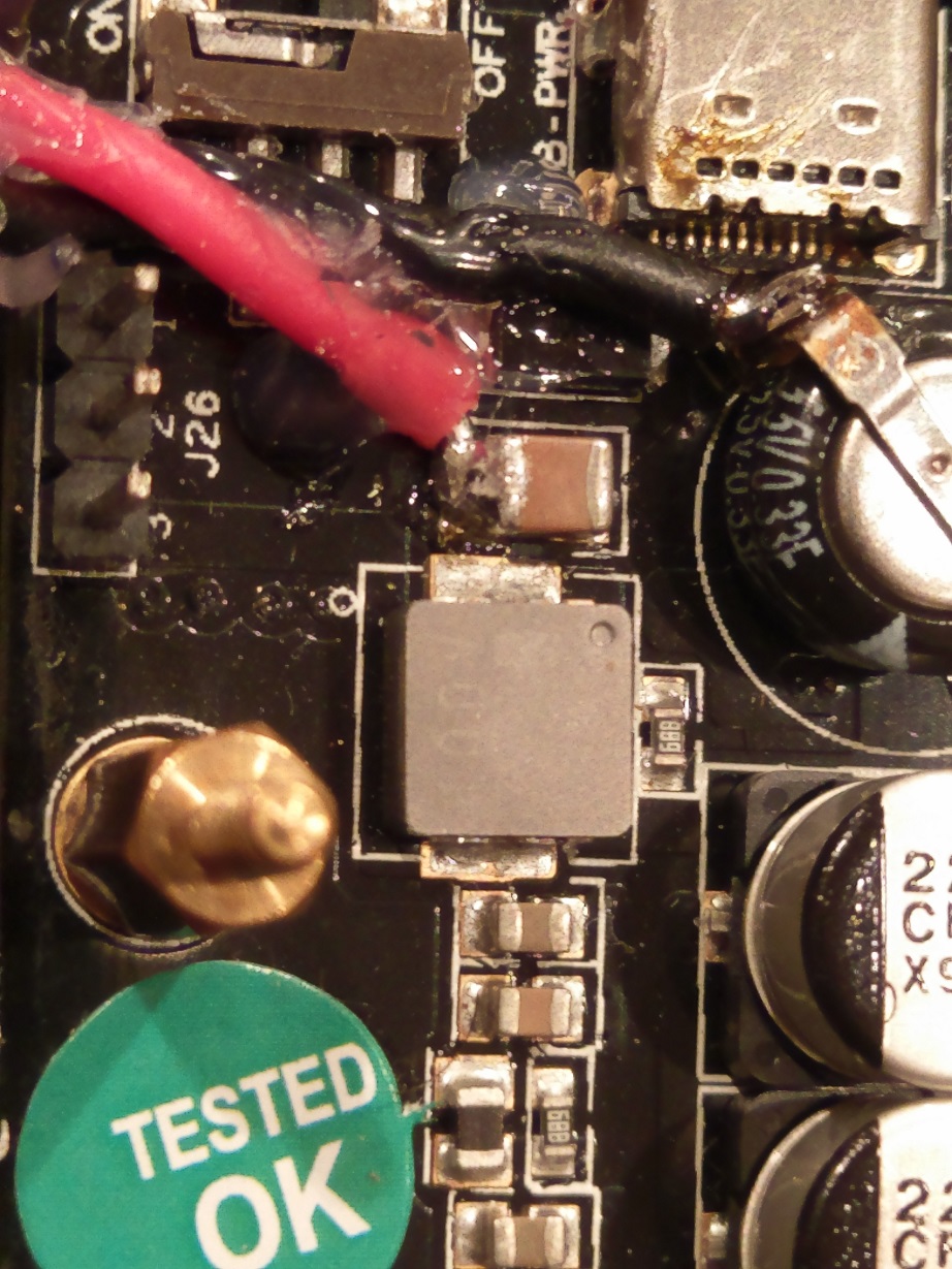

I believe @jonners and you are referring to my post #217 (BTW, I use post numbers to indicate different posts because a link will not work correctly for everyone). If you are, what I wrote there was:
So I soldered to the BOTTOM of the DAC board and to the TOP of the Microprocessor board. You CAN connect the external 5V to the bottom of the Microprocessor board at the + & - of the supercap. There are not any other obvious 5V connection points on the bottom of the Microprocessor board.
All of this has me question where you actually connected your 5V to the Microprocessor board since I did not show a bottom connection for that board? Can you clarify, perhaps with a picture? Likely it is just a mis-communication.

Ok then, your SE RCA cables are actually Audioquest cables from their Mackenzie line. Very curious what you find if you get a chance to build and try a set of BAL cables made with the Furatech components. Again I've heard some good reports on their raw cables and connectors.
...On the Microprocessor board, I soldered the - to the - lead of the supercap and the + to the + side of the nearby ceramic cap. An alternative for the - lead is to solder to the metal outer case of the USB-C connector... that is what I did on the Boss 1.2.
On the DAC board, I soldered to the lead stubs from the Allo-provided power connector jack on the bottom side of the board, keeping the power connector intact.
@cdsgames, I contacted support but I'm still waiting for details as per what I dshould do. Here is the response I got so far:
