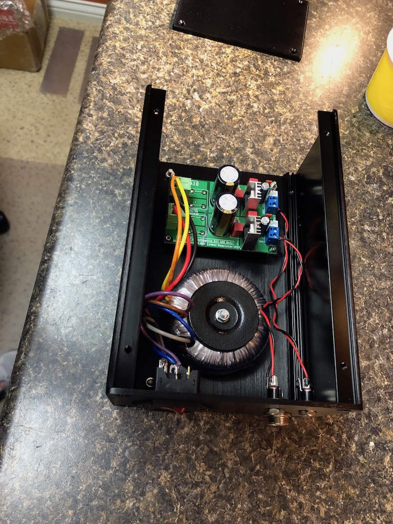

Where are the rectifiers/diodes?
Where are the pass transistors?
Are they hidden under the PCB?

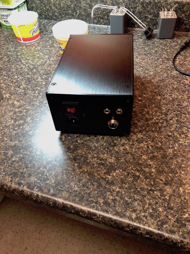

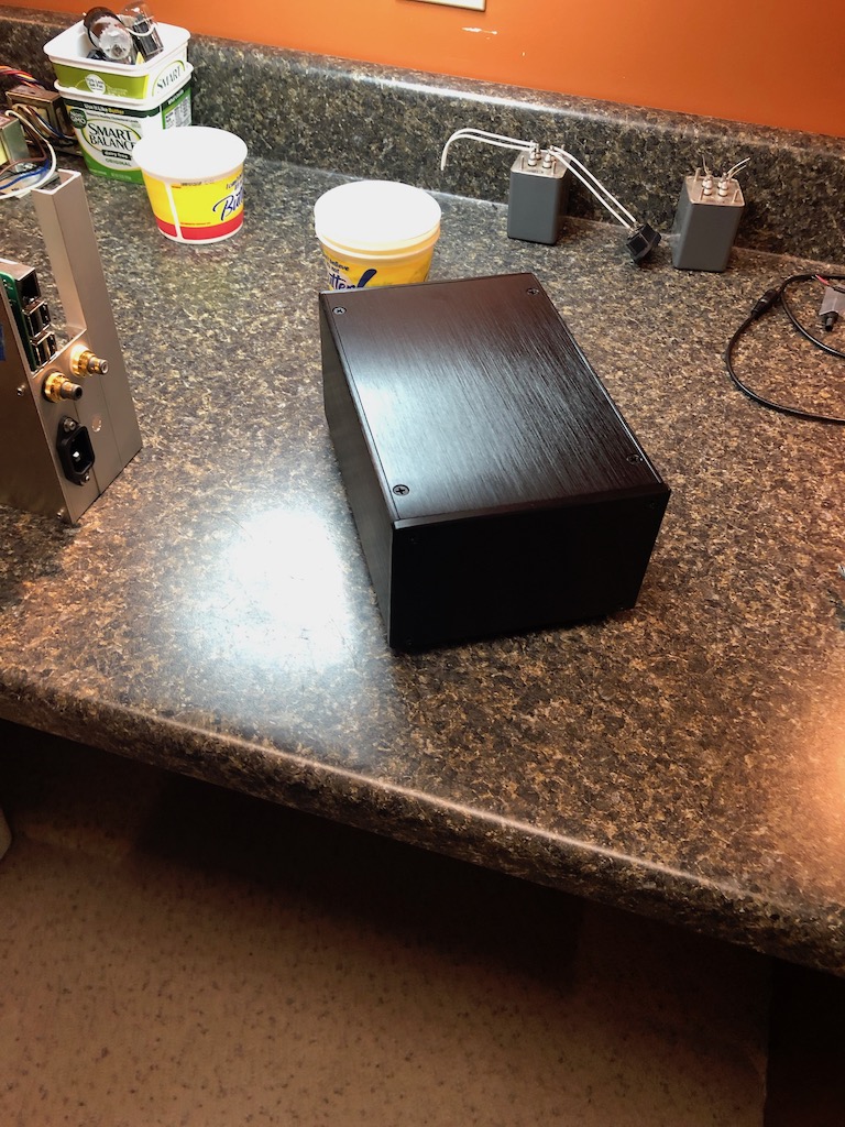

I'm familiar with these boards and tried them on my Katana. There is a bridge rectifier under each board and the pass transistors are bolted to the silver heatsinks. From what I can see the common mode chokes haven't been fitted.
Don't know what that black metal thing is though...😀
J
J
SMD diodes are in a package underneath - correct - thx.
Again, right on the series pass transistors.
Why lose the trafos?
So as to allow more current output. The chokes shipped with those DIYINHK supplies are rated to 0.5A. Bypassing then allows, from memory, 1.5A.

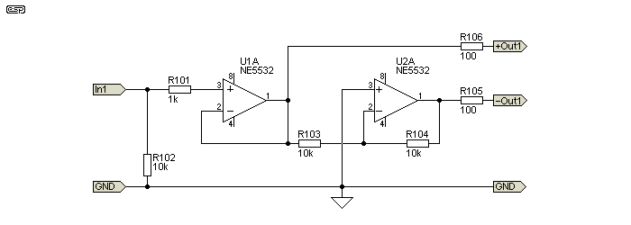

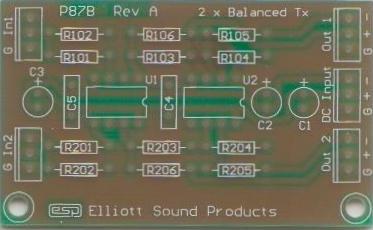

What do you think about this NE5532 implementation (PCB version)?
Circuit
PCB

I think it would be fine to keep the Katana RCA connectors and just plug the balancing circuit input into that. However, I would probably use a newer opamp than 5532, maybe LME49720 or OPA1612. Also, it will help if they are powered off the +-15v power that is filtered with film caps. In addition they should have proper bypassing with 10uf tantalum and .1uf X7R ceramic caps right at the power pins, from there to ground. If you know how you should construct the circuit with a ground plane. If the PCB you showed has a substantial ground plane then that is probably okay, otherwise a way to do it for another circuit that could be used to get an idea how it might be done is described the documentation package at the following link: Dropbox - Output Stage Instructions.zip
