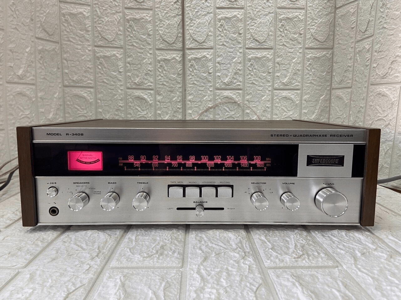

Lamps now replaced, all went good so I've been able to tick off yet another issue - starting to feel more confident!
I have now noticed a new error though, this one feels like it could be a tougher one. it's barely noticable, but sometimes in
At a certain frequency there is a scratching - kinda like tunery sound (kinda like a tuner with somewhat bad reception), typically on low frequency (I was able to reproduce the error playing Time by Hans Zimmer, and in the very beginning of the song it was quite noticable) - I wasn't able to tell if it was on one or both channels but it kinda felt like it was only one. It comes and goes too, and it's happening without me touching any controls or changing volume. I got it both on AUX and TAPE input (again computer connected via 3.5mm->RCA).
I cranked up the volume to let it stretch out, it's an intense song for sure with lots of instruments so I wanted to run this specifically to try the sound of the receiver. When going back to lower volume now, the same level where I reproduced it earlier - it's suddenly not happening at all.
I think I heard it yesterday too, so I'm guessing something is going on - and it's not consistent.
UPDATE. I get the same kinda scratchy noise if I move the input wheel between aux/tape and sort of move it back and forth in "between land" between the two. Perhaps I should give the input selector another shower of deoxidation spray?
Any ideas?

Instead of using the AUX input, use one of the tape inputs and run the tape monitor switch. As I recall, look at the schematics above, that bypasses the input selector. See if that "fixes" it.
Do this before anything else.

Cool, will try that. Would it even be recommended to run it permanently through tape input with the monitor switch on? I won't be connecting anything else to the receiver apart from my computer - so I can use any input I like really.

Good idea. Although the intermediate positions can cause scratchy noise even when new and slowly moved across positions....Perhaps I should give the input selector another shower of deoxidation spray?
Any ideas?
A may be similar scratchy error that occurs sporadically at low volumes can also be caused by oxidized contacts of the speaker relay.
There are replacement relays aviable, but you can also try using a strip of paper/cardboard soaked in deoxidation spray that you pull through between the contacts.
