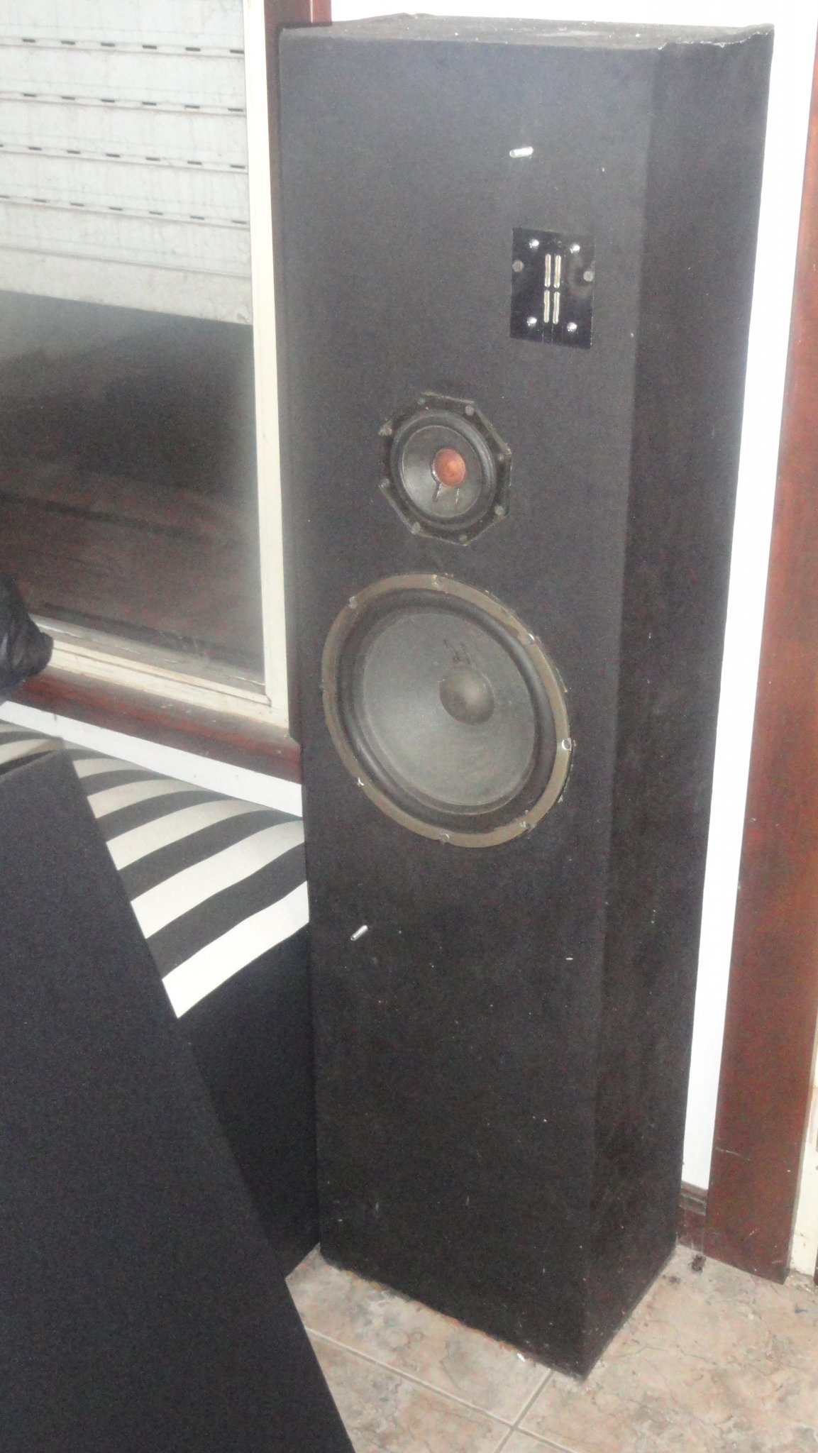

In my case, I combined vintage drivers with the modern tall skinny towers. Some 20+ years ago, I built a two-way DeApollita design (two woofers with a single tweeter a specified space between the two woofers)...Well the woofer foam eventually rotted away rendering them useless. As I used a full one-inch MDF wood, glue & screws thruout...I found a vintage pair of Infinity Qb drivers and crossovers...the originals used lousy wood and construction, the woofers used rubber surrounds so they will last uncounted years, measured out the internal volume of the originals vs. what I had in my tall skinny tower enclosure, it was a plus or minus match...the driver spacing & location of the Infinity Qbs rather unique....obviously still Infinity. 320mm wide, 220mm deep, 1250mm tall.
