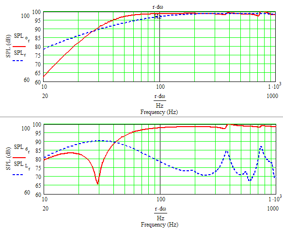

Hi GM,
Is Pi-align some kind of vented box? What makes it special?
And it's "corner horn" looks not much more than a vented enclosure facing walls.
That 14pages of paper (with lots of math) is hard to digest for me😱
Right, it's just a very basic corner loaded big vent reflex (BVR) style BLH.
Yes, Wayne chose to put a name on what some call a prosound alignment which maximizes vent action, i.e. the vent is low Q (broadband), trading some LF gain BW for more power handling/driver protection along with a mid-bass emphasis to better blend to mid horns.
Here's an Altec 416-8B Pi Align:
GM
GM said:
Folks seem to think that since the cab is rolling off the low end it's not using much power, but if it's getting a high amplitude signal the driver is trying to reproduce it against a high box compliance, heating up the VC, which draws more current, etc., etc.. I^2T rules until the amp starts clipping or the VC blows open.
Does your statement means that building a smaller sealed box to achieve a sharper roll off in the low end is a bad way to do it ? I was thinking it was a good way to do it mechanically instead of with discrete components.
