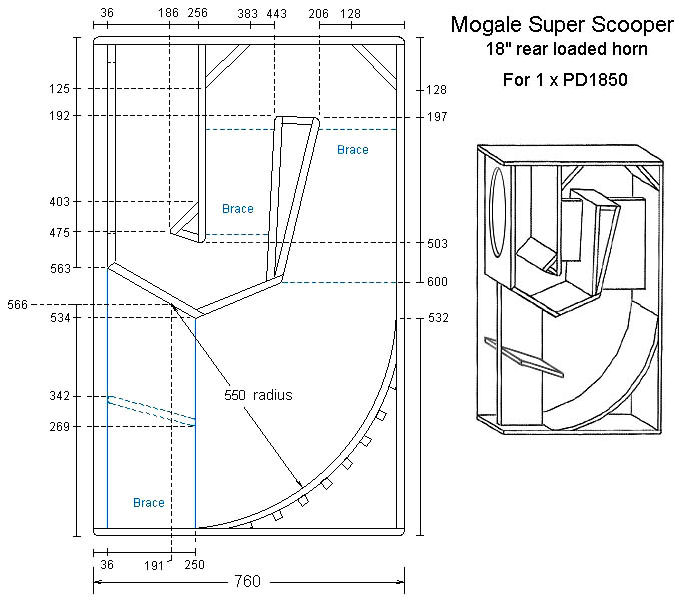

How about a backloaded horn with a big PA driver
says it gets unloaded below 30hz, so maybe not so easy at all
http://www.speakerplans.com/index.php?id=18superscooper
I maybe would suggest a couple of 15" crossed around 800hz to a mid/tweet horn
