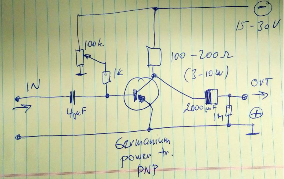

hi all, its been a while since I did anything with germanium, so I revisited single ended classA headphone amp with germanium transistor idea
while back I posted some links to aliexpress, where someone was selling such headphone amp
no schematics, so I had to improvise myself

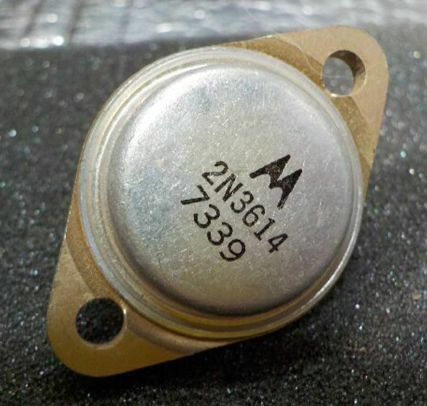

I got four of PNP germanium output transistors, 2N3614, and Soundhappy posted datasheets, they are new never used, measure good, so I put together this simple circuit
just tested it, it works, sounds decent, plenty of power for headphones, and it even drives small fullrange speakers
any comments on the schematics?, its as simple as it gets, I would like to squeeze as much quality sound as possible, not after power
I will do series of simple distortion and fr response measurements once I have time
cheers!

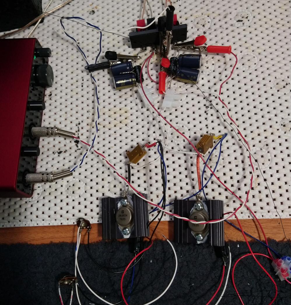

ok folks, here we go, you may not like the results, but it is what it is
pictured is set up, really just two transistors, small heatsinks, few resistors, two caps
I did four measurements, all at -10dB of the sound card, quite loud for headphones, so with 30ohm load

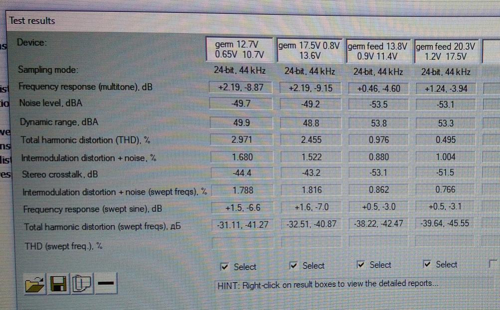

shown are four measurements, two without emitter resistor, and two with (second two labeled feed)
two are at lower power supply (12-13volts) and two at higher power supply (18-20 volts).
lower power leads to higher distortion, more volts, lower distortion...makes sense, since the current is bigger
however, emitter resistor (2R2) has more dramatic effect, so perhaps I should double it
I adjusted the trimmers for highest signal on the output, which I believe may be lowest distortion too, but not sure
at lower power supply, no feedback, distortion at -10dB was 2.97%. Yes, that high. At 17V power supply, it dropped to 2.45%
however, with emitter resistor, distortion dropped to 0.98% at lower volts, and 0.495% at higher volts
spectrum is purely second harmonic, pleasant, at normal headphones listening
I have some 120hz hum signal to take care of, since I did not use regulated power supply right now
fr response rolls on both ends, I would understand lower fr by not enough capacitance on the output/input, but I am not sure why it rolls of at higher frequencies
I would like to fix this
any idea? btw it rolls less with emitter resistor, so making it bigger should address this as well as distortion

PRR
Joined 2003
The collector resistor must be equal to or less than the load...
Maximum efficiency calls for DC load to be 1.4 times the AC load; and about 70% of supply voltage dropped across it.
Maximum efficiency will not be much over 5%. (Most books get this wrong.)
Distortion at *maximum* output is always 26% mostly 2nd. NFB can reduce this.
Yes, a follower will tend to be lower THD. As a follower, near 1%.
To get low THD you can build it MUCH bigger than you need. Build for 1Watt, run at 10mW output, THD may be 2.6%.
The proposed one-transistor plan may also be distorting at the input due to low nonlinear input impedance loading the source.
You really want a gain and buffer stage. If your religion allows it.
