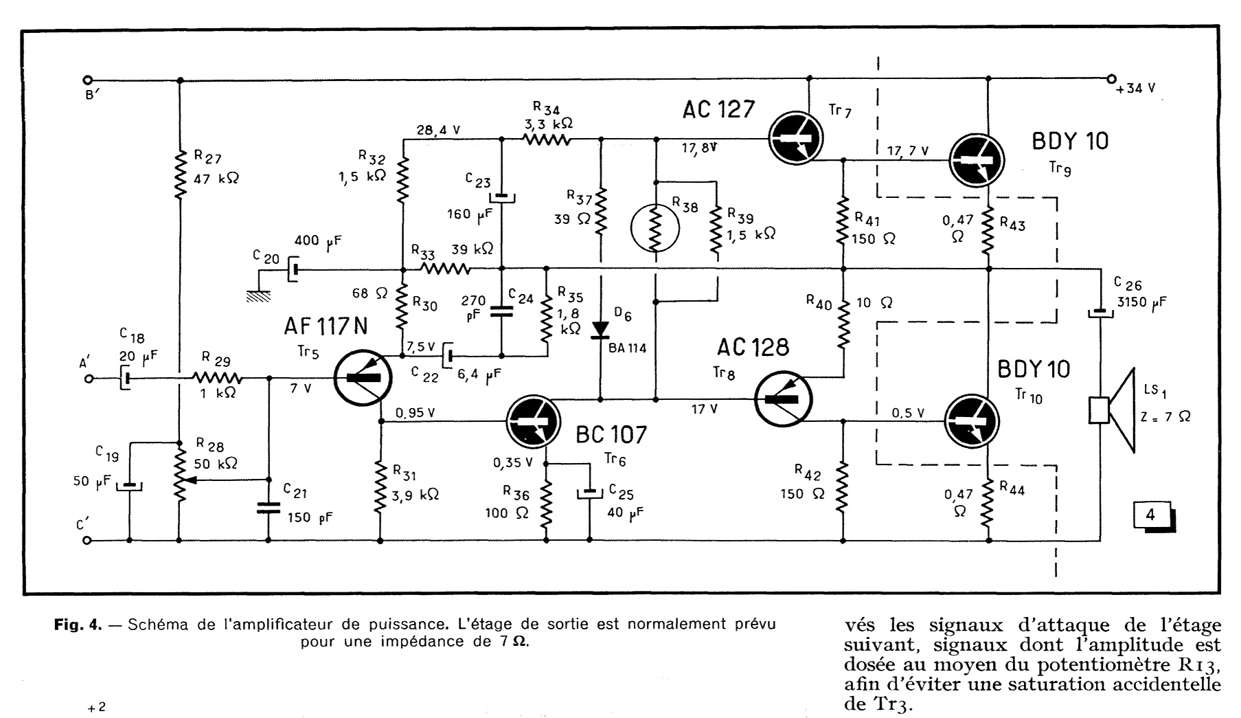

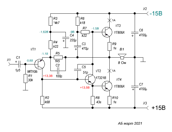

I found just such a circuit.

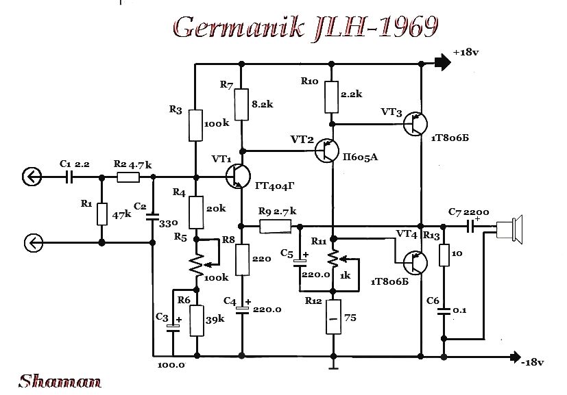

@ Jpatay
Haha " Shaman " Thank You very much for schematic :^)
@ Diyers

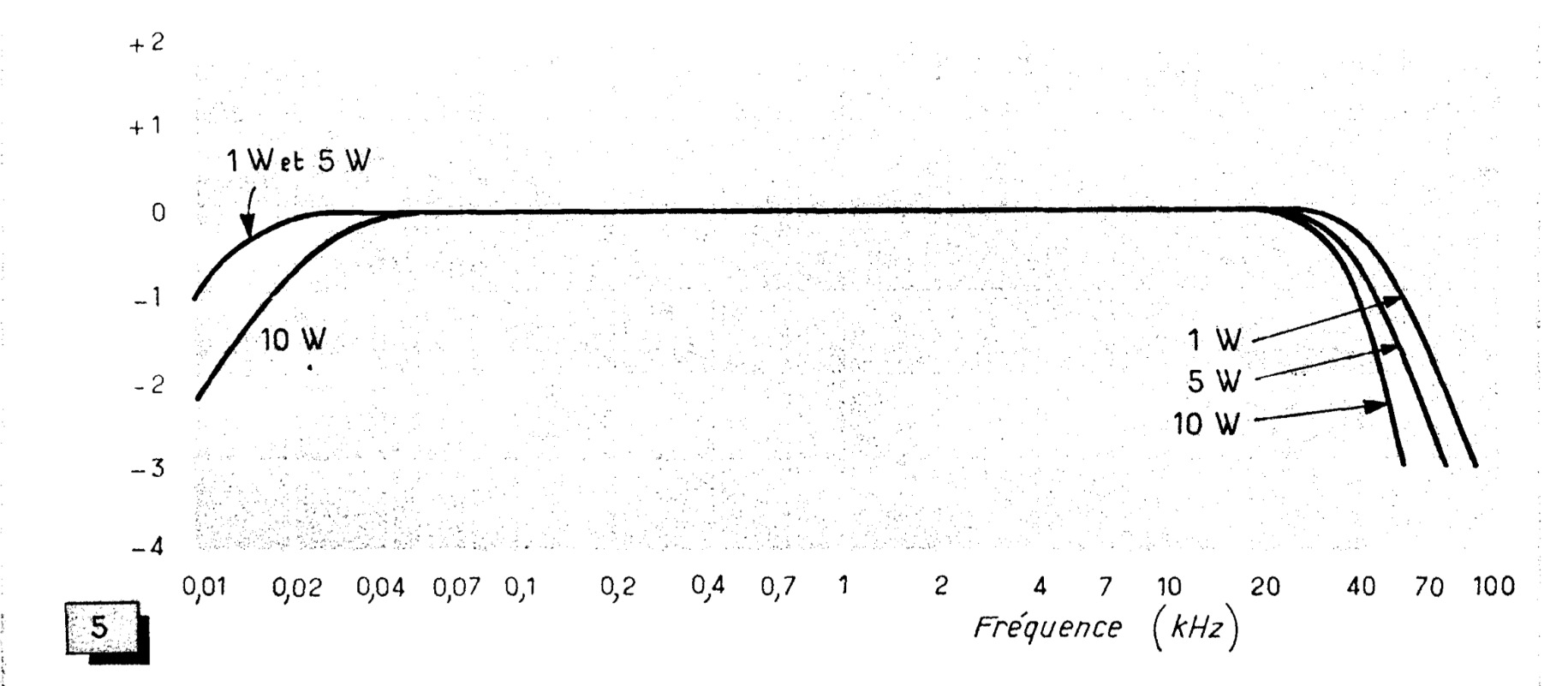

From Retronik archives class A 10 watt's hybrid amplifier
small signal are Germaniums+ BC107 are Si, power output stage are Silicon

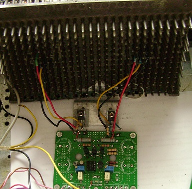

I made and tested this circuit for interstage transfrmer driver. Working very good even without thermal coupling and heatsinks at the output Ts. And stable, with 0mV offset. I am pretty sure that WITH thermal couplig of devices results will be even better and buffer will come to bias points faster...
I need higher input resistance. 240K used can be higher. Because of that I put JFETs at the input branch... AD161 are slight warm without heatsink, inspired of slightly higher current of 53mA cca. Bit R should be 2x2W or 5W single for not to overheat. Coupling C to the primary was 2200uF
I did this version first because I already had rest of the elements in place. BUT version with N-JFETs (2SK170 for instance) and AD162 (or other PNP more common Ge types) will also work. I will post schematic latter and build circuit theese days.

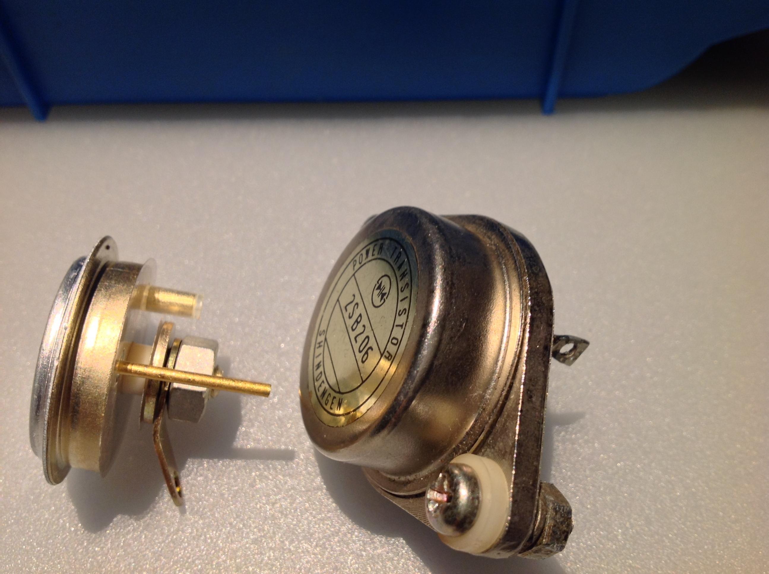

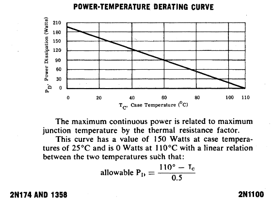

Yes, no doubt this is P dissipation formula
but look at the giant metal case size of 2SB206
logically with respect to the laws of physics small case can't dissipate twice of the heat.
Well, I don't know Ge chip size inside..
but repeat again data sheet of 2SB206 parameters are probably underrated.
Transistors producers factory use normaly big case only for large size semiconductor chip..

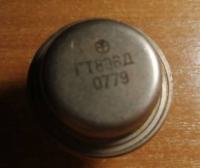

Usually the maximum power with a radiator is indicated. Power transistors have only a few watts of power without a heatsink. I shot a power of 3 W from the ГT402, with a radiator from an LED. Without heatsink, ГT402 collector continuous power dissipation: 300 mW.

Well which one of the two transistors cases can dissipate more heat and handle higher temperature ?
Frankly I think the giant one is not two times less powerful :scratch2:
Can't believe old data sheet

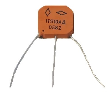

If the body of the transistor is larger, then without a radiator it will be several watts more.
Here the 1T910 transistor without cooling has 0.9 W, and the ГT806 in a large case has 2 W. But with a radiator 1T910 - 35 W, and ГT806 - 30 W.
If there is good thermal contact with the heatsink, then the transistor can be in a smaller package. These early designs of transistors were in large packages.

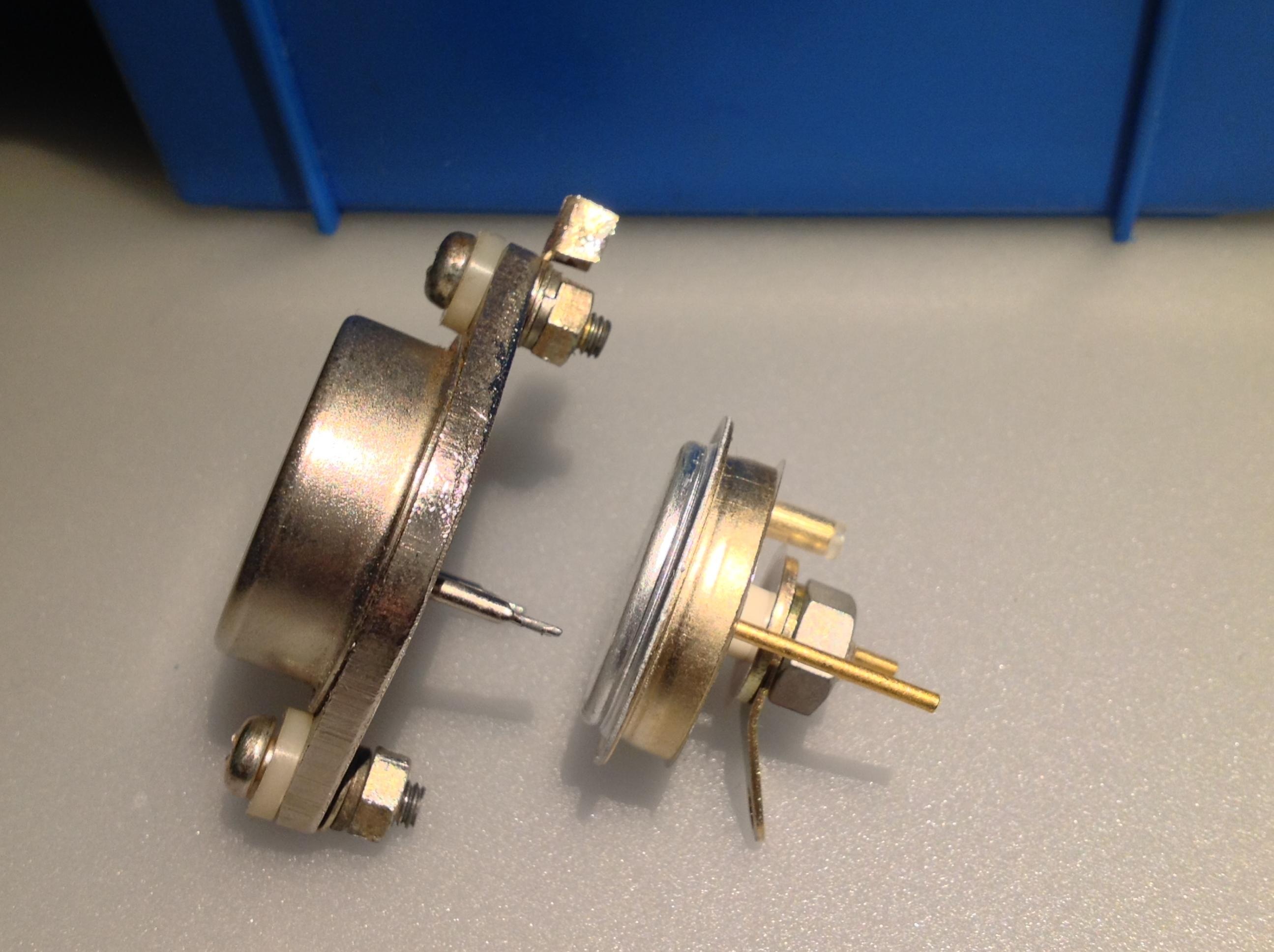

In a moment of excitement when I was on holiday a couple of weeks ago, I ordered 8 used 2SB206 on Yahoo Auctions Japan for cheap which Google translate said were classed as "junk".
Not expecting much for when they arrived, I played around with a curve tester on them (they aren't dead yet!) and got the Hfe and Vbe data to see how close they looked. If that's of any interest or someone is interested in seeing a graph let me know, more than happy to do a bit of measuring.
Next on the list is a SIT amp but after that, it'd be nice to put some of these into something and see how they sound, they look very cool 😀

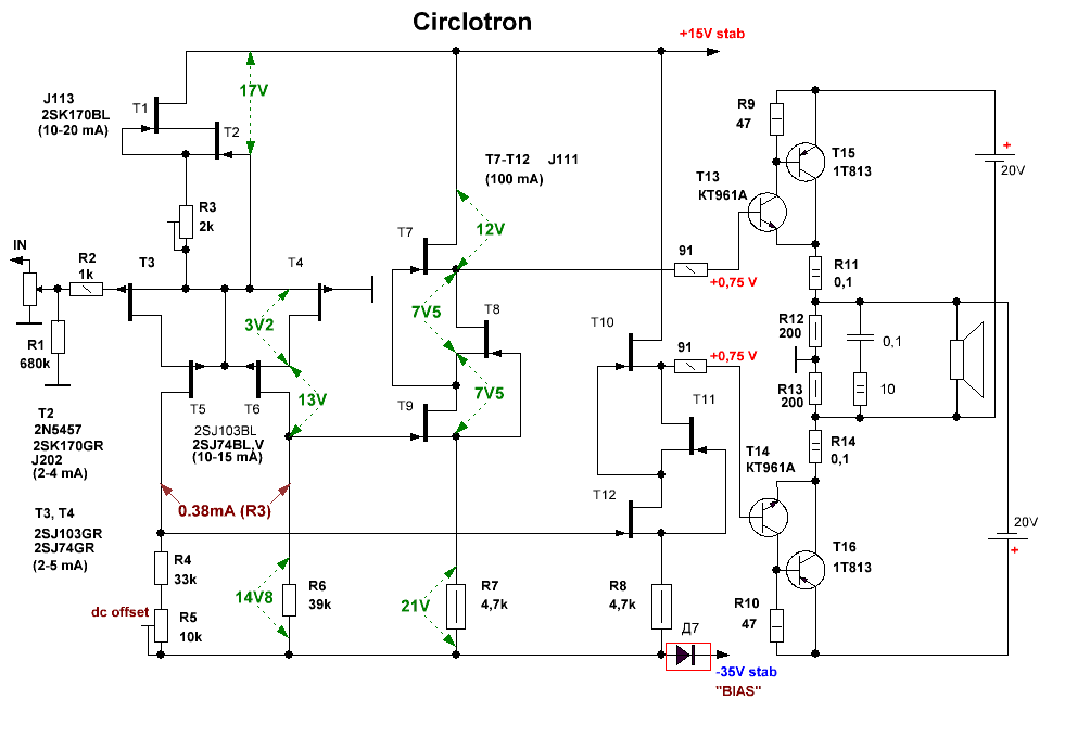

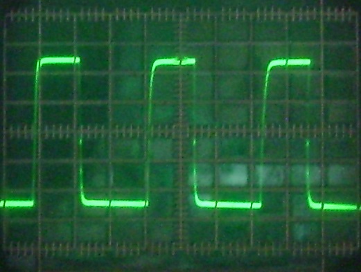

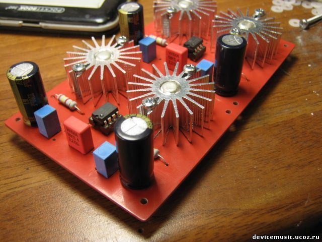

I replaced IRFP150N with Sziklai (KT961A / 1T813) in the circlotron. The power supply contains Д303 germanium diodes. At the output of the amplifier there are 1T813 germanium transistors. The sound came out much better than on Mosfet. I listened to the amplifier for two hours at low volume. The 250mA current was stable. And this is without a temperature sensor. Square wave - 32 kHz. In general, I'm a pervert. 😀
