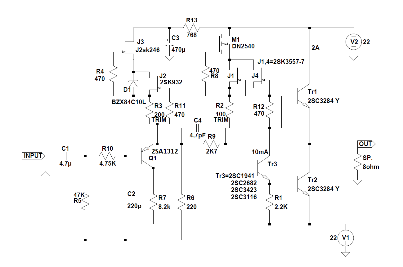

I checked out your circuit in detail, and agree almost totally with your transistor choices.
I know you are using JFETs for the current sources.
But in keeping with the original circuit, KSA992 / TTA004B are equally good in those positions.
Of course 2SA970BL is arguably even better, but is unobtanium.
2SC2682 and 2SC1941 are also obsolete.
But TTC004B is very close to 2SC3423 and is an active part.
Comparing 2SC3284 to MJL3281 (or 2SC3281 ?), the latter is more linear in hfe vs Ic.
I also like Sanken devices, but it seems to be more difficult to find than the On Semi.
They will all fit my Gerbers.
One needs to add 4.7p in parallel with the feedback resistor (R7 in the schematics in post #1).
Have not tried them all in the JLH circuit like you did, so only my armchair commentary.
And many thanks for sharing with us.
Patrick

Thanks, Patrick
I spent months testing the transistor because it is obvious that such a simple amplifier will be sensitive to the choice of parts, especially the driver / VAS transistor which has a lot of impact on the overall sound.
An SMD 2SA1312 can be placed for the input transistor, Mouser has them in stock. Mouser has some other interesting transistors besides the TTC004 that I have yet to try, unfortunately mostly SMD.
Compensation with 4.7pF is only needed with 2SC1941, with all other transistors not required.

I use 2SA1312 a hell of a lot. I have hundreds.
But they cannot take so much power, so limited to low bias (<4mA).
Have you tried TTC3710 ?
High capacitance, which does not have to be a disadvantage in some circuits.
But linear to much higher current.
Also interesting I find 2SC2873.
Do let us know if you have more results. 😉
Patrick

So I replaced the BJT current sources with Spice ideal current source.
Distortion does not change.
One can conclude that the current source is currently not deciding factor.
Patrick

Spice simulations depends on the model being used.
Different models will produce different results even with the same circuit.
And of course none of those compares to real measurements.
Patrick
