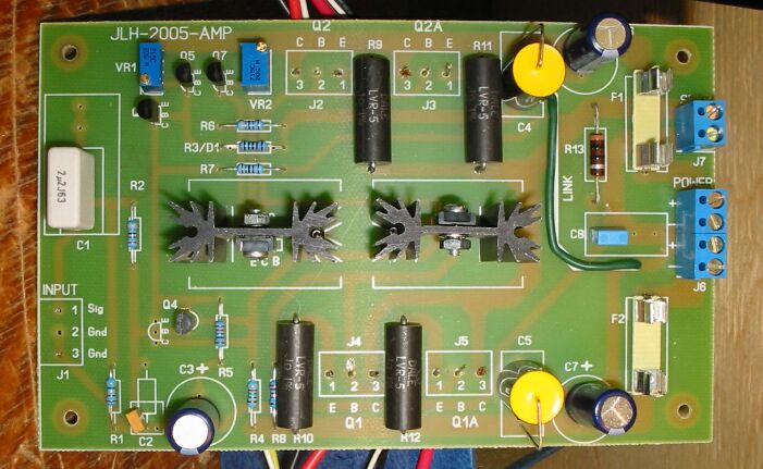

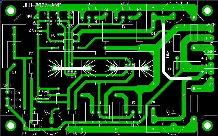

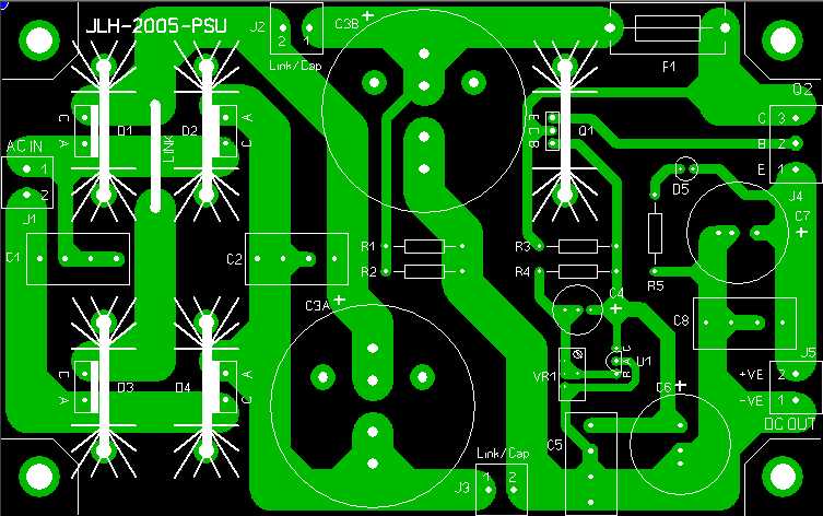

I had the PCBs made through Gerber's supplied by EUVL in post no 8, I am grateful
I do not understand

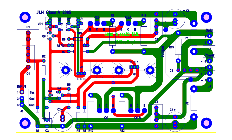

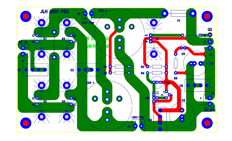

1- the output of power supply board and power supply input of driver board markings.DC out is 1 &2
DC input on driver board is 1,2 ,3, 4. ! corresponds to _ive on both boards, but 2 on power supply board is positive, does it go to No 4 on driver board?
2- There is a white line next to Q1 on driver board, this supposed to be shorted ?
3- Looking at picture in post 1 , I am supposed to use "Q4'" position, one with ' ?
4- what is the specification of fuses.
5-I have two 500VA, 0-18v Toroidal Transformers and I intend to build mono blocks, is 18v enough or I need to purchase new transformers?
5-If some one responds I will next post the parts list and would appreciate if those in the know can say yes or no, please?

Since I did the PCBs, I shall only answer questions related to those.
They are 1:1 copies of those of Geoff, with no changes.
So not my design, but I try my best to answer.

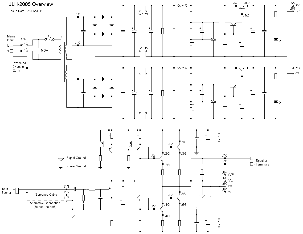

You need two PSU board for one amplifier.
Each PSU board has only one polarity.
The amplifier has split rails, or 2 polarities.
The white line is a jumper.
Q4' is provided only to allow the use of alternative transistors with a different pin out.
You either populate Q4, or Q4', but not both.
Patrick

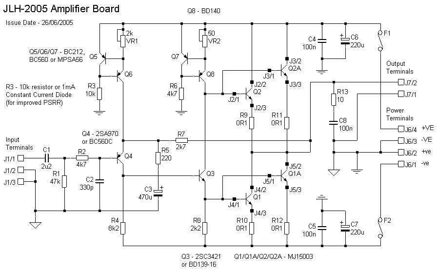

I am confused as original JLH had only + and - DC supply to the board and Geoff Moss version seems to have +/0/-
See enclosed picture from the "JLH-Class A Update" , have I got it correct that
To make one channel of amplifier, I need to build 2 power supply boards & combine the DC output of 2 power supply boards at driver board
