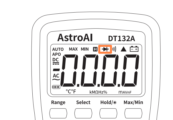

I have the tester in diode mode and the transistor is giving a reading of 056.1 or 000.1 when I swap the + and -
Do you confirm that the diode check mode indicator as shown below in the orange box is lit?
If so, and if the transistor is disconnected from other circuitry then it is bad.

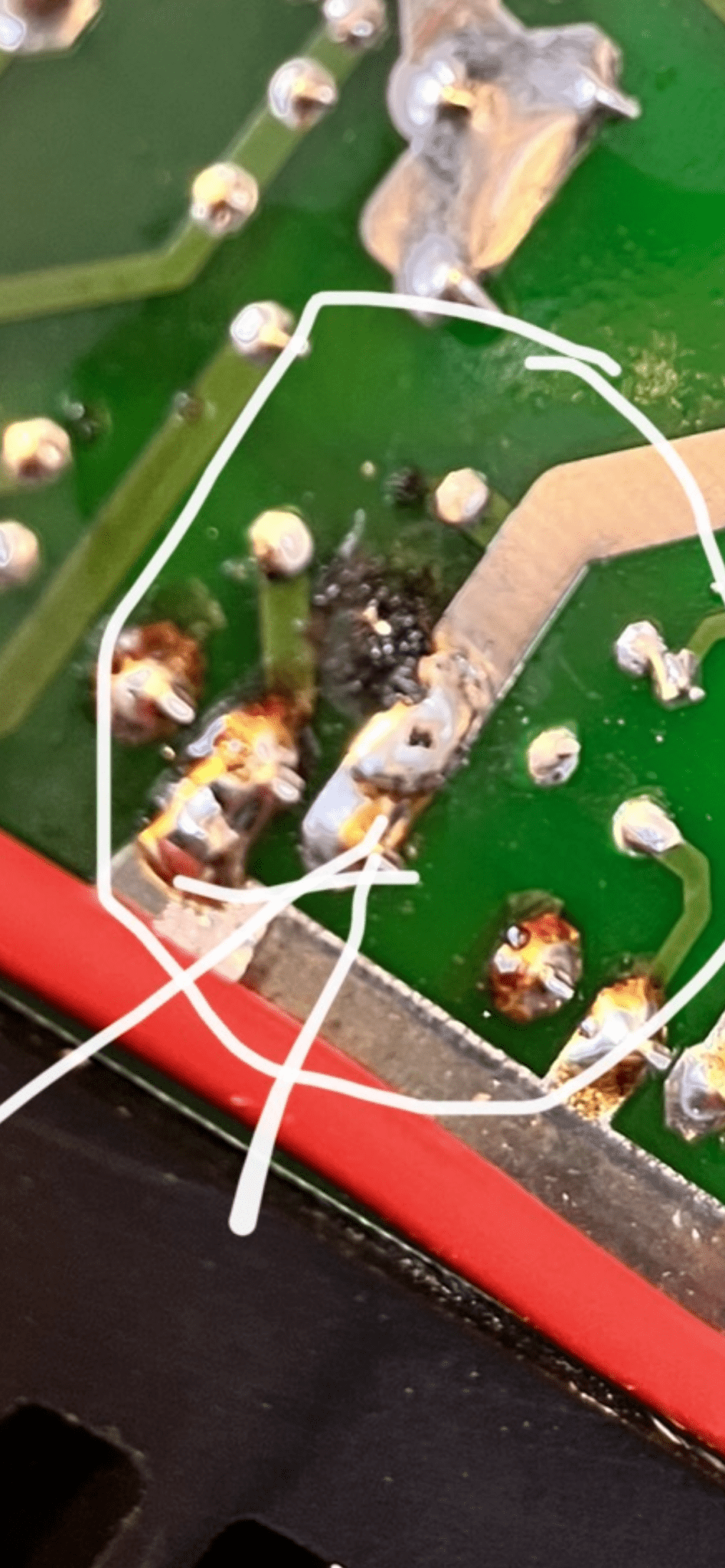

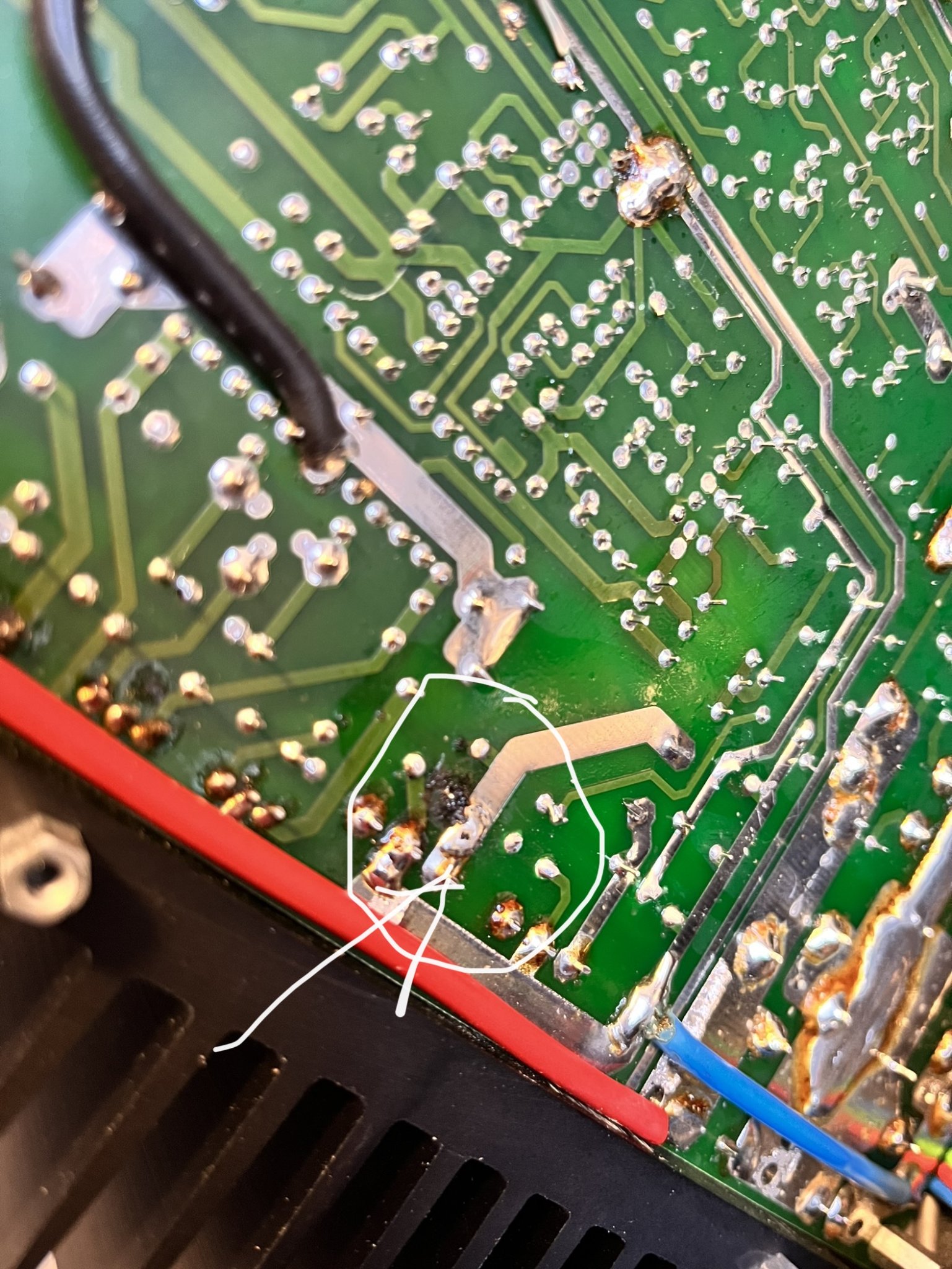

The 220 uF capacitor you point to in Post 26 is a bypass capacitor. If all it did was short to chassis you could be in luck. You may in that case be looking at a blown rectifier (maybe) or maybe just a blown fuse. But if that pin bent and touched some other node in the circuit you could be in for a lengthy repair. Are there any indication or burn marks where the capacitor pin connected?

I can't make sense of that picture. In part because it's pretty out of focus. But the burn mark is obvious. It looks to me like the arc was at the fat trace leading to the 3-terminal device at the edge of the board. I'm guessing that 3-terminal device is one of the output devices.

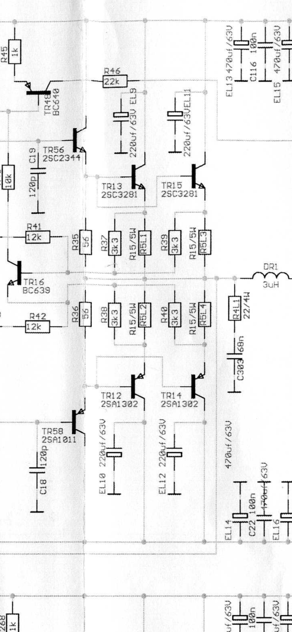

Go pull out the schematic and mark/highlight on it the node where the burn mark is.
Does this amp have any sort of over-current protection? Does it protect against over-current in all the output devices or it it just hooked to one device?

I can make sense of it. That was a collector-emitter short. The fat traces are the clue. It wouldn‘t have destroyed that transistor immediately, but would have taken out the complement on the other side. Driver as well as output. The C2344/A1011 driver pair was nice (really nice) but comparatively fragile so look for blown drivers. Once the other transistor died it may take out the one that was originally shorted. Likely it was confined to the output stage, the worst that would happen is blowing all 4 outputs, both drivers, and maybe the Vbe multiplier. Any emitter or base resistor needs to be checked too. They can open up and still look perfectly normal.

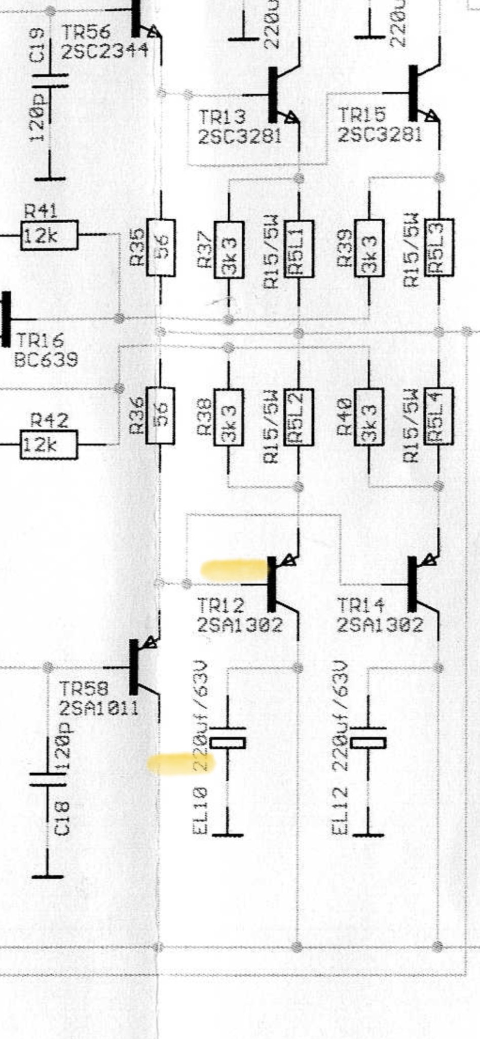

Sure. You can give up if you wish. Or you can accept the learning opportunity.
So you've kinda-sorta marked the base connection to TR12. Are you sure it's the base pin that got shorted to the cap? Is the back of the transistor up against the red object in the picture in Post 53? If so, I think it's the emitter pin that got shorted to ground.
I would start by removing TR12 and TR13. Then see if the amp can power up without acting up. If it still acts up, remove TR14 and TR15.
With the transistors out of the circuit you should be able to verify the emitter resistors. They're all 0.15 Ω. Your meter will read high. If you short the probes together you'll probably see 0.2 Ω or so, so keep this in mind when you measure the emitter resistors (R5L1 - R5L4). If they read much beyond 0.5 Ω they're probably toast.
You can also check the transistors using the diode setting on your meter. With one probe on the base of the transistor you should see a diode to the collector and another diode to the emitter. If you reverse the probes you should see an open circuit. The PNP devices will show the diodes in the opposite polarity as the NPN devices. Measuring from collector to emitter should show an open circuit in both directions.
With the output stage removed, the amp should be able to power up without acting up. It should have a reasonably low DC offset on the output. I'd expect <100 mV. If not, the drivers are likely shot. So pull those (TR56, TR58). Check them with the meter.
TR16 detects over-current. It's possible that it's dead as well. In fact, if the amp powers up with the output stage removed, has low DC offset on its output (so on the 'inside' of the output inductor), but the output relay still clicks, I bet TR16 is done.
