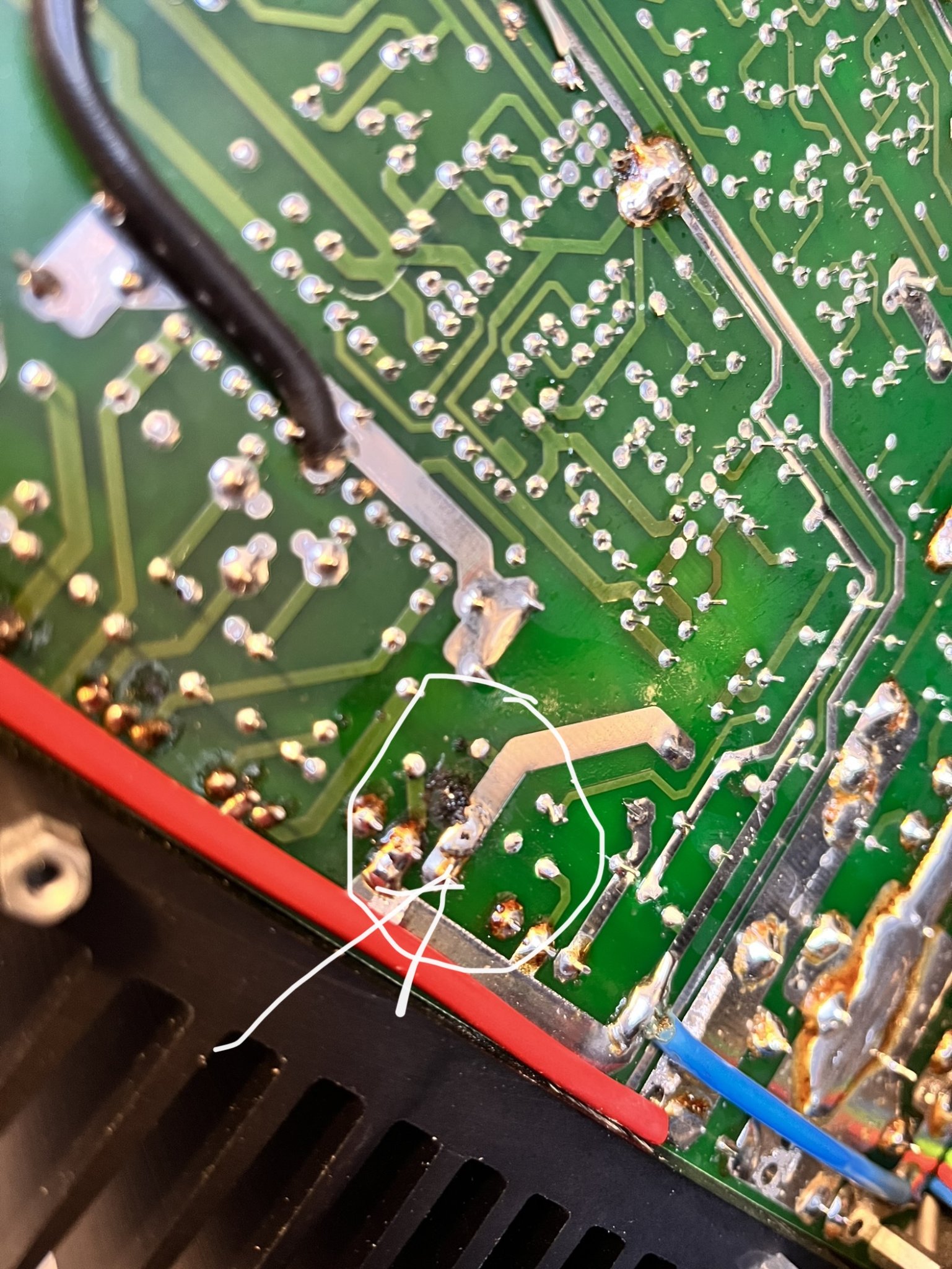

Gents I’ve screwed up big time

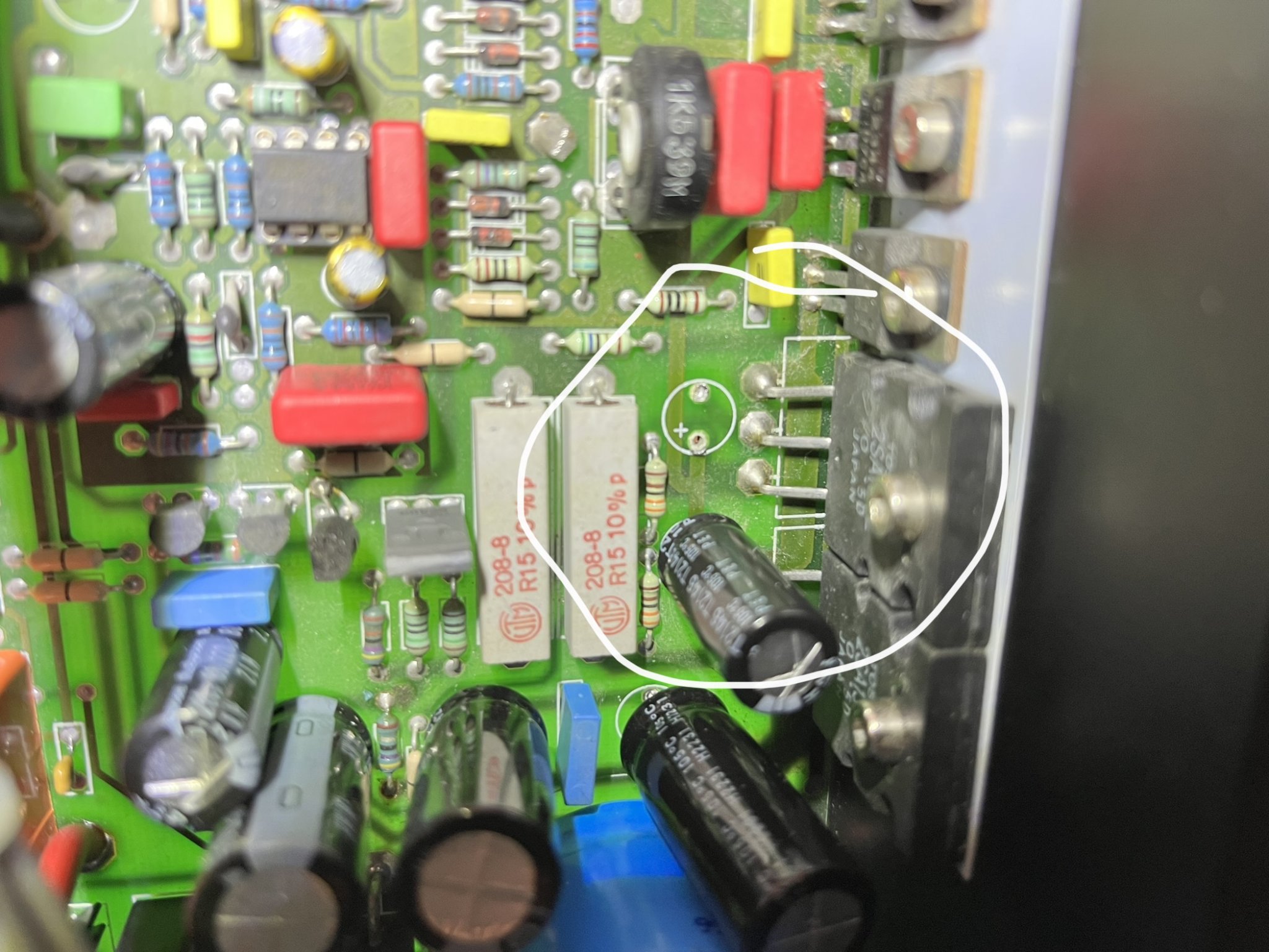

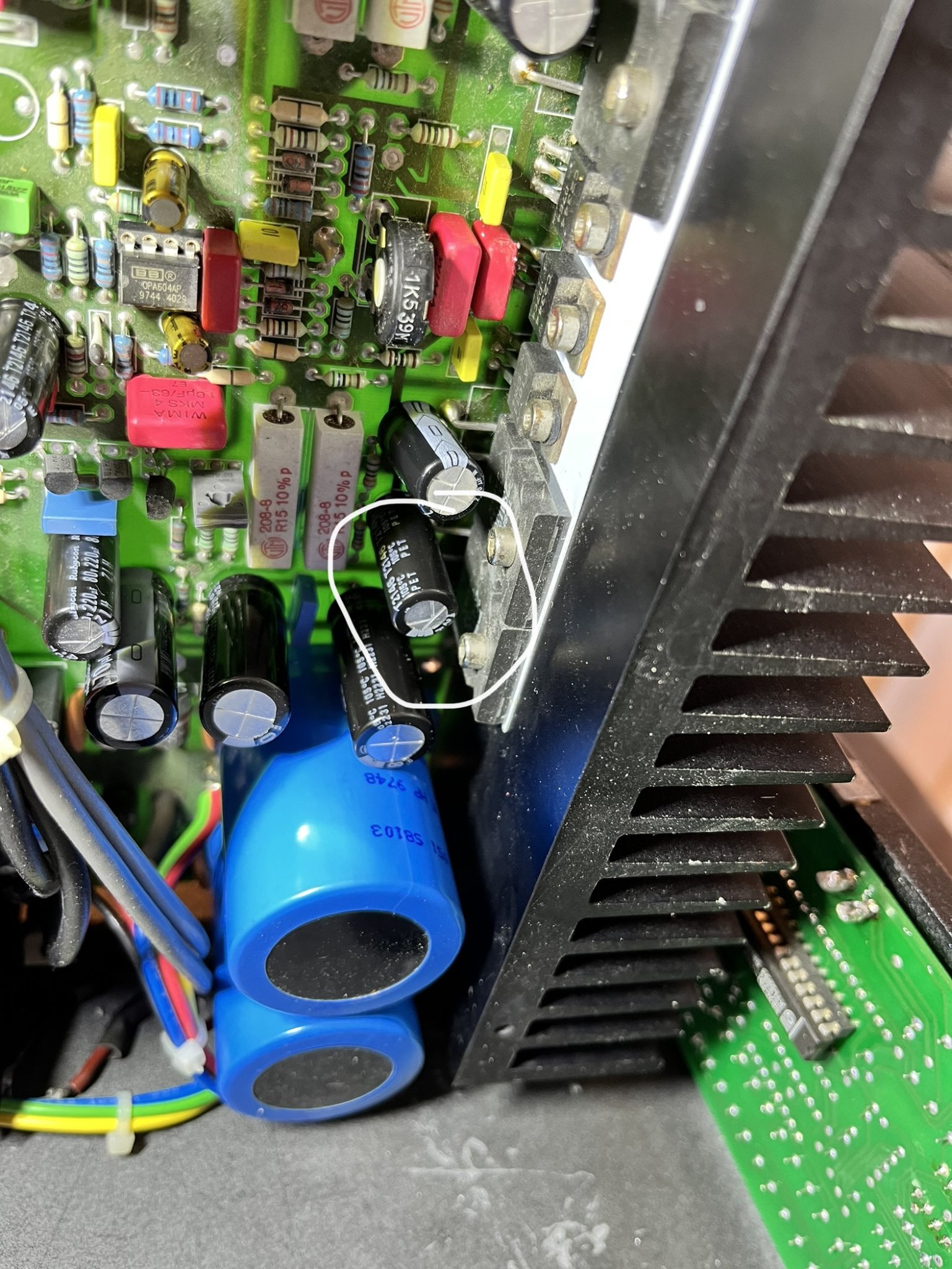

Oh. I see. Now it makes more sense. That also means that the emitter of that transistor was shorted to ground. I've marked the three terminals on the output devices and the inadvertent short circuit in the images below.
Does TR48 control the output relay by any chance? I bet the relay tripped because of excessive current (-> excessive voltage across the emitter resistors -> TR16 turns on -> TR48 turns on). Unless something is done to then power down the amp electronically, the amp is basically allowed to self-destruct. Had TR16 tugged on the drivers it could have turned the output stage off and maybe prevented the destruction. But that's not the case here.
Anyway. I bet you can get it working. It shouldn't be too much hassle to replace the transistors as I described above. Best of luck.
