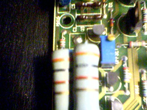

Stealth #2
I have already gotten further than the last guy. 😀 OMG , he jumpered the thermisters and made a general mess of things to try to "jumpstart" this deadly amp.
I actually got the CPU to work and then replaced one thermister to get one channel back. I am glad the last tech blew a lot of fuses or he would of fused the relay contacts with too many "jumpstarts".
Now, all the inputs switch ,but I am still left with a TOASTED left
channel. When I say toasted , it burned the traces off all the outputs , melted 2 big caps and burned out the VAS...
Damn, for 7900$ , could they have parted with a few fuses ??
I am down to getting just the left channel to work. This stealth is totally re-engineered from the earlier one , the VAS/LPT is modular and the components are different ... but close the the original. I can not imagine why the last tech did not get this amp, in 1 hour I have all but the left channel.
I think the left input stage is toast on the module as the MJE's are not blown but heat up the little audio trafo with their excessive offset. For the bad left power module , I have a working (1 noisy transistor) right CH. (from mine)to replace it with.
All that remains is to troubleshoot the left VAS (module).

The 1st amp has been in use almost daily. A fellow audio nut mentioned that he thought the "bias circuit is not tracking properly" because the channels (heatsinks) don't warm up equally.
With the bias set under 50... the right side gets h-o-t within 5 mins of use but the left side doesn't even get warm. When listening at low bias settings, I can hear the right speaker sounding ever so slightly better/louder/clearer than the left.
If I set the bias at 100, both heat sinks warm up equally and the sound is perfect from both channels.
It's only at lower bias settings that the ineqaulity in heat and sound output is present.
Can you test the bias circuit on the 2nd stealth to see if it's working properly at different settings?

How ya making out on the repairs OS?
You mentioned tweaking my current amp so the bias is the same on each channel. Is that something I can do?
You see the trimmer? (blue square that says offset) this is the only control on the amp boards. I did adjust those (both of your channels have under 50mv offset). What happened is in the last 2 days before the shipper arrived, one channel broke out in static. So I could ship it to you I gave you the amp out of the other stealth. I also adjusted that one (<50mv) . The default biasing is controlled by the CPU , I deduced this by seeing the differences between amp boards.
Do the sides heat up at full bias ? , I fear that there is a possibility that the minimum bias is "locked" by the circuit itself.
On the one I have now (since it is toasted) I will make the necessary changes to make both sides into equal room heaters.
Really getting deep into these stealth's , I have noticed that they use the PCB traces as the fuses (safety factor instead of fuses).
Genesis could not keep the circuit OR the layout consistent from amp to amp 🙁 , and they jumpered traces plus added parts (layout errors in PCB). Not "in line" with a $7900 unit.
At the moment , while not homeless , I am low on resources ($$$), I don't intend to charge much to finish this amp. Hell ,If you just get me some more supersym parts , I'll be happy. 🙂
OS
PS.... lgreen , I have gotten many emails for supersyms ,so I WILL
start a thread with PCB layout. The amp still lives , and is ROCK SOLID - final version, no changes needed.
os, both sides heat up equally at full bias (100) but they don't heat up equally at the lower bias settings. After 10 mins or so of listening at the lowest bias setting (20), The left side stays cold while the right side is so hot that I can't hold my hand on it for long. This can't be right.
