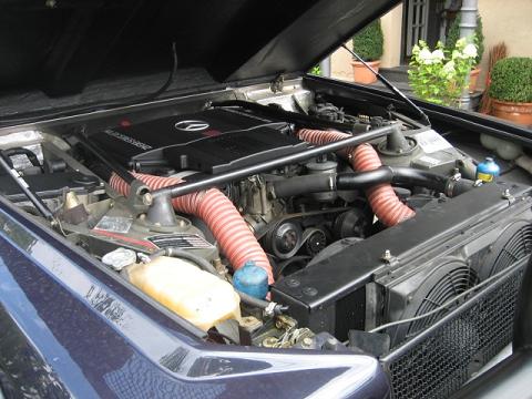

Mmm, what would an original with a totally trashed V12 be worth ?
(Zero, if it's a 400i or 412i)
The 1989 Italian Humvee contender with a German AMG engine transplant of near 70 year old Queen of Rockin Rolla was intended to fetch $250K on the collector market.
It can be yours for $150k, still 50% above current average value.

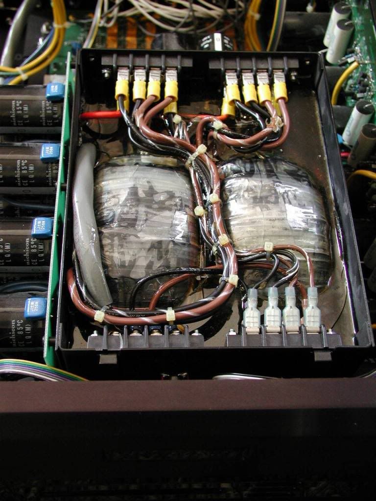

Don , I wish I still lived in albany, we could have a lot of options.
As far as monoblocks, these genesis's seem to be dual mono
to begin with (2 large toriods + 1 small). I think nobody wants
to touch them because of the fact that they have a non-standard
topology ( 4 paralleled amps per side + proprietary protections).
It would be easy to convert them to stereo "aussie amps"

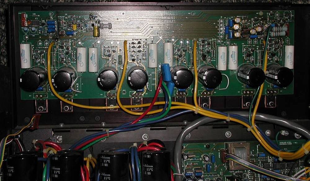

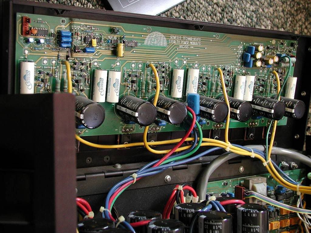

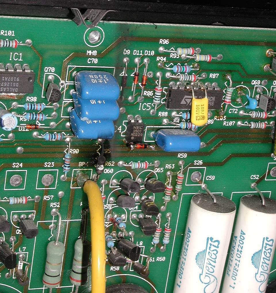

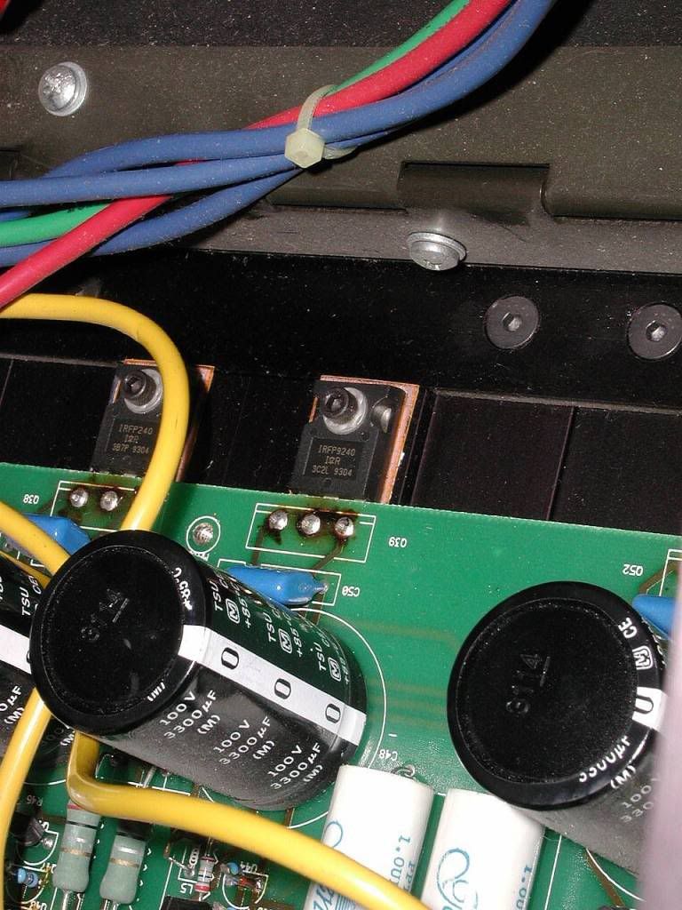

OS here's those pics we talked about. You should be able to see the burnt resistor and also the numbers on the transistors. You'll also notice that one box that holds the transformers is filled with epoxy or something and the other only has silicone around the outer edges of the transformoers. The silicone would be much easier to remove if you wanted to take the transformers out of the box.
If there's any other pics you'd like to see let me know.

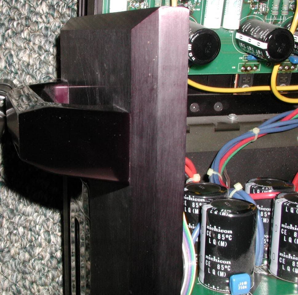

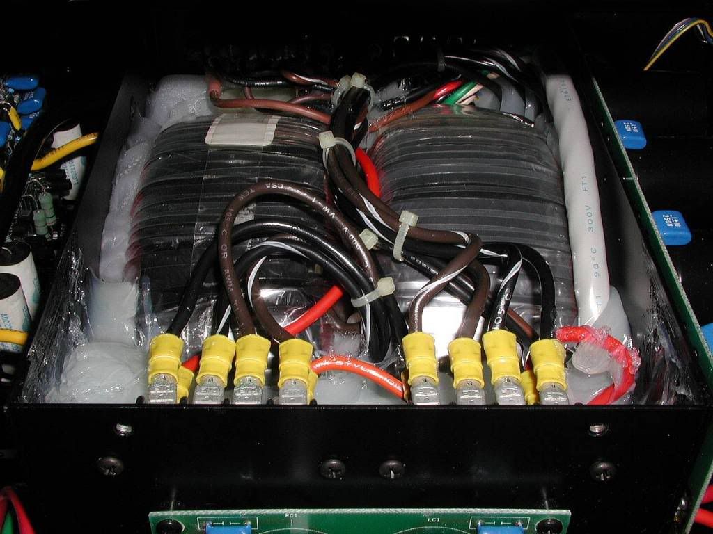

The amp is physically designed to be very easy to work on. The sides are connected on the bottoms with a piano hinge so they flip open. It's pretty slick!
Pic 7 shows the 1 inch thick face plate we were talking about. 😱
Pic 2 shows that the burnt resistor is located on the left side of the board. Pic 3 shows it up close.
Good shots , don.
First the good... the OPS trannies are VERY common IRF vertical
mosfets, irfp9240/240. ( $3.15 apiece..) The little trannies (diff.
drivers) are mpsa 92/42 , all VERY common (I have 50ea. of those).
The board seems to be very clearly marked , so the ???'s in
the schema should be easy to "fill in"
The bad (not really so bad). It DOES look as through that
channel (all 4 amps) have failed (high current to all devices)
, so off to mouser we must go (8 new devices recommended).
Even as the board is clearly marked , the device numbers don't match , BUT , the topology is the same (can see the 68R
resistors , same drivers , output config.) So it is doable,
but difficult. (not a 1 hour repair)
All parts are widely available , easily to work on ... just
poor documentation.

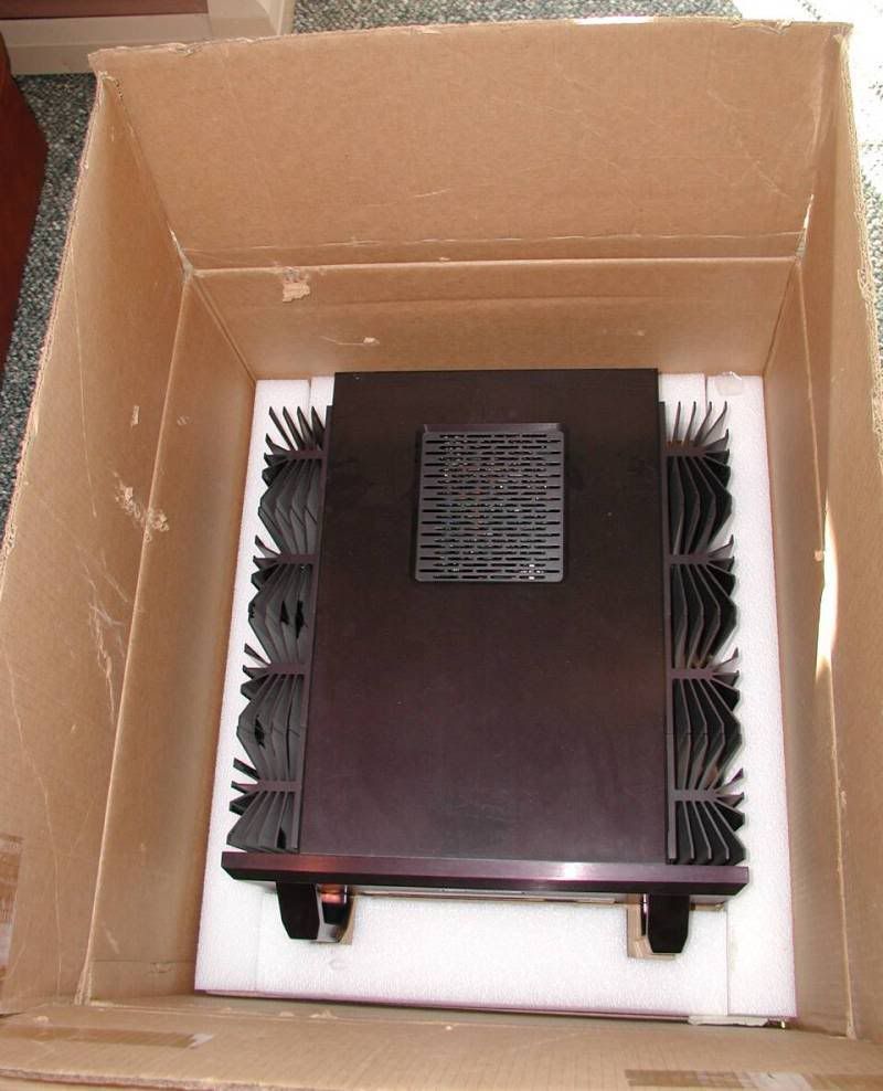

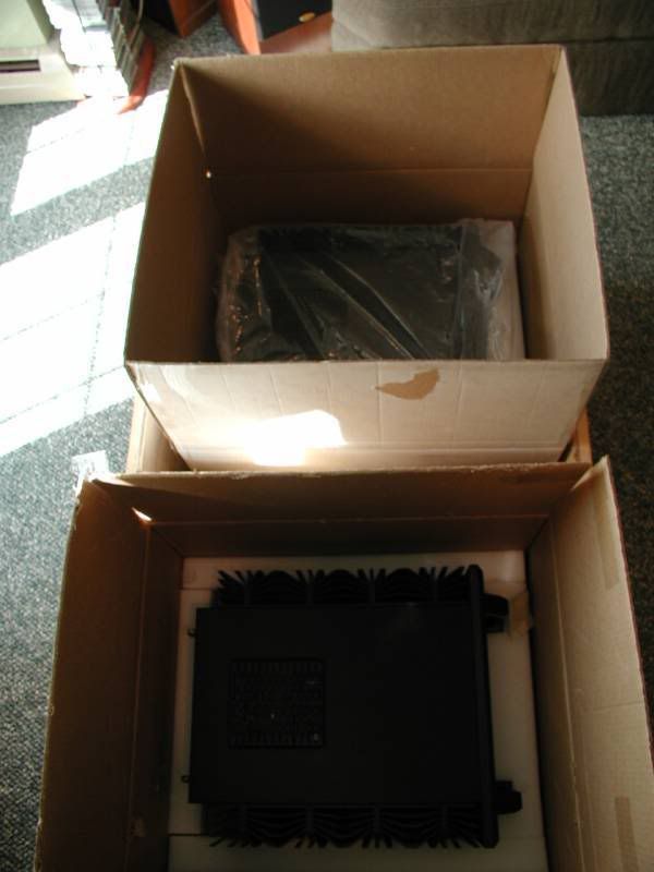

Pete, nice talking to you today. I will get these boxed & crated up and ship them out to you by the end of the month.
I really appreciate the help!

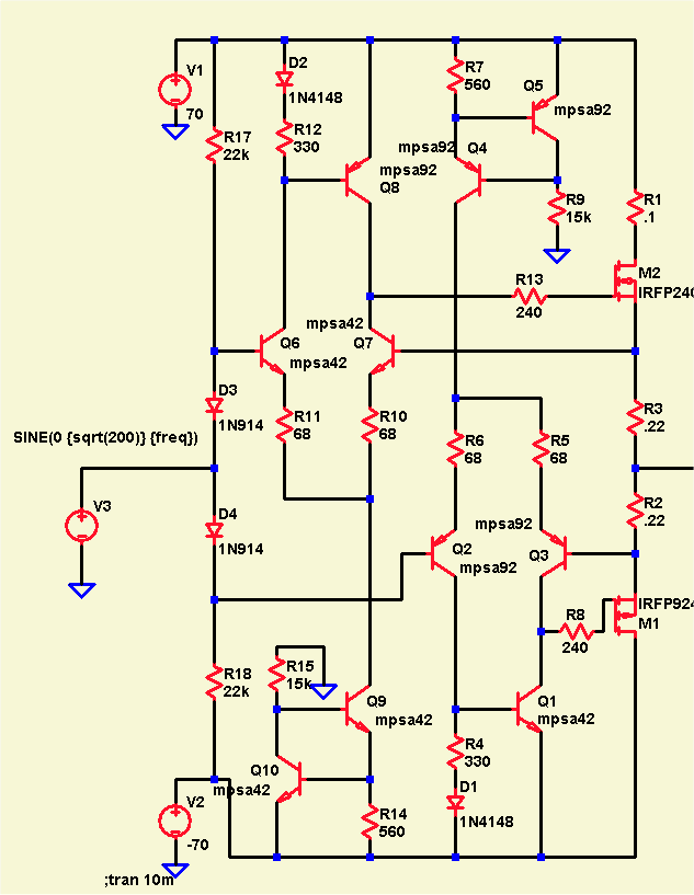

All figured out ..
I actually have this class A OPS working in LT.
The jerk@ss schematic was wrong (Q22 reverse biased) ,
but with the good photo's... all simulates well..
.ASC is in..
http://71.203.210.93/pdf1/Electronics/Projects/Audio_amp/Frugalamp/LT_simulations/
"genesis.asc" is the file.
For any interested in "scarfing" the topology.
One note.. circuit is very picky about operating currents in the
differentials , oscillated at first.. (R ??? in schema),
then .0001% bliss. 🙂

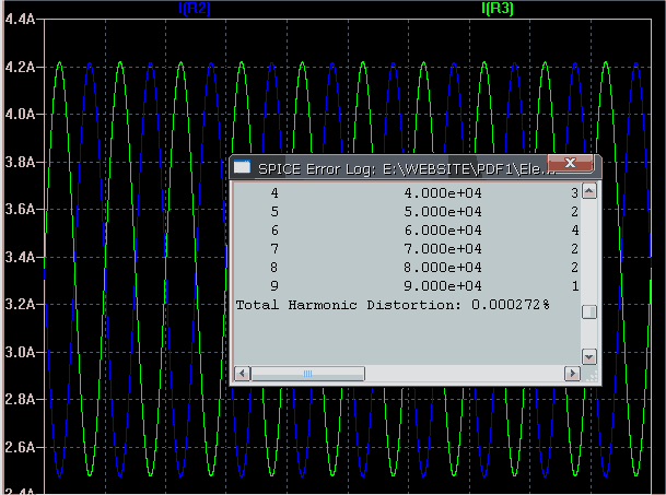

that's the stealth in simulation? THD seems nice and low!
They're all boxed and crated up... sitting in the livingroom. I can send them anytime. You're gonna need a handtruck and/or 2 strong people to move these 200 lb. crates!
yes ,that is (simulation)
at 20k , at 1k it was .00001% !
I can see why these heat up the room.
@3 amps per OPS at the max bias that the CPU can set,
(1.5) at midpoint. So ....10 to 24 amps , a lot of heat.
According to the circuit schema , the bias is cpu controlled , can
you see a graphical representation (readout) of this on the (semi)working model??
