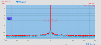

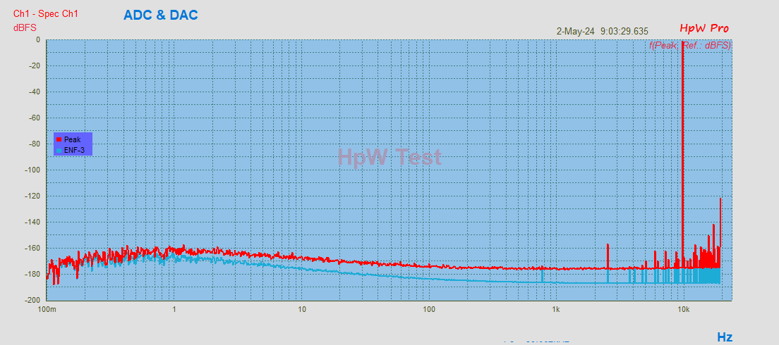

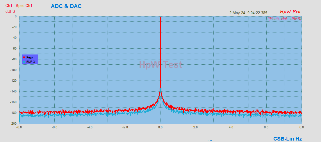

At the end of the day, may you post some figures as PN & AN (An = Amplitude Noise) of your system(s).
Picture Note:
  • SR about 40kHz, Signal as Fs/4 using ADC & DAC (all AKM chips) as with coherent master clock.
  • ENF = Enhanced Noise Floor detector
  • Both pictures use the equal sampled data but only using different scales.
  • Any better to come 😀
  • Work over years as a hug work in progress on HW & SW.
PN figures given from the oscillator is one part, but how it performance at the final implementation is IMHO the beef question 😀

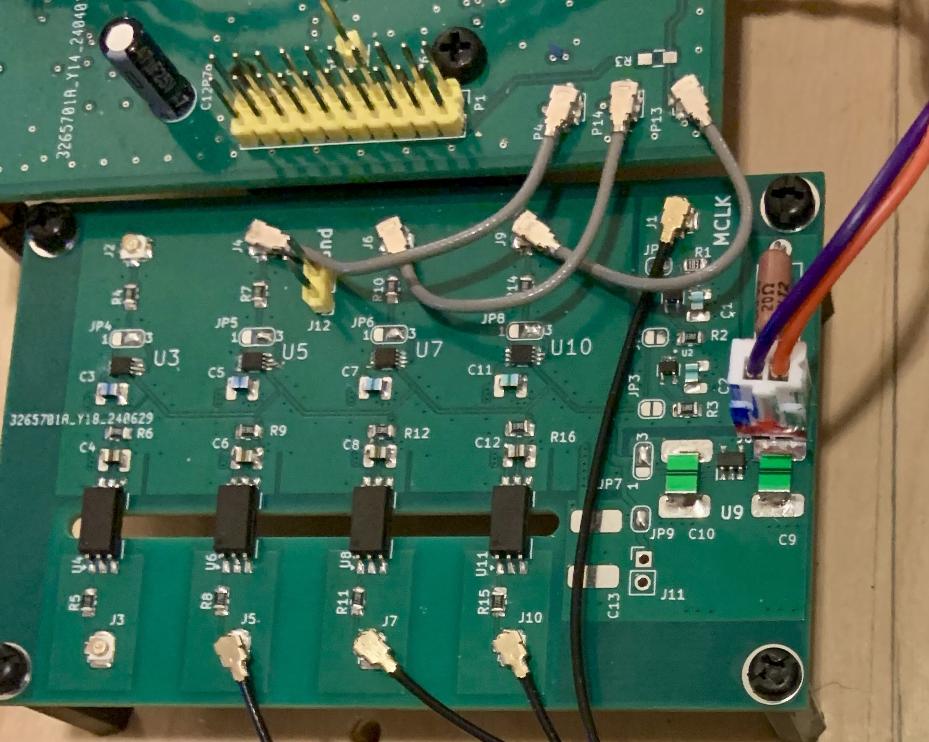

Reclocker board is up and running since overnight. Sounds better than the old one:
NOTE:
One thing is starting to become apparent when using the boards of this thread to their utmost with a very high performance dac such as, for example, MarcelvdG's RTZ DSD dac. It is that under some conditions some audible crosstalk effects can occur when two clocks are installed and if all the clock signals running around the clock board are active. In the case when 22/24MHz clocks are used then its possible to disable (or never populate) most of the circuitry on the clock board, and thus keep active circuitry to a minimum. In that case most of the solder jumpers on the board can be left open, except for JP8 which should jumpered pin 2 to pin3, and except for JP9 which can be jumpered pin 1 to pin2.
The switched clock signals will then be available on J12, J13. One of those two connectors should have a u.fl cable running to the input of the PLL (J24). The other u.fl connector of J12, J13 should go to the Reclocker Board MCLK input.
This seems to work pretty well with Iancanada clocks or lessor. For sine wave clocks with squaring circuits, perhaps better to PM me for more detailed discussion.
Also, if some of the solder jumpers are left open then depending on how the clock board is populated, some CMOS inputs may be left floating. In that case a 10k resistor can be soldered to one of the open solder jumper pads and the other end of the resistor connected to ground to anchor the CMOS inputs safely.
