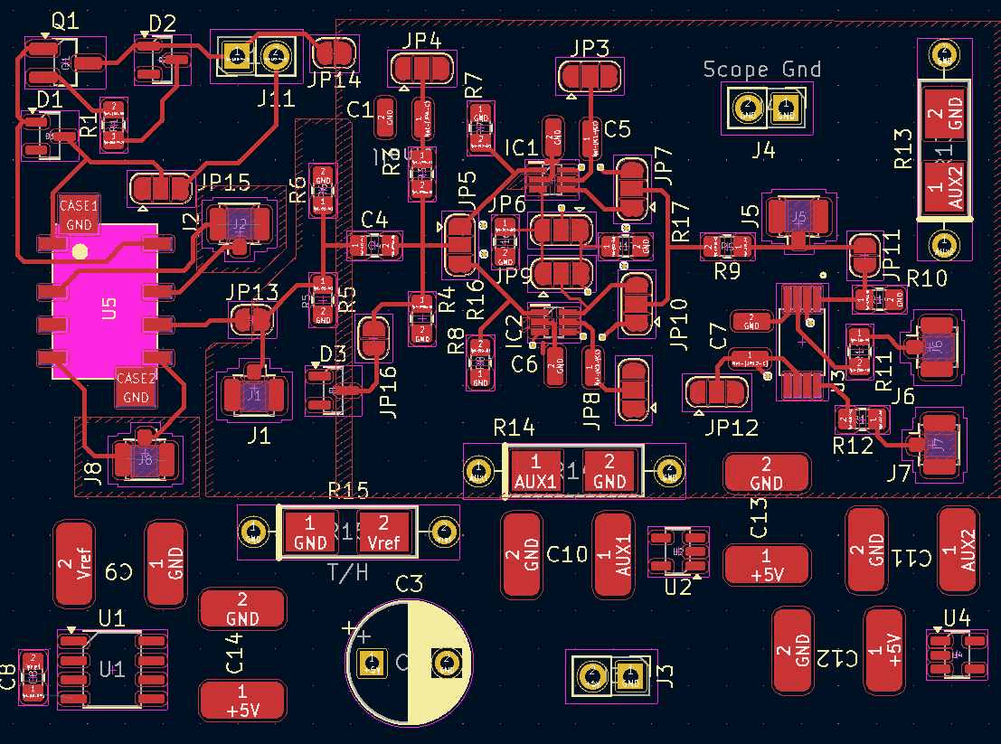

Started looking into the squarer problem for those folks who use sine wave oscillators rather than clock modules. Turns out AD has declared LTC6957-3 EOL. Another common circuit uses 74AC11004, but not sure that's the best alternative. Decided to take a look at how much is actually needed to get get good audio dac performance out of SOA audio oscillators. To that end, an experimenter board is in the works to try different topologies and or devices. Probably a few more days of work before Gerbers are ready for a test board.
Rough idea so far:
Rough idea so far:
You are under full steam Mark 😎 - it would be nice to have a comparison between the sinePI of Ian and the squarer boards from Andrea…
Doede,
I have all three types of squaring boards you mention. Already modified the Andrea squarer boards with some improvement in subjective SQ. IMHO removing all the ferrites helped the most with one. The other had crosstalk issues and might have been worth fixing but the key parts are EOL. Don't recall if I listened to sine_Pi or only looked with a scope. Decided I thought it might be possible to do a little better. Problem is I don't know exactly what I want to do in this case so I decided to make a board to run some tests, and then see what I can find out from that.

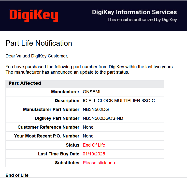

Just got an EOL notice on the PLL I used for the clock board:
Thus if anyone is thinking of possibly building the clock board of this thread some day and would rather not design in a new PLL, maybe good to grab one or two before next year. Also, looks like all the recommended substitutes are already obsolete or last time buy, which could further complicate things.

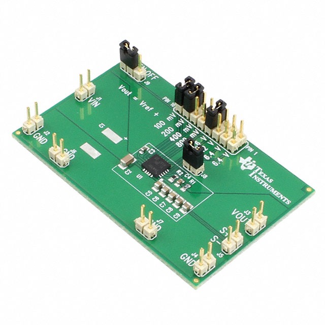

Mark, as you also use the LT1763 in your design, I thought it might be ok to post a link to my new blog post on the use of larger bypass caps.
https://blog.dddac.com/dddac1794-mk3-on-board-regulator/
Doede,
Noise bypass cap here is whatever they spec but in C0G. Slowing down the regulator loop may reduce noise, but it may also reduce PSRR. Depends what's needed most, I guess.
Since there is more to the power distribution system than just the regulator bandwidth, and to fill in a little more detail, I have mostly been using a 10uf SMD film output cap for LT1763. Along with a load adjustment resistor, of course 🙂
A lot may also depend on choice of smaller distributed bypass caps along with use of ground and power planes.
Seems to work pretty well although I have not had time to study it in particular detail. Too many other things to do. Squaring circuit test boards will be here soon as well.
I assume you refer to TPS7A47. That datasheet does not recommend 5x 10uF X7R/X5R but states that recommended output capacitance is 50uF and it also recommends to apply 50% derating on nominal capacitance of ceramic capacitors. So 50uF would require 10x 10uF X7R/X5R.TPS4A7 series benefit more from 47uf low esr tantalum and 0.1uf c0g (preferably rubycon mu), rather than five 10uf x7r/x5r it is recommended in datasheet.
Yes, just swapped typo. Indeed they don't specify, indeed 50uf, x7r/x5r. BUT in their evaluation board, they chose it as a means to lower esr, and layout it as 5x10uf. Even with 50% derate, capacitance drops significantly.

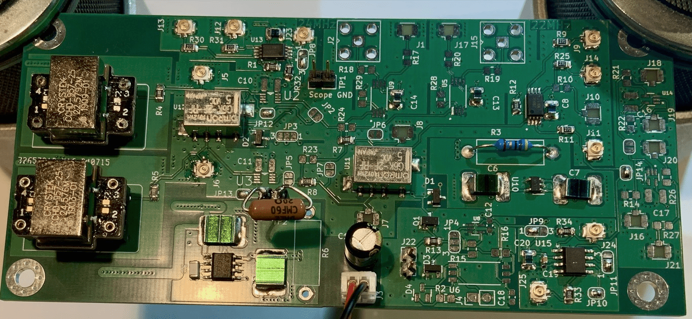

Example of a rather minimally populated clock board:
This one has been settling in overnight. It will be used for testing with the experimental sine wave oscillator squaring boards. Bare boards are expected to arrive later today. Will hopefully know more in a few days.
