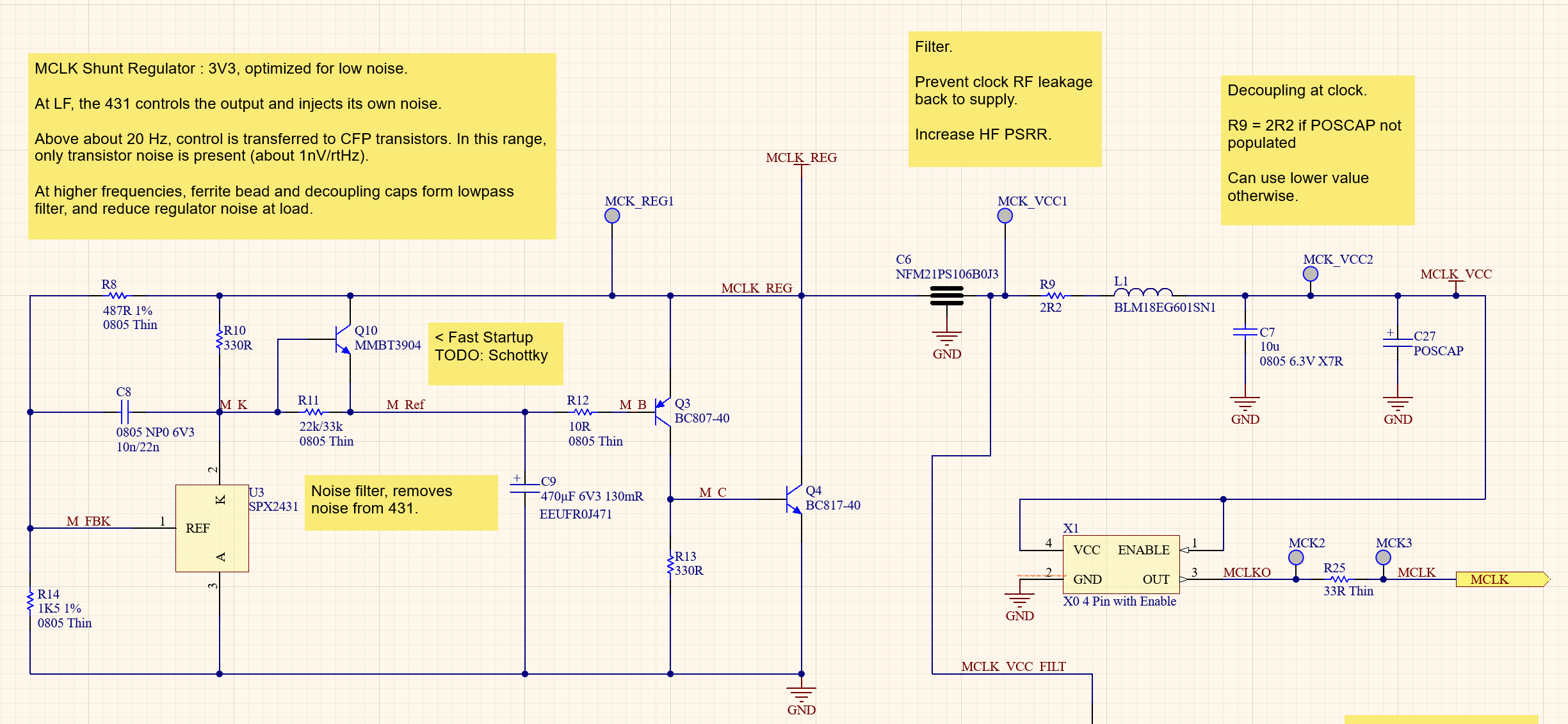

Ringing needs inductance but with small package and short trace lengths inductances can be kept small. At these clock frequencies (i.e. above self-resonant frequency) acrylic caps do next to nothing and just take up PCB space. The internal decoupling capacitors of larger clock oscillators are typically ceramic (even class II) so the benefits of external non-ceramic decoupling capacitors are slim. Probably better not to use external decoupling capacitors for those oscillators as trace lengths (and inductance) can become excessive. But decoupling capacitors are used not only on clock oscillators but also on ICs where such issues can be mitigated with proper layout.
Here are some pictures showing what larger package oscillators contain:

There is capacitance between the PCB surface fill, the ground plane underneath, and the power plane. It doesn't have be lumped where you think it does if the layout supports doing it another way in a particular design case. ThorstenL has already talked about some those concepts in another thread. The bottom line is that the clock board works, and it works quite well for its intended purpose.

My approach is quite different as I have clock buffers on my USB-I2S, ADC and PCM2DSD boards and reclocking on DAC boards (where needed). They all accept external clocks if needed. I have a separate clock board if I need to override the onboard clocks. That has similar power supply as this: https://www.diyaudio.com/community/attachments/final-mclk-reg-png.950839/

The optimum bypass capacitor value/type thing with clock oscillators has been going on for years. I could post pics of clock adapters made by Twisted Pear, Iancanada, etc., that can accept various kinds of bypass caps for experimental optimization. IME they all sound like crap (and most of the voltage regulators didn't sound too good either but that's a different topic). The unpublished work I did with different bypass caps for clocks and buffers started out exactly according to textbook dogma. However, something appears to be going on that is not well explained by the most common engineering models. Moving away in increments from textbook caps to .22uf MU caps shows a clear improvement in multiple dimensions of music reproduction (e.g. soundstage depth, vocal dynamics, etc.). However, things are not even that simple. MU caps take time to stabilize -- less than a day for most of the settling to occur under actual operating conditions. The sound goes through some interesting phases as the caps settle in over a few or several hours (say, overnight). From a scientific perspective I would very much like to know exactly what is going on inside the caps during that period of time. From a practical engineering perspective, there is no need to keep repeating the same experiments over and over, expecting a different result. Thus no need to keep trying small ceramic caps. Its been done enough times already. IMHO, same thing with ferrites and clocking for audio reproduction (whether or not the problem for audio is exactly due to "encagement"). All the above having been said, if somebody has new idea to try that might work better than MU caps, then I will be more than happy to listen to their version of the clock board.

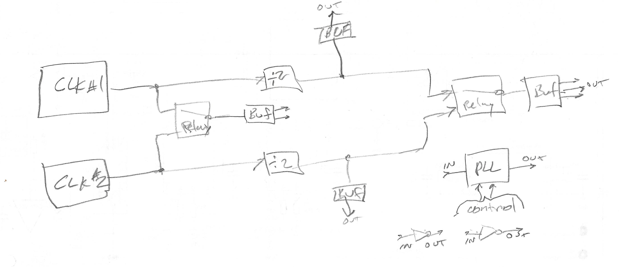

New version of Clock Board with PLL is in process at JLCPCB. Thought I might take a moment to show a simple block diagram of what the board does:
In case it wasn't clear before that's the pretty much the basic idea. Start with a couple of clocks (originally 45/49MHz). The USB board controls the relays that switch clock frequencies, and so on. The details of adapting the board to also work with 22/24MHz (or even 11/12MHz) clocks complicates things a bit. There is now also a PLL to multiply clock frequencies as needed, and there are a couple of spare inverters for other contingencies.

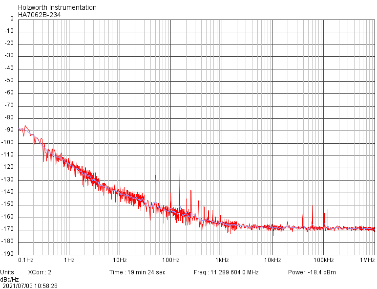

Looks to me like you misunderstand what we are interested in. Are saying that nonvna is a State Of the Art instrument (SOA) that is as good or better than anything Microchip, Holzworth, HP, Keysight, Tek, etc., has ever made or knows how to make?
The reason I ask is that some of the clocks we use are SOA ultra-low phase-noise. There are few instruments made in the world that can accurately measure the clocks, and the instruments cost over $10k each. Some people have spent $50k on a rack full of instruments to measure such clocks.
So you see, it would be silly to believe a $100 instrument could be good enough to measure the clocks as accurately as we want. Especially so if using a PLL for a reference, because PLLs are notoriously jittery. It makes no sense at all.
Besides, its not clear if nonvna could produce a measurement anything at all like this even for a very poor clock:
Do you even understand what this graph shows?

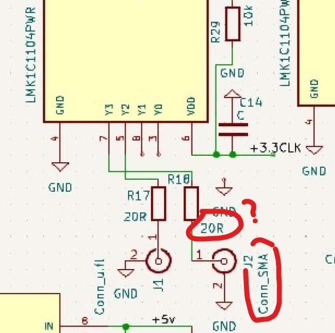

Mark another question, why is this 20 Ohm resistor in series with the SMA output. The Clock buffer IC has already 50 Ohm output impedance and would like to see a 50 ohm PCB-trace? What do I miss or what was the purpose of it?

The 20R resistors were experimental at one point. LMK1C1104PWR has a rated output impedance of 50R, which is higher than most other buffers and CMOS devices. In theory it would be a match to a 50-ohm transmission line with a 0R series damping resistor. I tried to explain about series damping resistor values in the Clock Board Notes file I posted a few posts down after posting the KiCad files. They can affect dac sound. Sometimes higher resistor values than theoretical matching would suggest, end up sounding better in dacs. For that reason some people use 100R as a standard series damping value in dacs. Possibly that's because more resistance reduces risetime a little and thus may reduce some very high frequency RF harmonics from coupling noise into other circuitry, or maybe reducing coupling of RF noise through a dac chip's substrate.

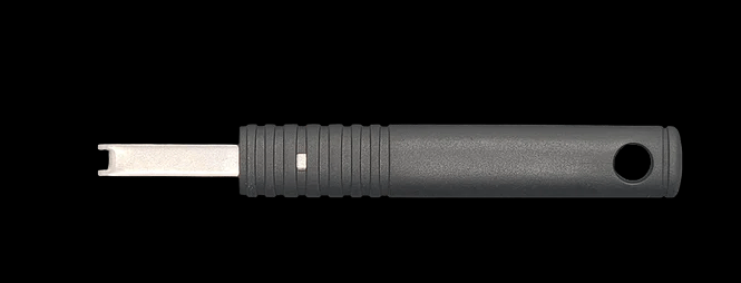

BTW, found a new u.fl tool which in principle works similar to the Sparkfun tool, but IMHO is overall better (a better fit to the u.fl connector, and a better handle):
https://rfsuperstore.com/products/u-fl-insertion-extraction-hand-tool

It I am going to measure the output of my board, it can only be done with the same equipment used to measure the SOA clocks (given that buffer close-in phase noise should be about as good as SOA clocks). I could send a board to someone with the necessary equipment if I thought it necessary.
OTOH, a device that is primarily spec'ed for comparing the frequency two clocks is useless. One clock needs to be at least 10 times better than the other clock so the better clock can act as a reference. If both clocks are SOA, or if they are otherwise about the same, there is no way to tell which one is right and which one is wrong. You only see a difference. A PLL-based measurement would also be useless.
In addition, I looked at nonvna website and saw nothing about using it for close-in phase noise measurements at all. It was spec'ed for frequency comparison of two clocks, and for phase mesurments of two clocks of the EXACT same frequency. Well, audio clocks don't have to be the exact right frequency. They don't necessarily need to have terrific Allen Deviation either. But IMHO they do need to have very low close-in phase noise for best results.
