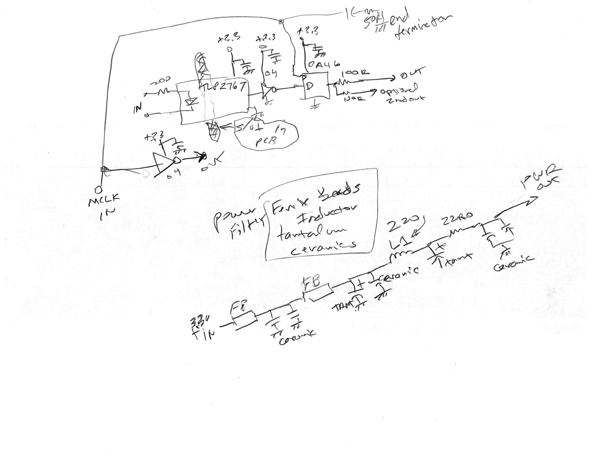

Since we are on the subject of reclocking, I made a quick visual sketch of the circuitry on the reclocker board I am using for now with Marcel's dac (the 50R end termination has been disconnected).
The sketch shows one reclocker channel, and some circuitry shared by all channels. In particular there are a number of ceramic caps, ferrite beads, and an inductor in the incoming power filter. There are also ceramic caps used for channel circuitry bypass needs.
The use of ceramic caps and or ferrites is in contrast to what I did in the clock board, and in contrast to the bypassing in my best dac. Looks like ThorstenL also used some SMD film caps for the DSD dac he designed for iFi (there is a pic of the board in the Marcel DSD FIRDAC thread).
In consideration of the above, I would probably not use this particular reclocker circuitry if I wanted to try to get the best possible reclocking. Most of it looks okay, except for the items mentioned above. IIUC this reclocker board is an older design that was used with some earlier IC dac. I got a couple of the reclocker boards mainly to try with the Acko version of Marcel's DAC I had here previously. Anyway thinking about it a little more now, maybe there would be some justification for designing a new reclocker board. Don't know if I want to be the volunteer though.

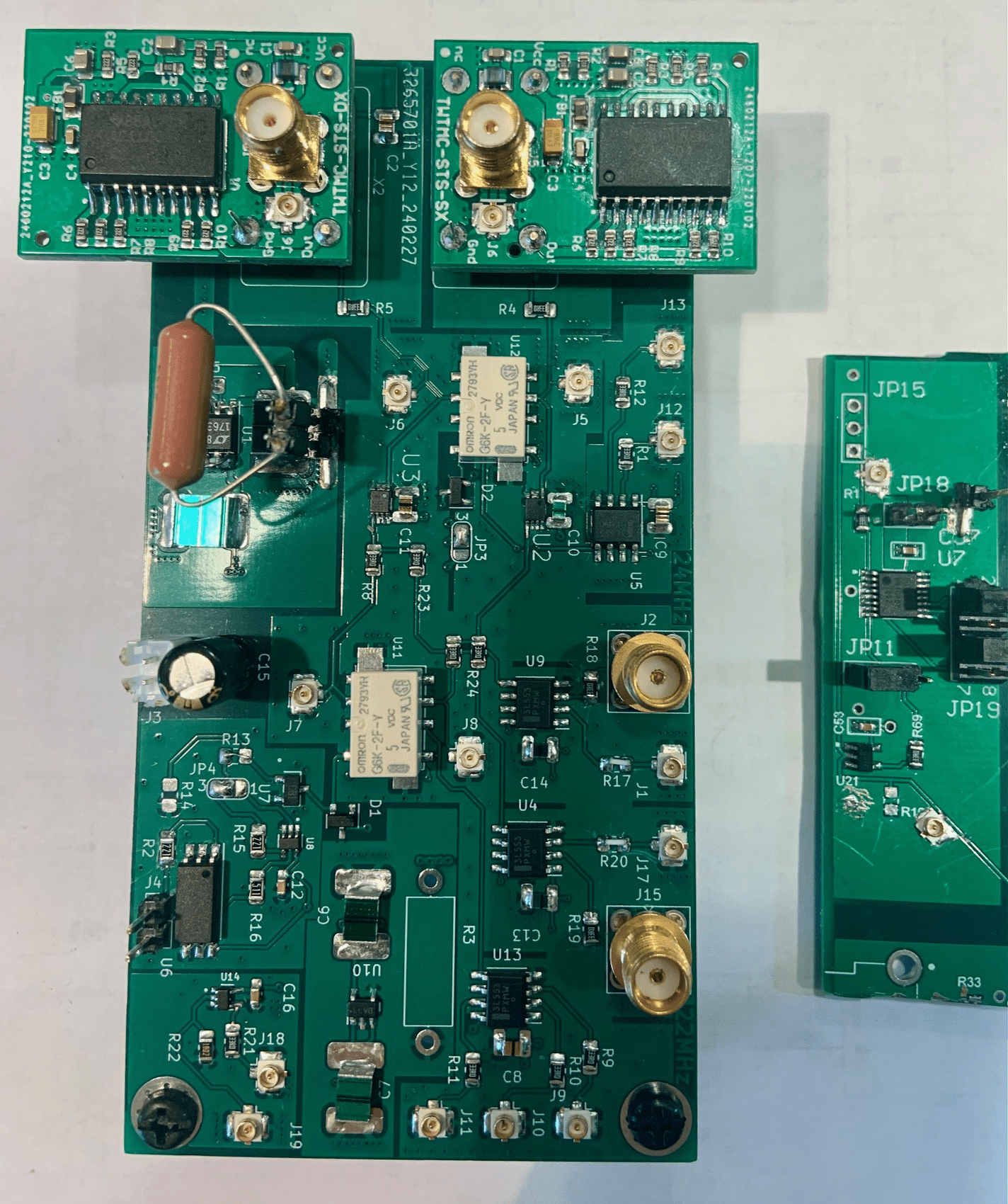

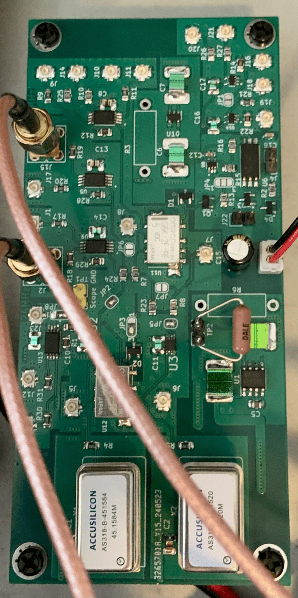

A couple of updates. First, version 2 prototype clock boards are on their way from jlcpcb. ETA is Thursday.
Second thing is just did a little experiment with the reclocker board presently used here with Marcel's dac. Bypassed most of the existing power filter and added a 10uf Rubycon SMD film cap at the filter output. Sound of the audio has definitely changed. A lot of the remaining little bit of HF fuzzzz that was evident in the dac sound is replaced by what sounds smoother and not so fuzzy, maybe like a little more signal correlated 1/f noise. Some of that apparent noise is probably from taking down the dac for a couple hours which let the clocks cool off. That particular part of noise seems to be receding as the dac runs for a few hours after coming back up. The little bit of fuzziness hasn't come back through, not yet anyway.
Anyway, main thing is that existing power filter processing and bypass design of the reclocker board is affecting the dac sound, and doing so in a way that I don't believe can be right. Thus, looking more and more like a new reclocker design will be needed. Aside from power filtering and or bypass changes, maybe a few opportunities for alternate layout details could end up being helpful too. Have to try it and see.

Probably going to take a few days for the new board to fully settle in, so it will be running most hours of the day to get some time on it.
One interesting thing about LMK1C1104, the clock buffer chip used in this 2nd prototype version of the board, is that the datasheet says source series resistors can be used to match it to the load impedance being driven, but the output impedance of buffer itself is given as 50-ohms. Does seem like it might be driving the reclocker board a little better with no series damping resistor.
OTOH, the buffer used in the first prototype, NB3L553-D, seems to work clearly better with at least a minimal source series termination resistor.
Once the board is settled in, probably should do some scope measurements of the clock waveforms with different damping resistors. We'll see.
Also, there is a bit of a pop noise when and if clock frequencies are changed between songs. Using the mute signal going into the dac board may not fully accomplish an effective mute if the dac is operating in SE mode. That may be because when a mute occurs the dac output does not go to zero in the SE sense (Vref/2), rather it may go to ground.
Turns out even though LMK1C1104 has an output impedance of 50-ohms according to the datasheet, it doesn't appear to work all that well to dampen/terminate an otherwise unterminated line. With a 33-ohm source series resistor, the buffer seems to be working satisfactorily (haven't done a search to see if there is a more optimal value).
With that, I think this version of board will be fine for whatever little bit is left to do. Next up is to add a frequency multiplier.
Sometime after that I will take a look at what might be done for a reclocker board (since nobody else has volunteered, at least not yet).
Put together a couple squaring boards, plus salvaged an old frequency multiplier to run the next experiment:
However, will use the 2nd prototype clock board with the other buffer chips. Also, looks like the squarers include ferrite beads. I may try the boards with and without the ferrites to just to see if any noticeable difference.
