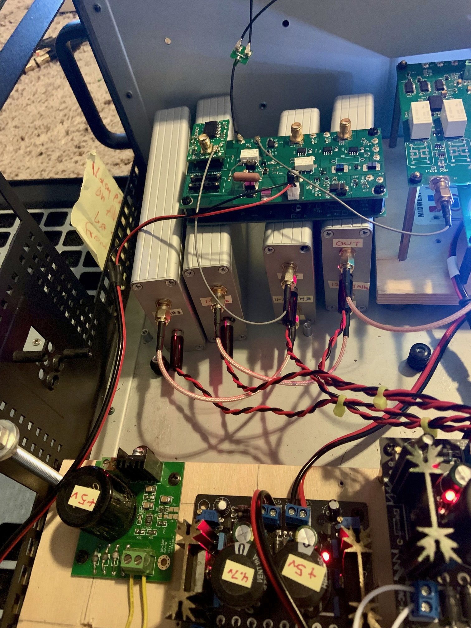

Just to give you an idea of one type of test setup for troubleshooting possible clocking problems, here is a test system in use:
The clock board is hosting a squarer, and is driving the FIFO board, while at the same time the clock board is the master clock source for the dual dac boards.

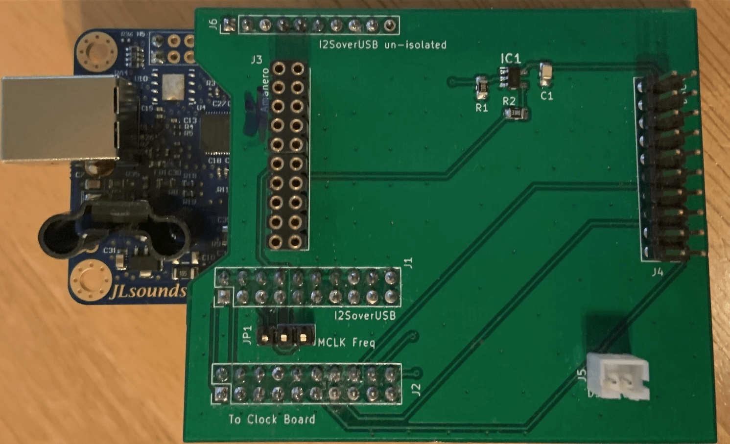

Also going to post the Adapter Board that connects PCM2DSD to I2SoverUSB, including u.fl connectors for attachment to clock board and reclocker.
Again, this is in as-is condition. It is not fully documented. There are some pics and notes in my dropbox: https://www.dropbox.com/scl/fo/22zuv9aa6vhhff8dofs59/h?rlkey=y6646ixee85tpmh8cel85y7y9&dl=0
Here is a pic of an earlier version of the adapter board showing how I2SoverUSB connects to the bottom side of the Adapter Board. PCM2DSD goes on top.
