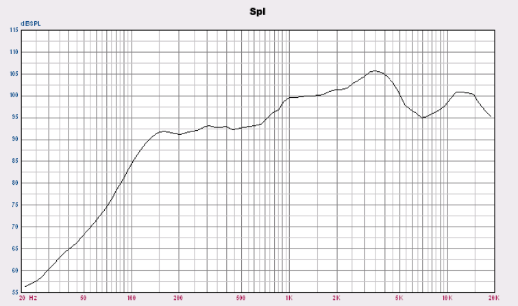

Some Lowther measurements: Preliminary Measurements of the Lowther DX Series of Drivers
And another one: free air so the usual caveats to such apply. DX55, 15ohm VC in silver

I would like to note, however, that most people do not like a flat response. A dead flat FR sounds rather lifeless and uninvolving. The most popular is a 6-12dB smiley face EQ. I personally prefer a 6dB bass boost, a 3dB BBC dip and 6dB boost above 10kHz. To each his own.
Here's another Lowther FR plot. This one is from Martin King's web site.
