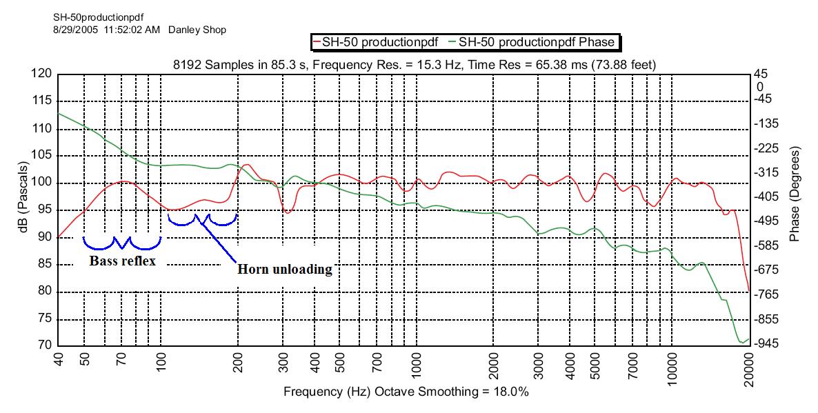

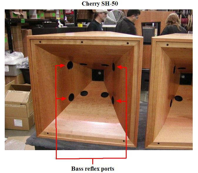

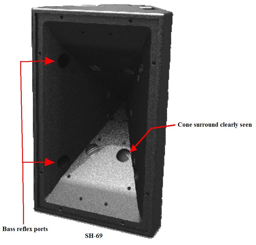

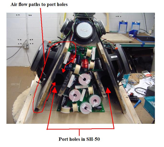

I see that Danley uses both tapped horn and sealed enclosure for the lowest pass band in similar designs (exampels: SH50 and SH25).
Actually, when I examined the SH-50 and SH-46 it looked like they used bass reflex to get the last octave. The mouth is sized for Free Space and the bass reflex extends one octave below.
This is how I've been modeling my Synergy horns in Akabak. It works quite well to keep the size down while matching sensitivity. It also allows the flexibility of moving the bass reflex port around until it is in phase. My model has a mouth sized for Free Space at 167Hz, but the low end extends down to 85Hz.
Am I seeing things wrong? I think the SH-50 is a straight sealed 3-way, whereas the sh-69 is a bass reflex.
Patrick Bateman, what are your impressions summas vs unity, when listening from another room or walking around house. Which would you prefer as all day listen speaker? I'm asking because I almost never listen on axis and only care about non fatiguing sound, speech intelligibility and dynamics, and occasionaly clean and loud spl 🙂
The SH-50, SH-46, SH-60 and SH-69 all use bass reflex. The SH-95 is sealed. That is why the SH-95 is rolled off around 200Hz.

Are you serious? I thought everyone here already knew about the bass reflex usage in the Synergy horns.

JLH'S picture of SH-50 and it's associated crossover could scare many a Nirvana and Fostex single-driver fan 😀
First really good larf today. Thanks Fred.JLH'S picture of SH-50 and it's associated crossover could scare many a Nirvana and Fostex single-driver fan 😀
